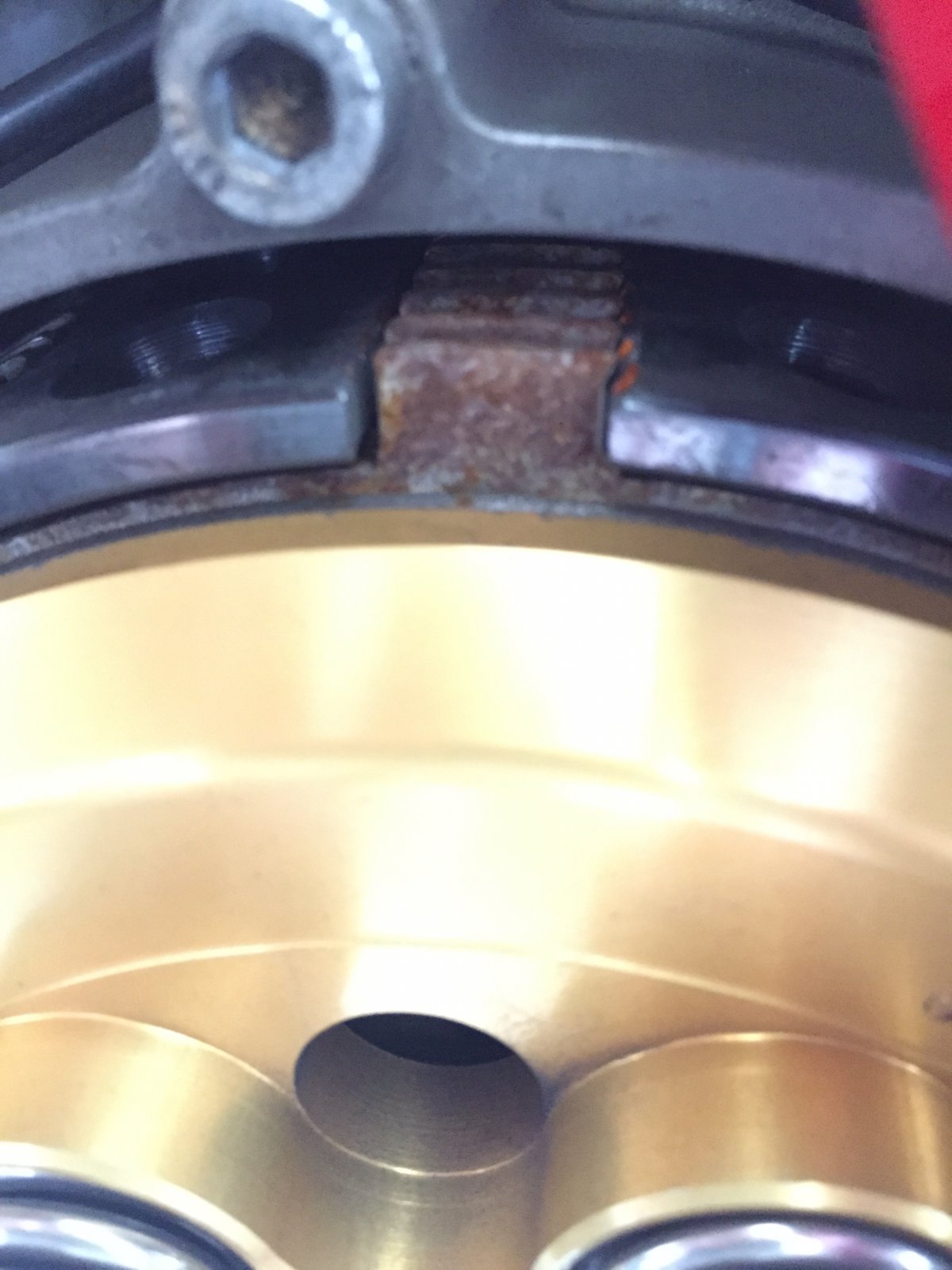

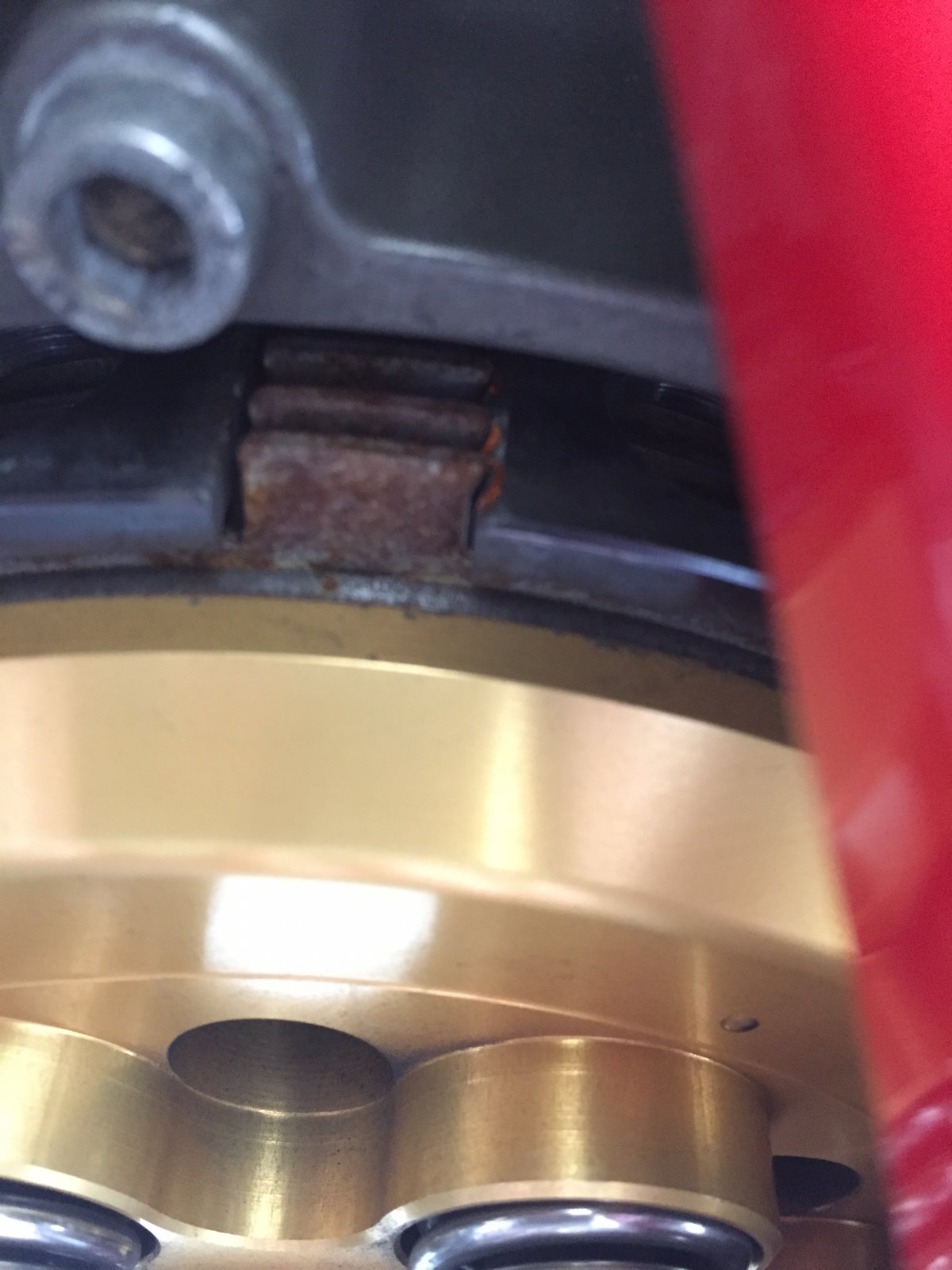

    In addition, when I got home I looked over the bike and saw that the clutch plates and basket may be worn. This is my first dry clutch bike, so I'm unsure about what constitutes normal or extreme wear etc. The basket tabs look notched where the plates are hitting it and the plate edges have a lip to them. Unsure if this is normal or not? Pics of the clutch attached.

    There is clearly some wear on your clutch plates, the best thing to do is to strip the clutch and check the tangs on both sets of plates are within suggested limits. Is the clutch bell steel or alloy? and do you have matching steel or alloy friction plates.
    Alloy plates in a steel hub and vice versa can cause more wear on the plates or the clutch outer.
  3. I was so busy concentrating on getting the thing out of traffic and home earlier that I didn't pay a great deal of attention to the difference in the noise the engine made, but now that @Red998 mentions it, it could well have been running on one cylinder very briefly. Would it make sense for the bike to do this as result of flooding if I had been trying to start it several times in a row before moving off?
    Re the clutch - I believe the parts are all standard with the exception of the pressure plate but can't be sure. It looks like they are probably both similar material as both are showing similar signs of wear.

    With regard to the clutch check the admissible wear and then see what your measurements are.

  7. both friction plates and drum are steel
  8. Clutch looks a little worn,but have seen a lot worse.Unless its giving you probs,I would ignore that.As for your misfire,I would do the cheap bits first.Plugs being No1 on the list.Good luck.
  9. Thanks for all the advice, have ordered plugs and will go from there. I'll leave the clutch just now as it is functioning fine.

    Clutch upon inspection is not as worn as it appears and is posing no problems so I will leave that until it requires replacing then may upgrade it for something swankier at that time. Thanks all for the suggestions and advice.
