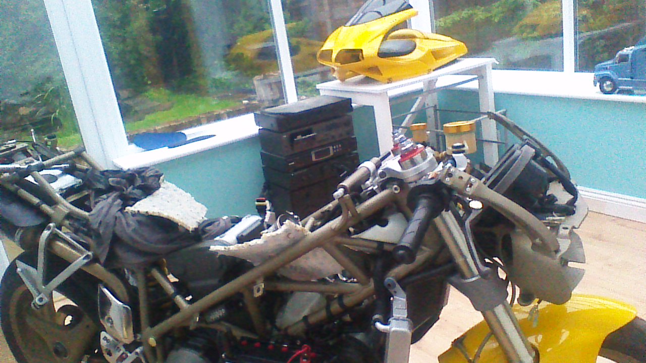

  8. naked bike
  9. Nice light garage
  10. dont know if its common with the 748 but i had an issue with my multy for about to years then finally gave up the ghost, it would spark when no load on the engine during starting ie plugs out but wouldn't start eventually it wouldnt spark when plugs out, but it would if bumped. new starter required for that fault.
  11. lol cheers its light and airy and has a lovely view of the garden lol
    I some times put the fountain on in the pond to calm me down when my ducati is not f**in startin lol
