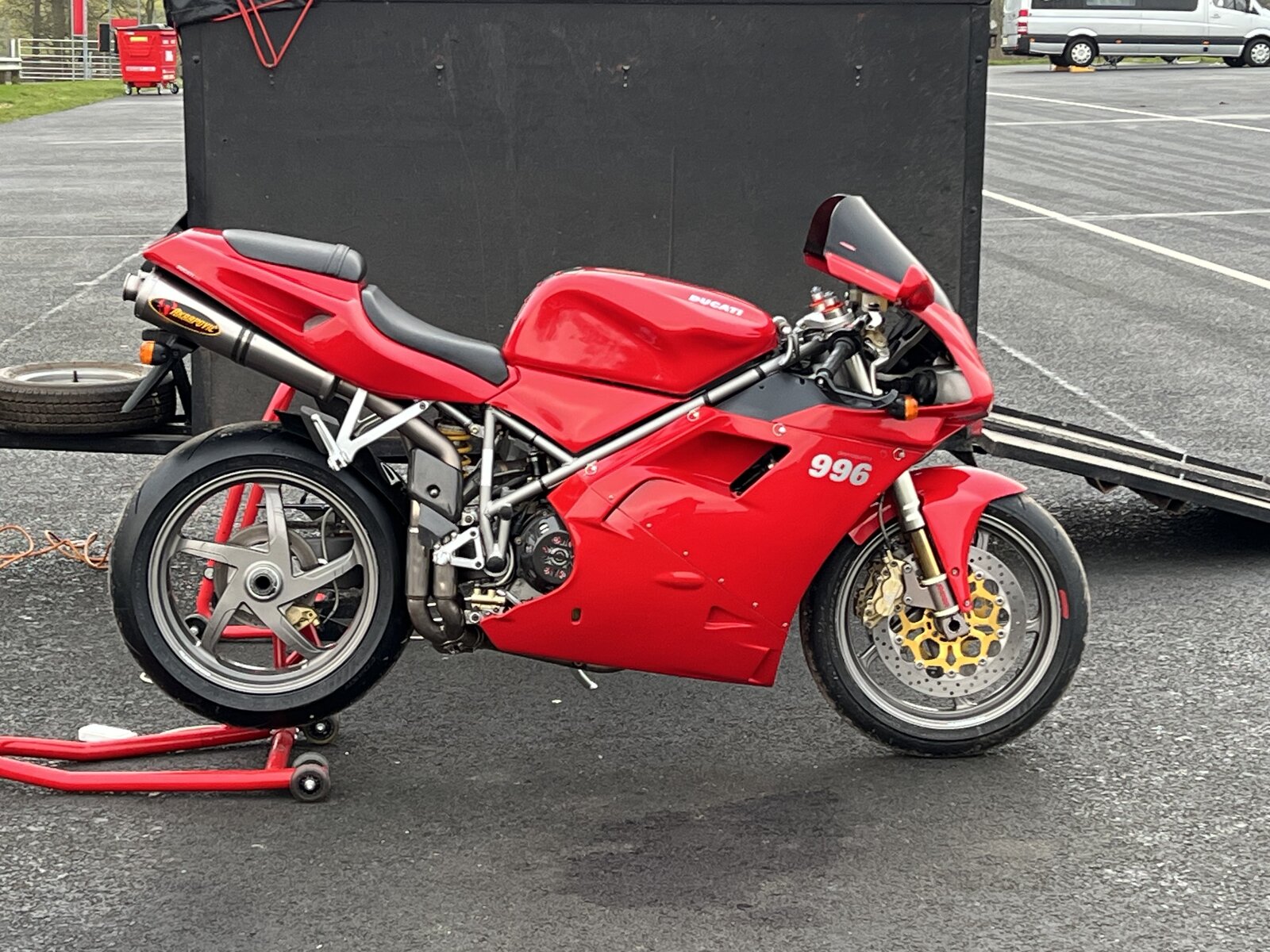

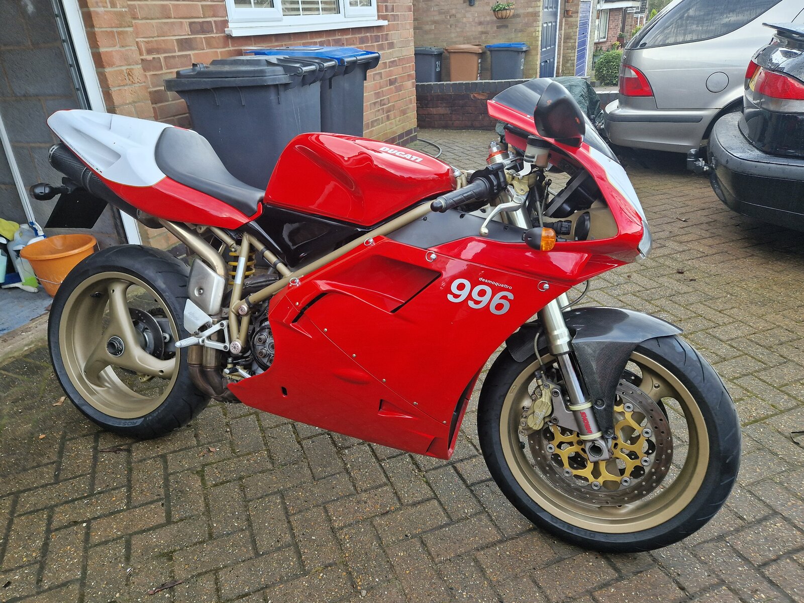

  1. Hi all, I am in the process of acquiring some OEM panels for my '99 996 badgers arse
    The aforementioned panels will require some attention and a respray, what is the correct colour decal for the tank/fairings?
    I have seen some gold, on what appear to be OEM panels, and some silver
    The frame is gold, the tank decal is silver, the aftermarket fairing decals are silver
    I am looking at keeping the mono seat, but, when having the whole bike painted, removing the number boards from the seat unit and the nose cone, as, I believe that they were not standard
    Bike in question....
    One panel already purchased, genuine OEM with silver decals
    Another panels just purchased, not delivered as yet.....
    Any help will be greatly appreciated

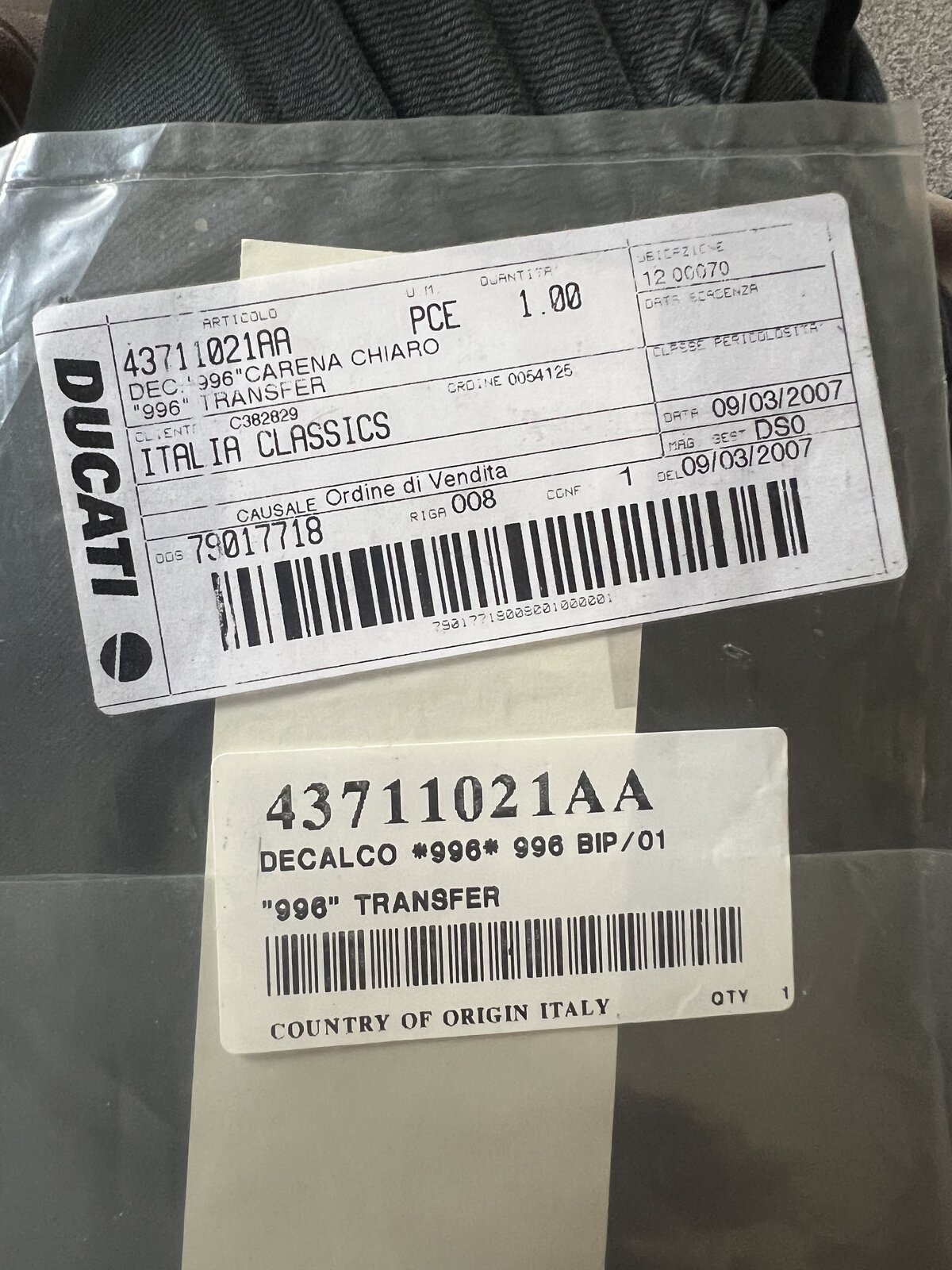

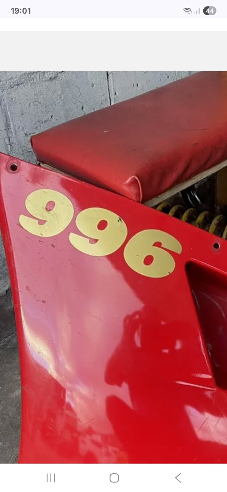

  2. I got this with mine when I bought it, I assume it is the correct one, mine is a 2001
  3. Stunning bike, I could understand the silver/silver, but, mine has a gold frame with silver tank decals

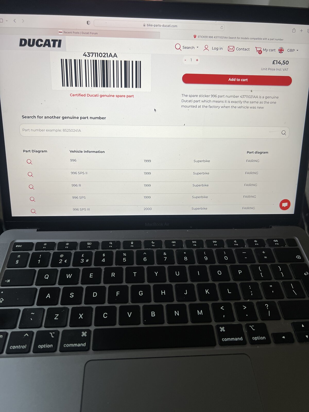

  4. just put that decal part number in google, it says it is for all 996 models, from Bip to R, for years 99-01, so appears they used the same with any frame colour
  5. Ducati still produce and sell the decals I believe. I've recently ordered a complete set for a 916SPS and virtually every decal was a different colour tone which to me suggests they order in batches from multiple suppliers based on demand. In the end I went to Image Works and got a set probably better quality than the original Ducati ones.

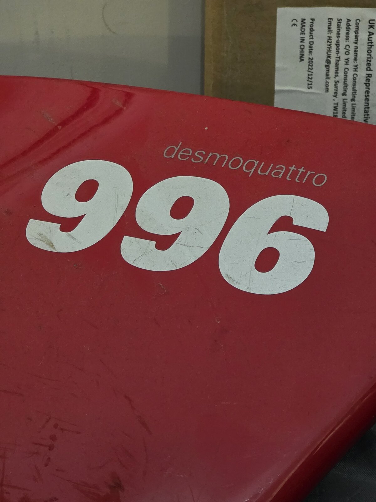

  6. Several places do spot on replica decals. Those decals in your first few photos are not original. The numbers are too big.
    All 996 decals should be silver for the red bikes.
    The decal on the panel you bought is correct, like the last photo of the bike on the stand

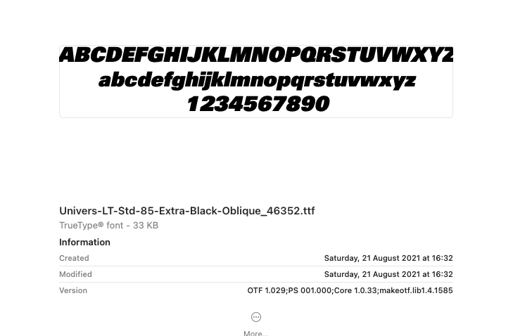

  7. This is the right font , any vinyl cutter can make the transfers, if you need sizes just ask I'll measure them on my 996, PM me and I'll supply the font.
    That is for the "996" and "DUCATI" on the tank
    "desmoquattro" same typeface. but "regular oblique" not Bold

    Just needed the info on the correct colour, as stated above, I have a genuine panel with desmoquattro 996 in silver, I have bought, but not received yet, another genuine panel, just with 996 in gold (as pictured on opening post), the panels on the bike (pictured in op) have desmoquattro 996 in silver, but, they are aftermarket panels
    So, to clarify, it should be desmoquattro 996 in silver, and just DUCATI 996 on the seat unit
    The mono seat unit currently has the DUCATI Campione Del Mondo Superbike decals on it

  13. Just to add to the confusion, the recently purchased panel arrived this morning, genuine Ducati panel, but with gold 996 logo
