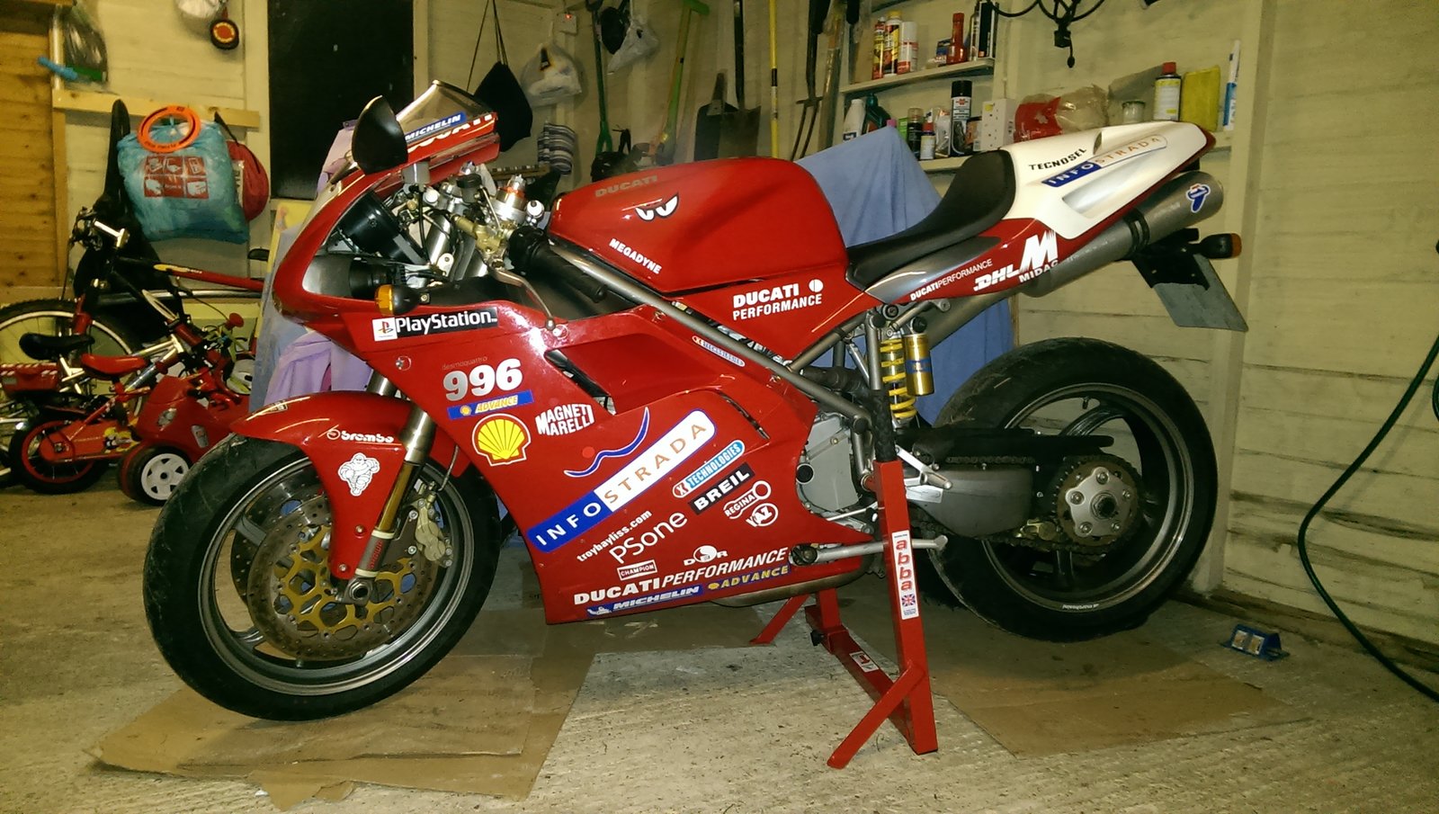

  16. CR does yours have a 50mm system on it?

  18. Ohlins rear is standard on the 996s, but not a Ohlins Steering damper or forks, as they are standard Showa Nitride coated,
    Exhaust is 50mm including the manifolds and not just the link pipe ( same as the 996sps) twin injector throttle bodies ( the source of poor running at low RPm due to P6 rather than the Twin pick up P8 Sps ECU.
    I had a 2000 996Bp and also a 2001 748E and the 996bp also had the adjustable headstock the 748E didn't, and you can check this simply by looking at the mounting point for the steering damper as it only has one fixation point on the frame and not 2 like all other models.
