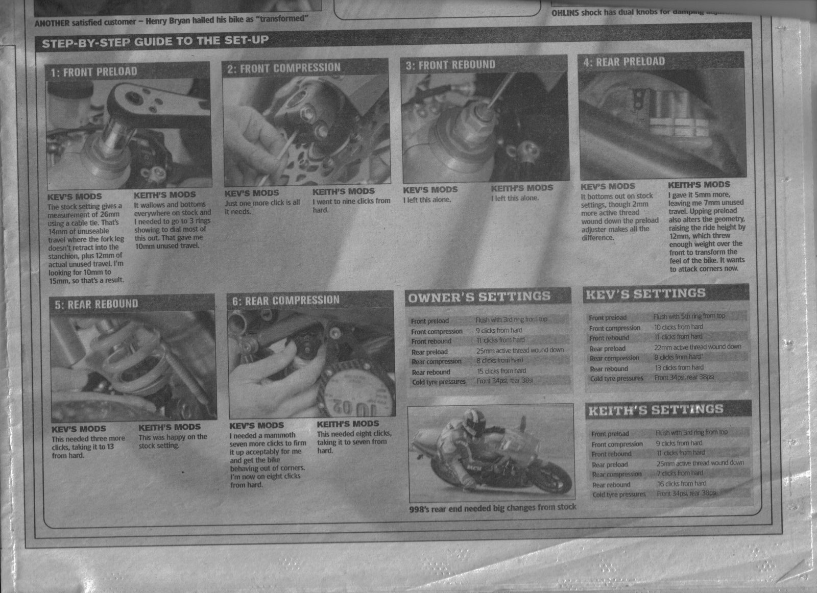

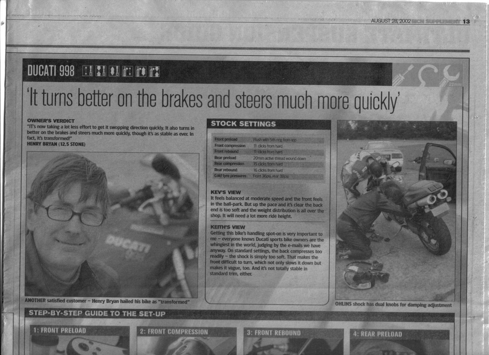

  7. Here is the MCN 1 page article for the suspension set-up on a 998. I don't know whether suspension set-up on a 996 is identical, but it's very similar.
    I hope this helps.
  8. Actually, i think that's it.
