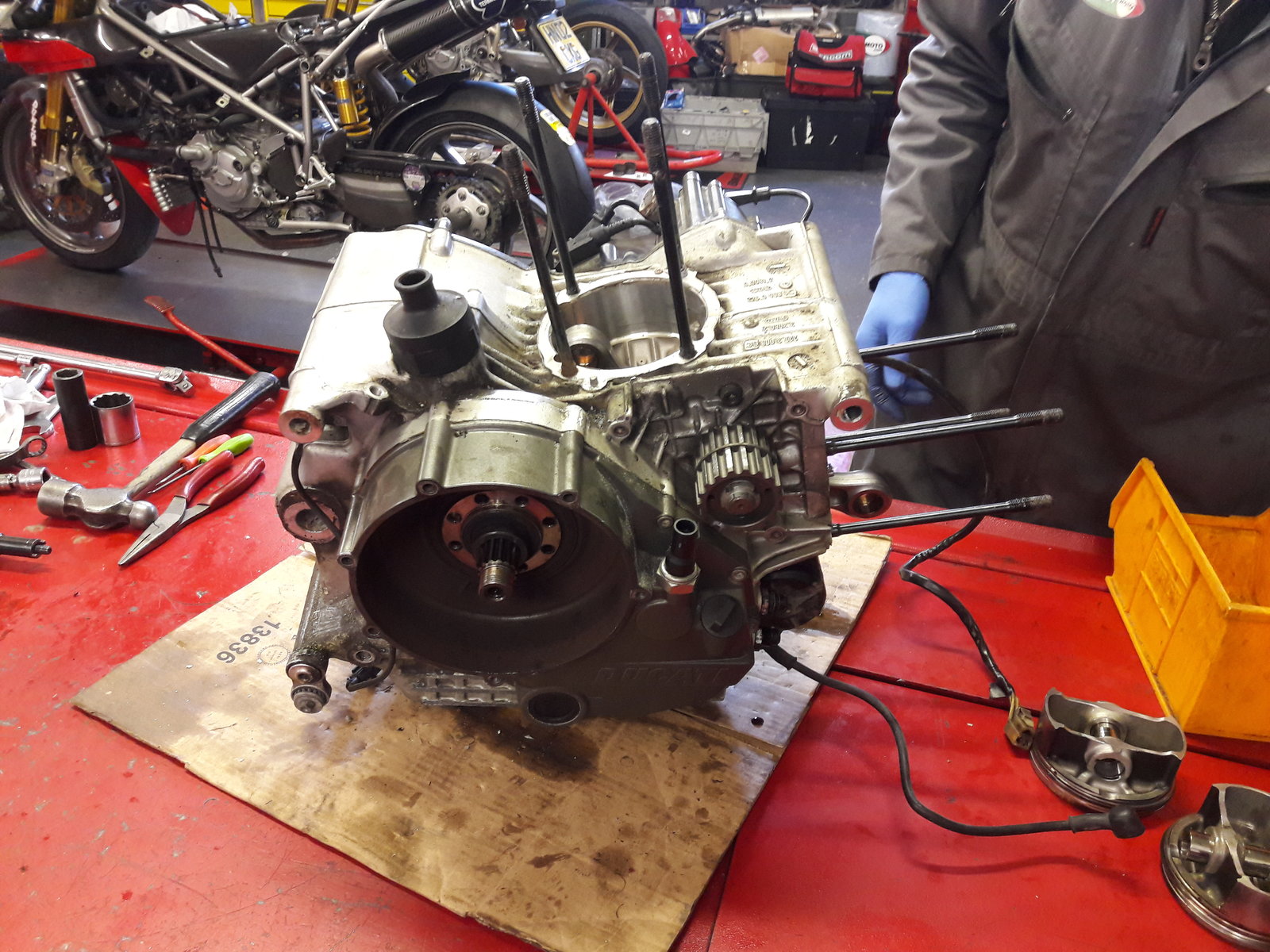

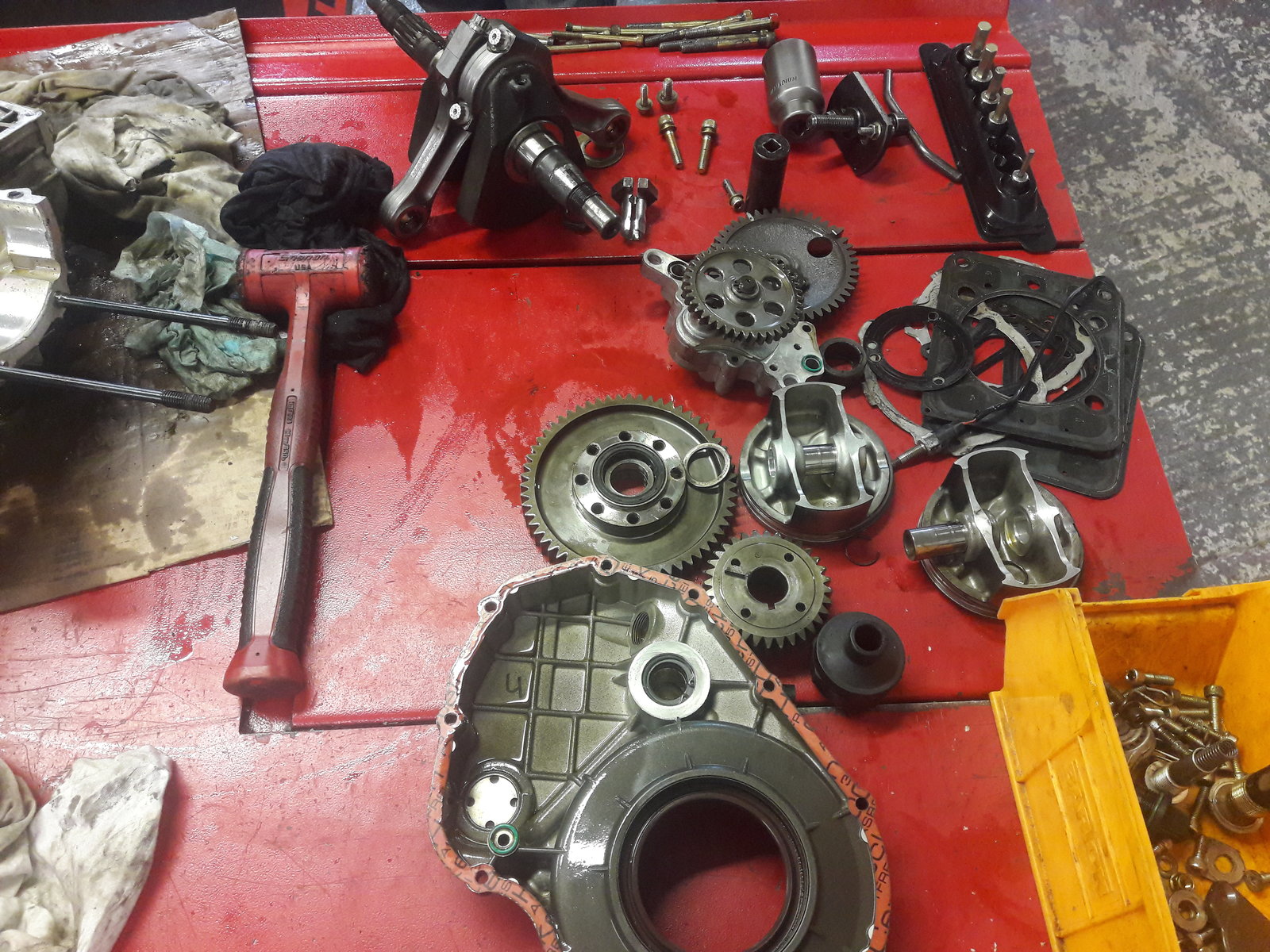

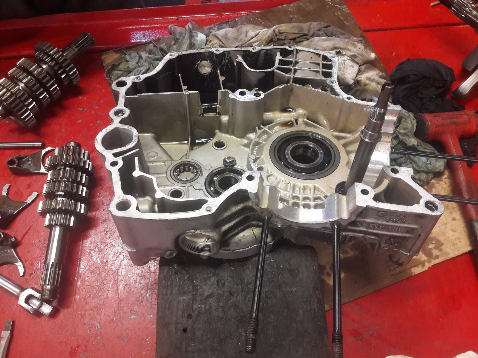

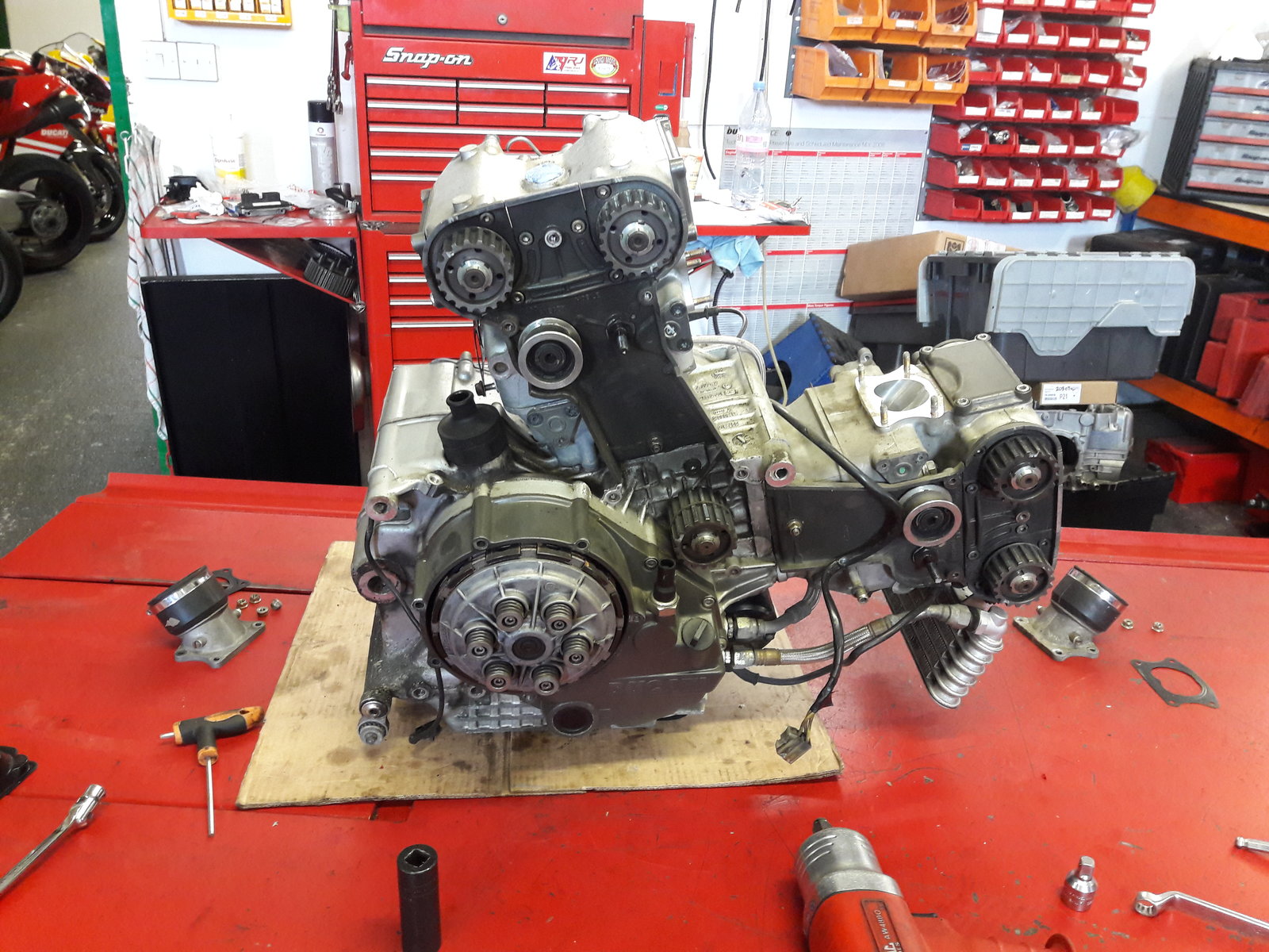

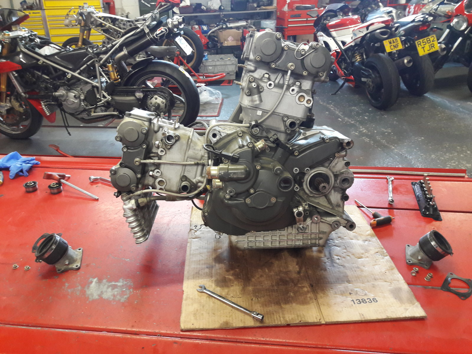

  1. Hi chaps as some of you know I bought a barn find sps in a bit of a state back in the summer with the intention of stripping it and rebuilding it to a nice useable condition with a bit of touring and a few track days in mind , it's a 2001 model with ohlins front and rear totally standard other than rear sets. Not got any pics of the bike yet but here's a start of the engine out at louigi motos going for a full blue print, super finished gearbox, crank and cams, balanced crank and rods, mild porting to the heads full set up and map when it's back together. Here's the pics....

    • Like Like x 23

  5. Liking the look of this thread already, would be interested to know the cost and power / usability advantage the engine work gives over what would be standard.
    Good luck with this,

  7. Looks interesting , more pictures please
  8. once im up the work shop il take some more of the bike in parts.

  13. Whats a super finished gearbox?

  17. The gears are tumbled with ceramic beads to take off all the sharp edges. Rich and Chris are 2 separate businesses that work next door to each other. Rich is the engine builder, Chris is the engine tuner. Andy

  18. cjs dont build engines anymore only the mapping, rich does everything pretty much, by adding the pistals it adds another £600 on the bill,when a head skim would do the same job but is it worth using the original ones as ive seen a couple that crack.
