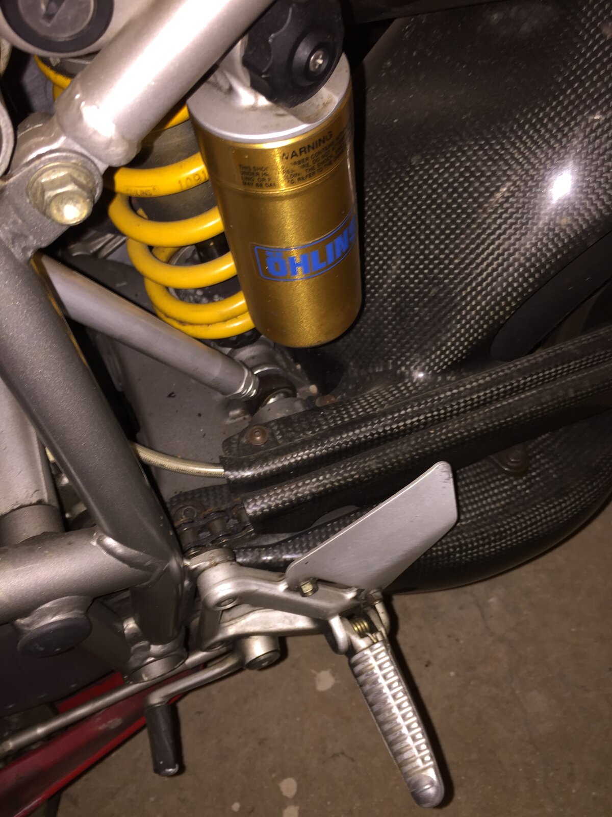

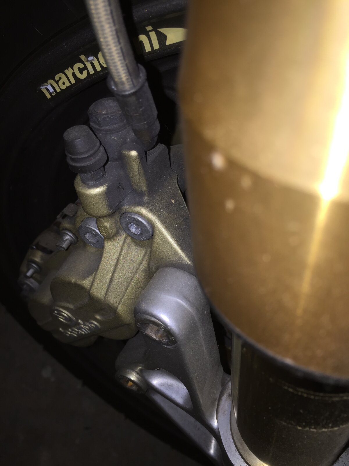

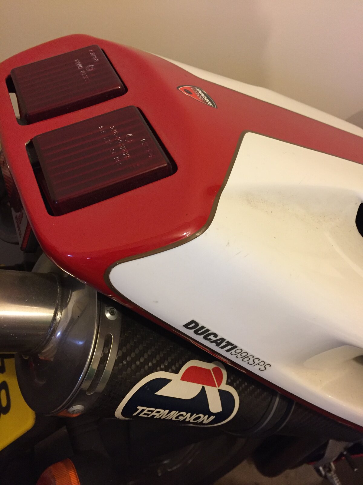

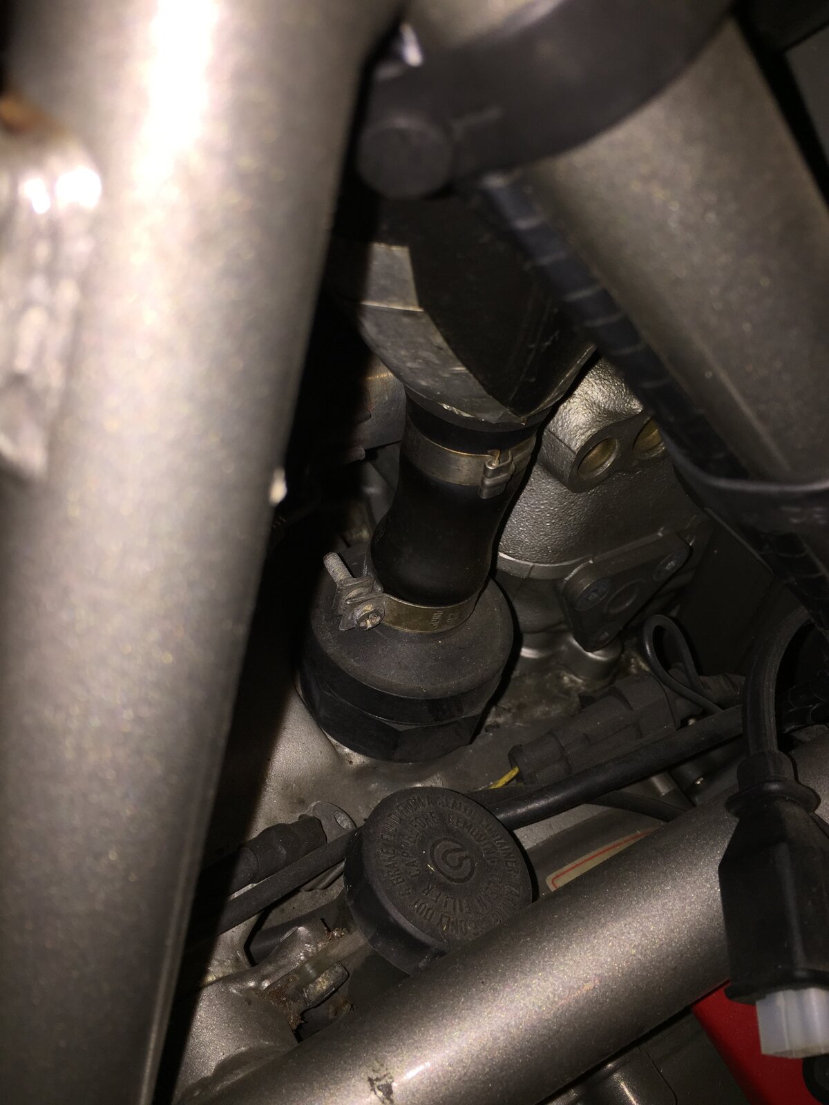

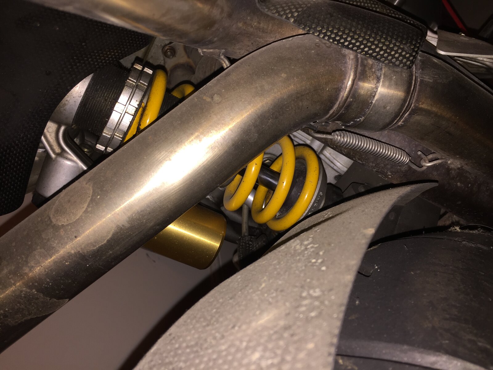

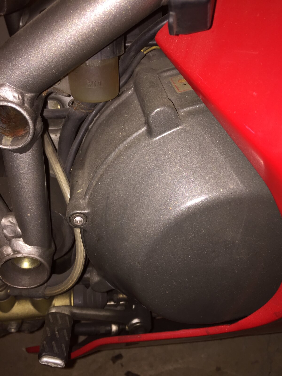

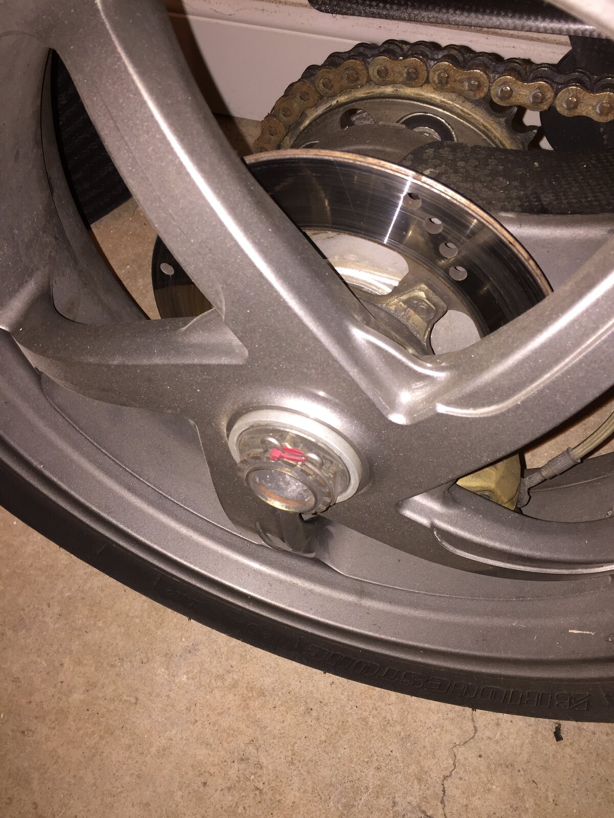

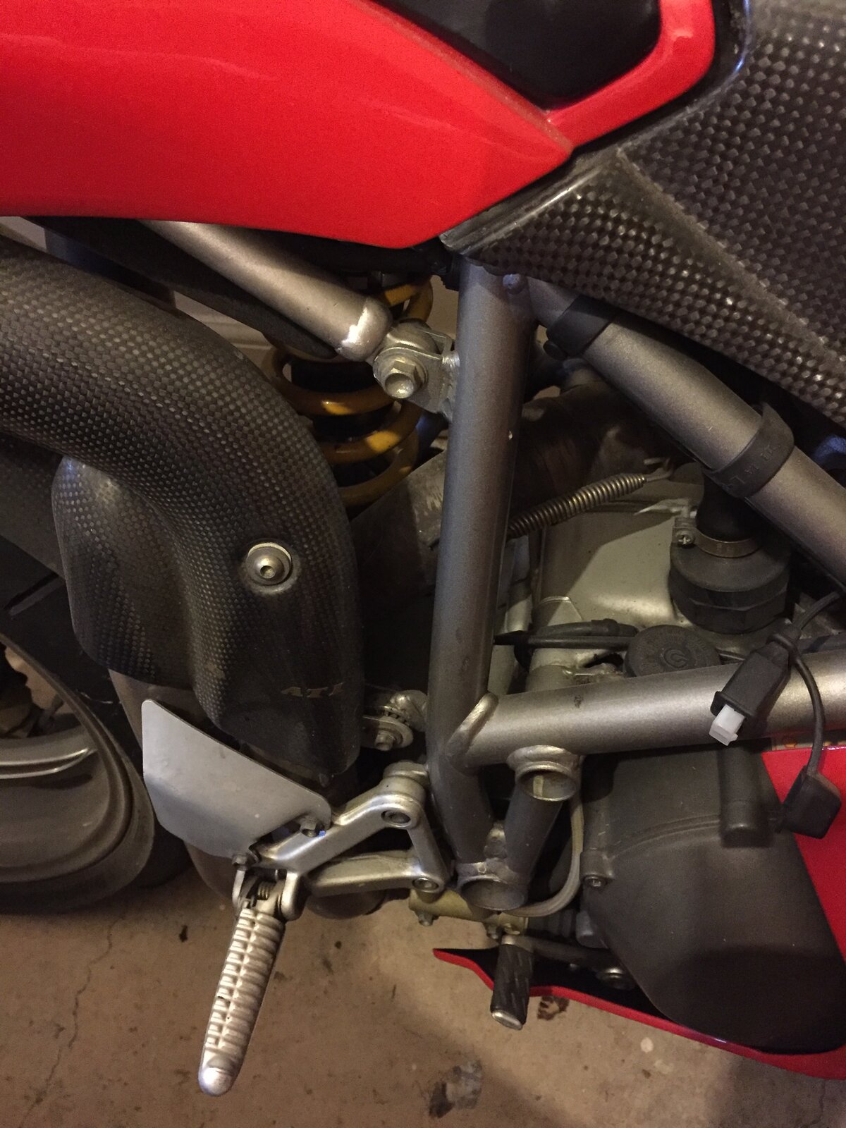

  18. Here are some pics of the bike that’s been in storage a good few years not the best pics but give you an idea of the new project I’m looking to be faced with!
  19. got some work ahead of you there, thats how my bike was when it turned up.
