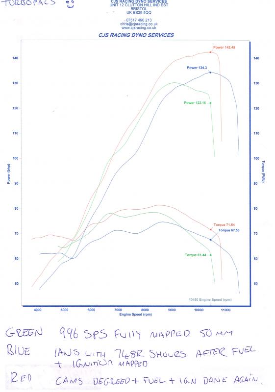

Forgot to ask, might be a trade secret:wink: Think its running 748R cams at the moment, but I have lost track
107/107 or 109/109 seems to be the popular choice from the standard setting of 119.5/107 for an SPS as been thinking of getting the dial gauges out this winter and giving it a go. However there is a lot more to it then just moving the cam timing about.

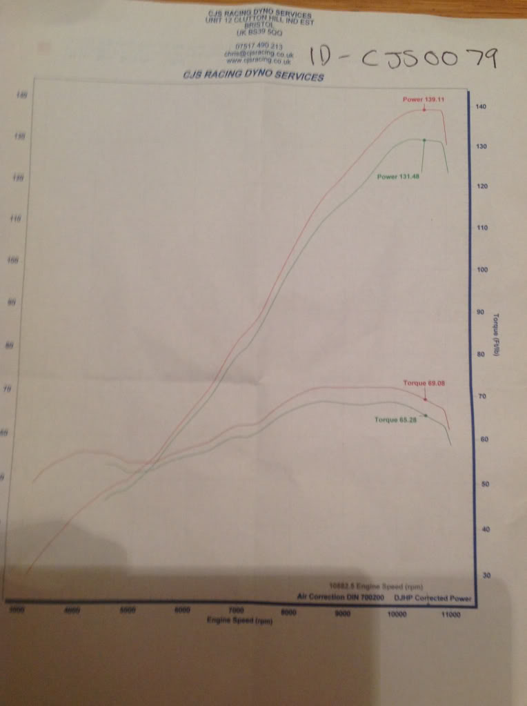

Green power looks similar to mine (124) but the torque values look a little "light" (mine's 73, with just 50mm and Ultimap). Probably due to different dyno/atmospherics etc. Red power looks well impressive! Have fun at Almeria - it'll be a hoot!
Yep, happy. Akros and a custom map, he flashed it to a DP one first as a base (so not as it was delivered by me, all std) then worked from there. Numbers are just numbers (as I'm sure some will point out ) but the ncrease is the ncrease either way
