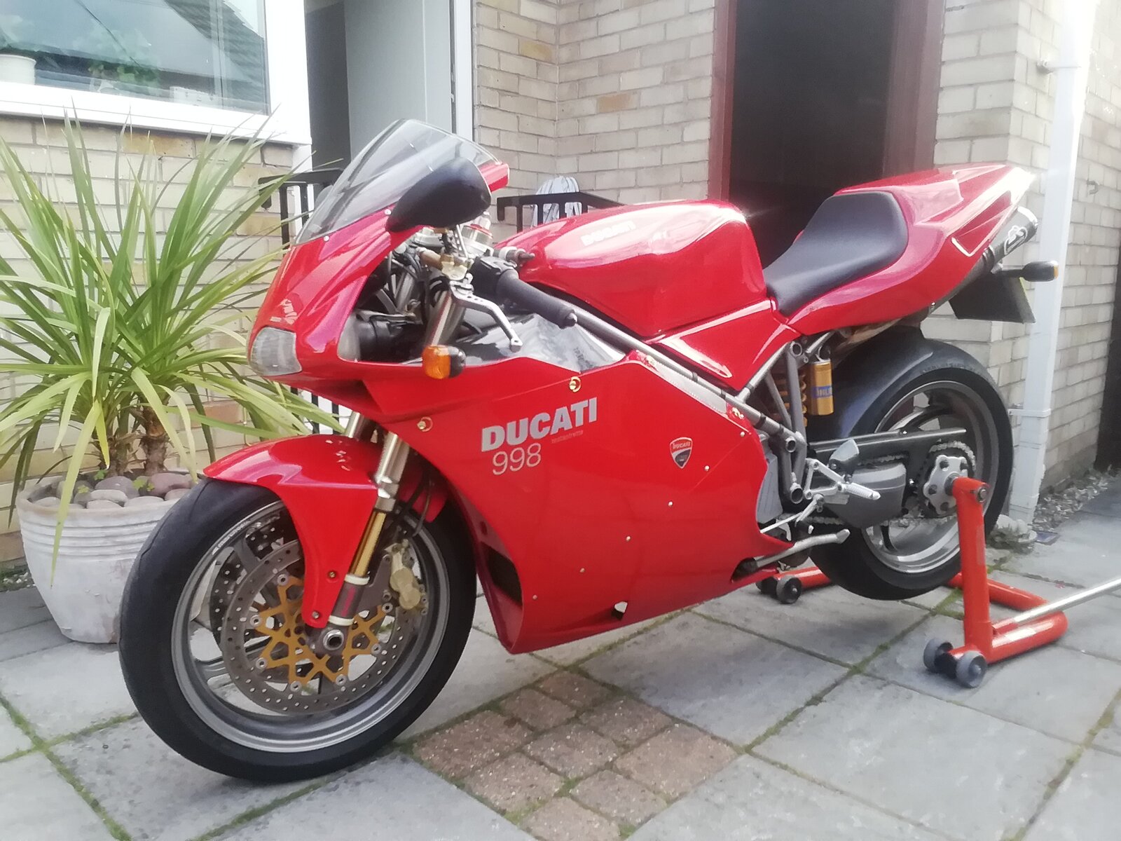

  1. This week I got round to changing the belts on my recently bought 998. I had done the oil and filter a couple of weeks ago and needn't have bothered as what came out was as clean and green as the fresh 300v that I put back in. But at least I know its right now. I went to a workshop in Stoke run by a couple of friends to use one of their benches and get some education on the belt change once I had stripped off any bits in the way. I was really glad of their help because none of the cam timing marks lined up how I expected. No matter how many times I turned the crank and lined up it's timing marks the dots on the cam wheels never lined up where they would have on a non testastretta head. A quick search on the Web turned up a video that helped by showing how to line up the camshaft bolts on the horizontal head and we marked the belts and cogs from there on in. But why don't the timing dots line up from the factory? Did they use cam wheels from the older engine with the new heads and couldn't be arsed to change the timing marks, or did we miss something.
    Anyway thanks to Ben and Sam at Motohub in Stoke for use of the bench, tools and moral support.
    The bike ran like a dream for 10 miles on the way home before remembering its a Ducati and died on a steep climb 5 miles from home. We had given her a couple of quick test rides and all was sweet but the o rings on the quick release fuel pipes had not taken well to being disturbed and had started to piss out a load of fuel making me think that maybe things are best left alone!

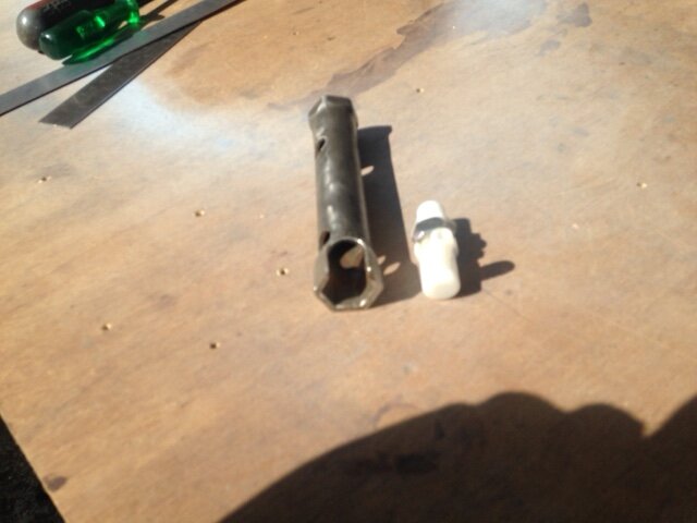

  11. When I replaced mine on the 996R with metal ones, I modded up a 19mm box spanner which made them easy to fit..
  12. Great idea, I'll copy that.
  13. You can also completely remove the locking mechanism from the fitting so that a normal socket will fit, it's only held together with a spring - just be careful that the spring doesn't fly across your workshop...
