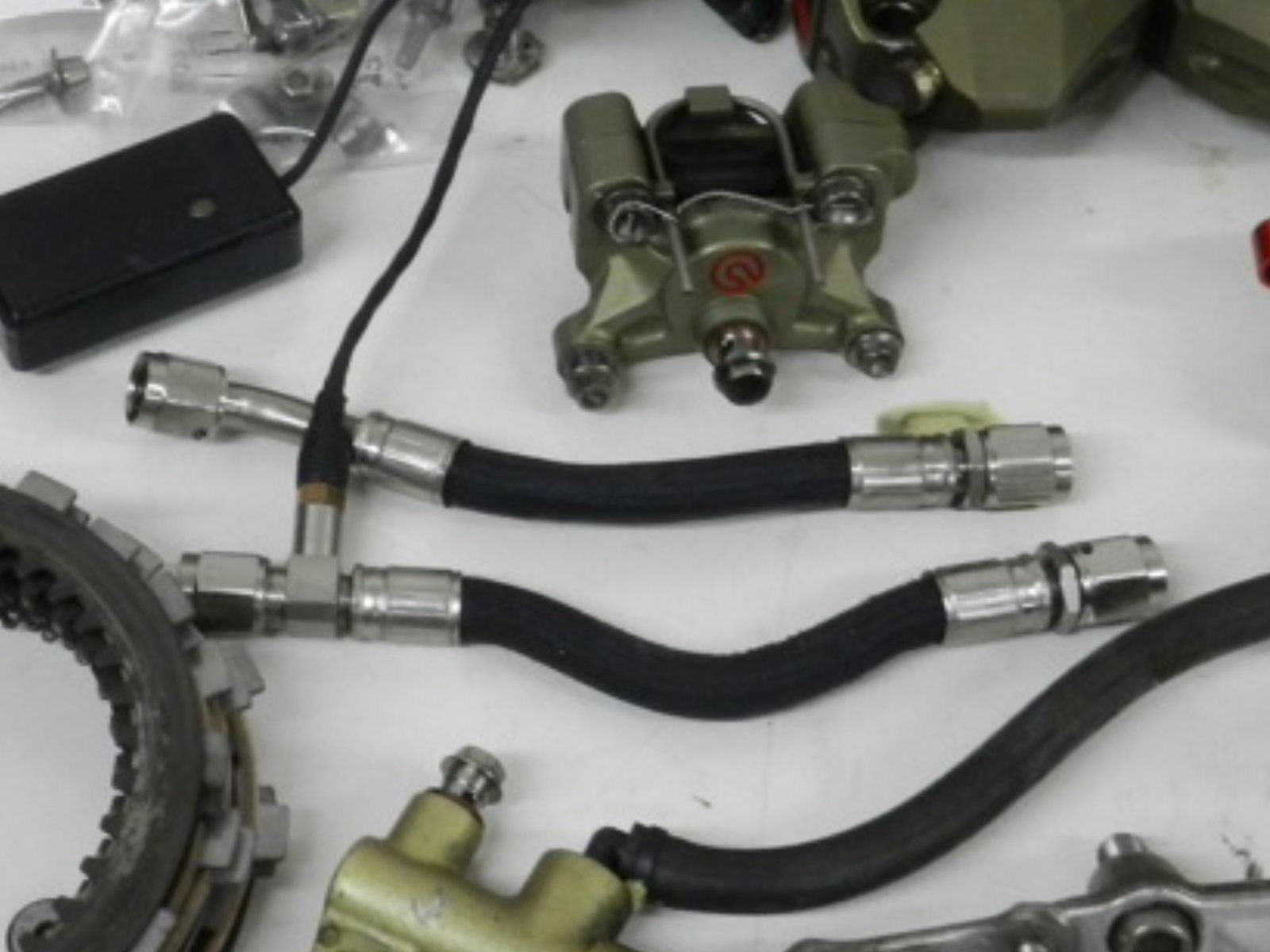

  5. This is what I'm after achieving but at £750 for the pipe and £250 for the sensor, I need to go down a different route. :)
  6. Just pointed Bettes in the direction of some 848 EVO oil pipes on ebay. Does anyone know why Ducati switched to taking the oil pressure off a T-piece on the pipe work for the 2010 onwards 1198 and 848 EVO? The normal point by the clutch housing is blanked off. [​IMG]

  7. That's going to save a ton of hassle. Cheers chris!

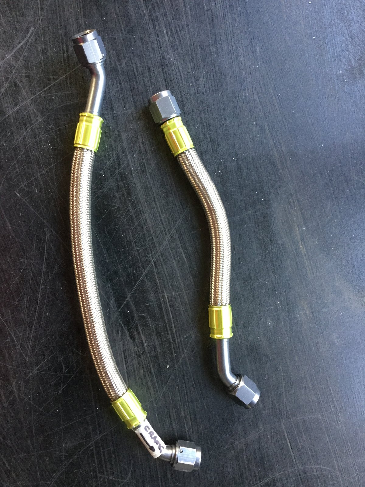

  9. I have those pipes Ian.
  10. Thanks Gary. Sorted for the moment...
    Got a pair of eBay and they arrived yesterday. Just need to get the sensor then to fit it all.

  11. It was done to improve the reliability of the sensor. Theory was that it being screwed into the engine casing was causing premature failure (heat/vibration). Seems to have worked tbh. as the later bikes don't seem to junk sensors anywhere near as regularly now.
