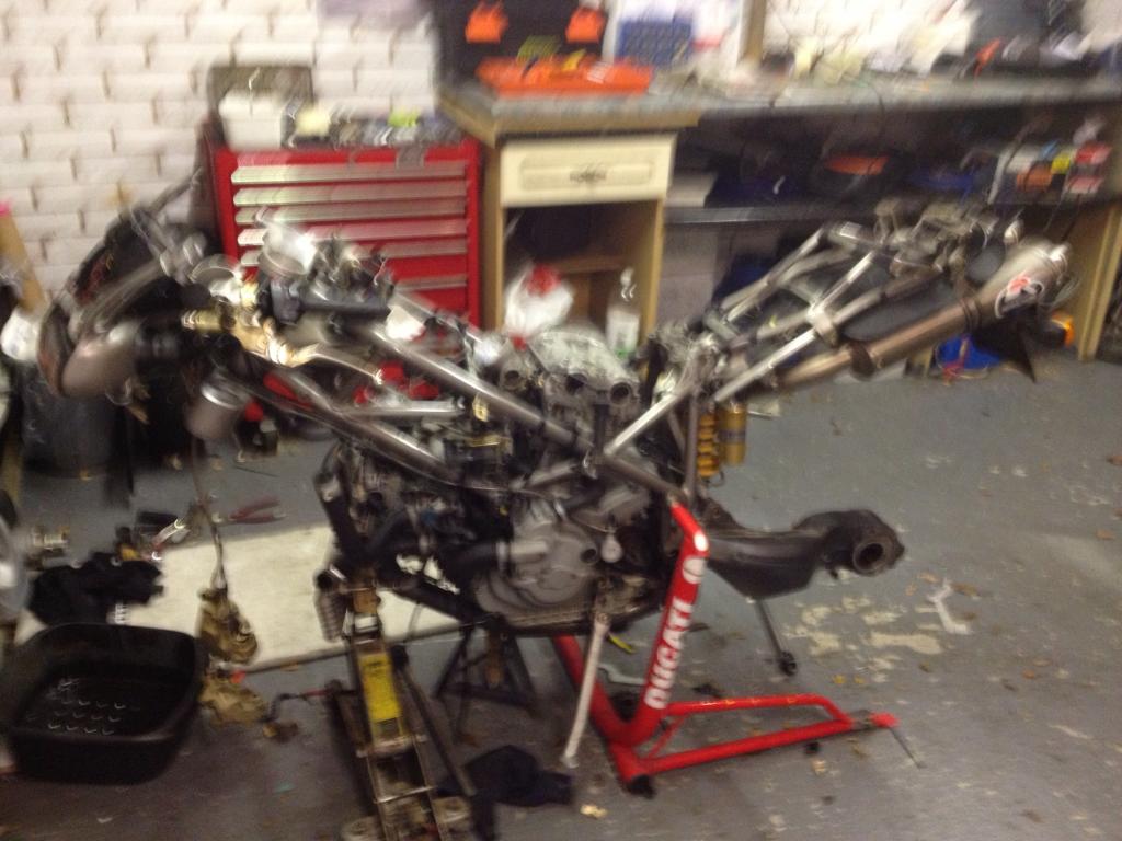

  1. Hi all I've got it stripped for service and clean up plus a few random little jobs,
    but can't decide if to do fork oil and seals myself or just drop the forks at my local dealer ( moto Italia )
    whats the going rate for a dealer to do a job like that these days ? I know I could just ring em but want to know what a sensible price is before I say yes really....

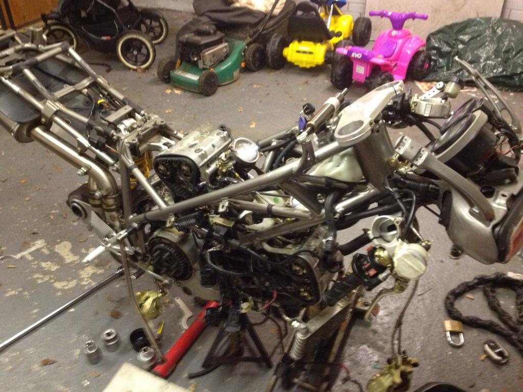

  6. Cheers, inlets stuffed with paper towel and airbox off to carry on with the fettling.

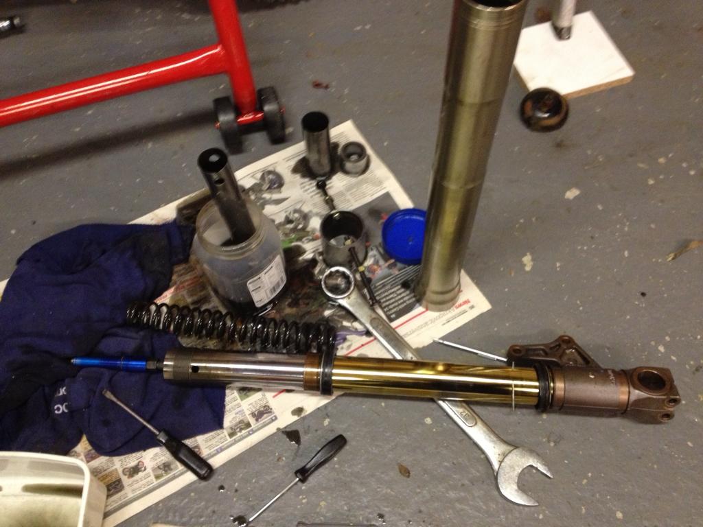

  7. Did my fork seals today,what a crappy job! Oil every ware & struggled to get the new seals in straight at first.
    hope I won't have to do those again anytime soon.
    painting swing arm and taking shocker off to clean up next so at least that will be a " look what I've done job "

  10. Just before I put the oil back in and the top caps back on the forks can anyone tell me if its normal to not need the "flat washer tool"when stripping/rebuilding these forks ? i made and used the clamp tool that stops the centre pin turning.
    I just cant understand what the washer is suppose to do.

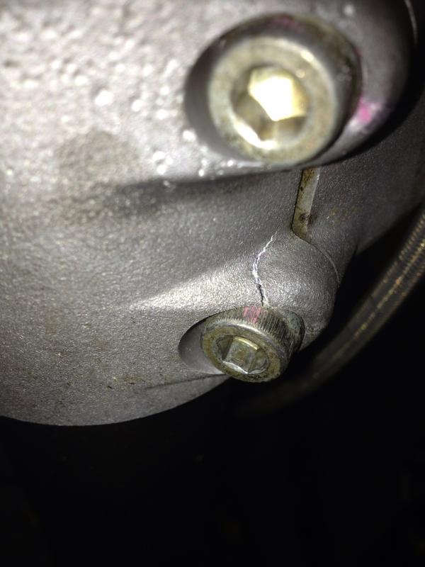

  12. Ive got the forks back together but... ive put at crack in the bottom yoke over tightening it. i have got some pics but the uploader seems to be faulty.
  13. Oh dear - doesn't sound nice, hope you get a replacement part cheap enough.
    broke a few bits n pieces during my fettling, but nowt that big just yet...
  14. think my mate is going to TIG this up for me
  15. how could you manage to break that?
  16. I just nipped it up with an Allen key socket on a 3/8 ratchet ,not even that tight and I heard a click. closley followed by a loud "shit" from me. Il have to check the torque settings in future.
  17. My mate recons he can TIG weld it no probs
  18. Make sure he uses the correct filler rod. Think most pressure or sand cast parts are usually made from an LM24 type ally or derivative. Some have magnesium mixed in which causes no end of issues including bursting into flames if there is a high ratio of magnesium alloyed into it. If incorrect rod is used you can further weaken the casting and/or cause an electrolytic type reaction between the casting and the weld that'll look crap even if you smooth/blend it in and blast it to make it look like its surroundings.
  19. Thanks for the info as I know nothing about TIG ect so will pass it on when I hand over the yoke. My mate is a pro alloy welder on the local steel works & also does some work for a BSB team so hopefully he may be as knowledgeable as you mate ! Thanks again
