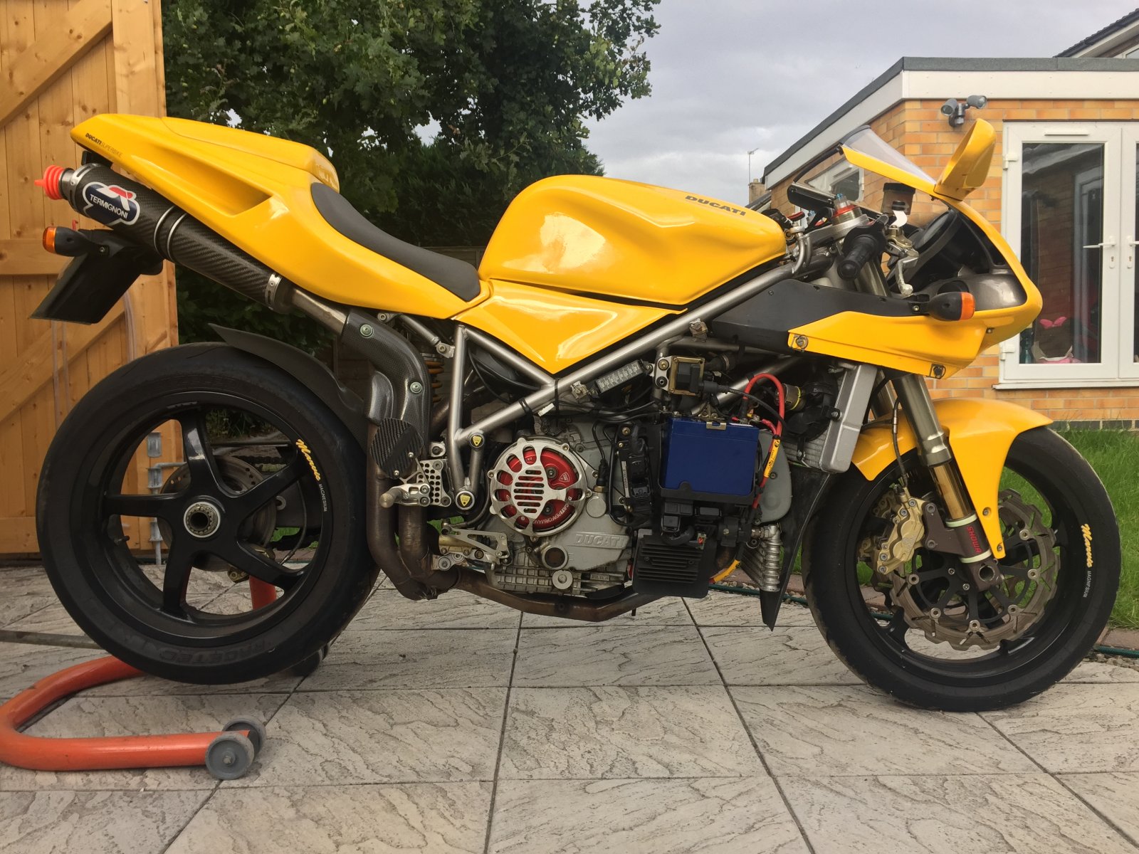

  8. [​IMG]
    It has all the s parts on it, the log book, frame and duke UK say it is an S and I can see the sump does extend into that belly pan in a V shape?
    So all looks good?
  9. P4/34 Brake calipers as well which were not on the 998 base model.
  10. So looks genuine? :) I am pleased.
