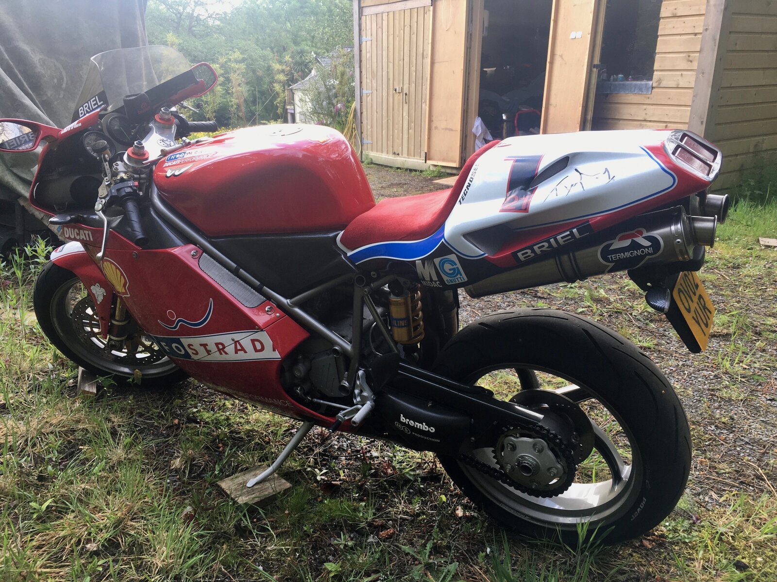

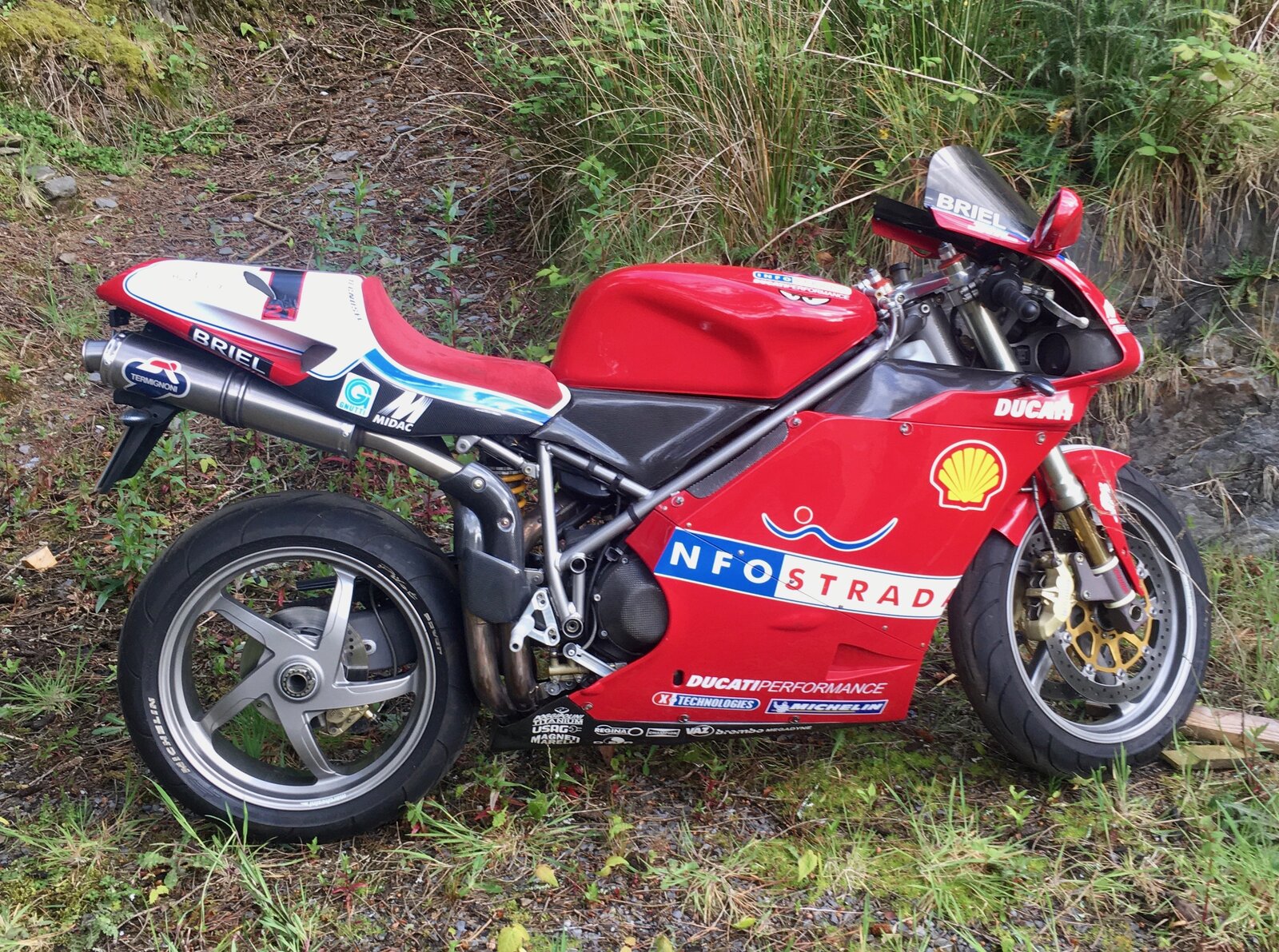

    1 owner, full service history, 5800 miles (only done 1200 miles in the last few years) so hardly used. It has a few extra farkles on there (yes, I know, it's a biposto with a mono seat before anyone points out) such as titanium Termis, CF air tubes, CF clutch cover, CF mono seat, CF exhaust heat shields, CF fuel cap, DP race footpegs, plus I have a big bundle of paperwork including original invoice. I also have the original seat, the original footpegs, the original exhausts and all the other original bits that have been replaced, plus both keys and the original book/manual set. It was also spec'd when ordered with a Troy Bayliss Replica decal kit. Not the same kit as THE Troy Bayliss Replica but (thanks to @andyb ) I've identified it as the kit from Troy Bayliss' 2002 WSBK Ducati. Oh, and it has his signature on the mono seat, not once but twice*.
    It's currently in the shed and it's refurb is underway.
    * Well I was told it's his, it could be just some fella in North London who scribbled on it one day:confused:

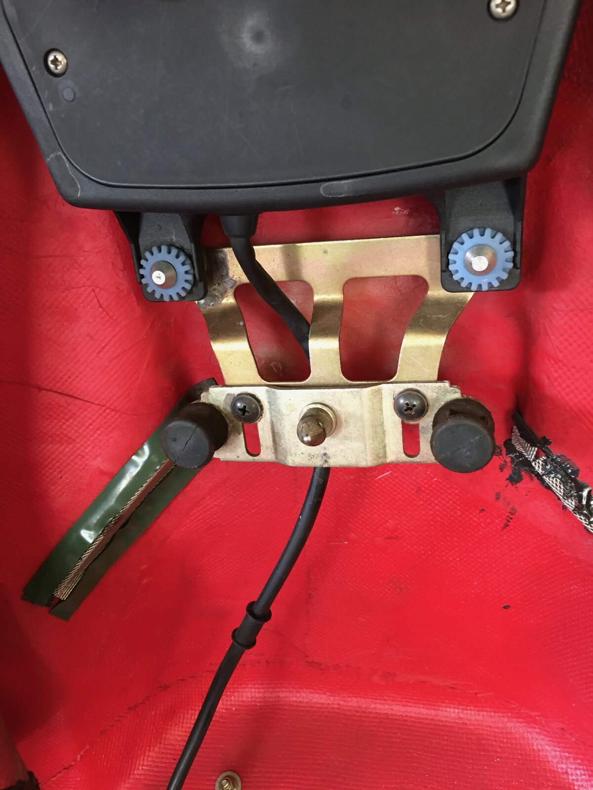

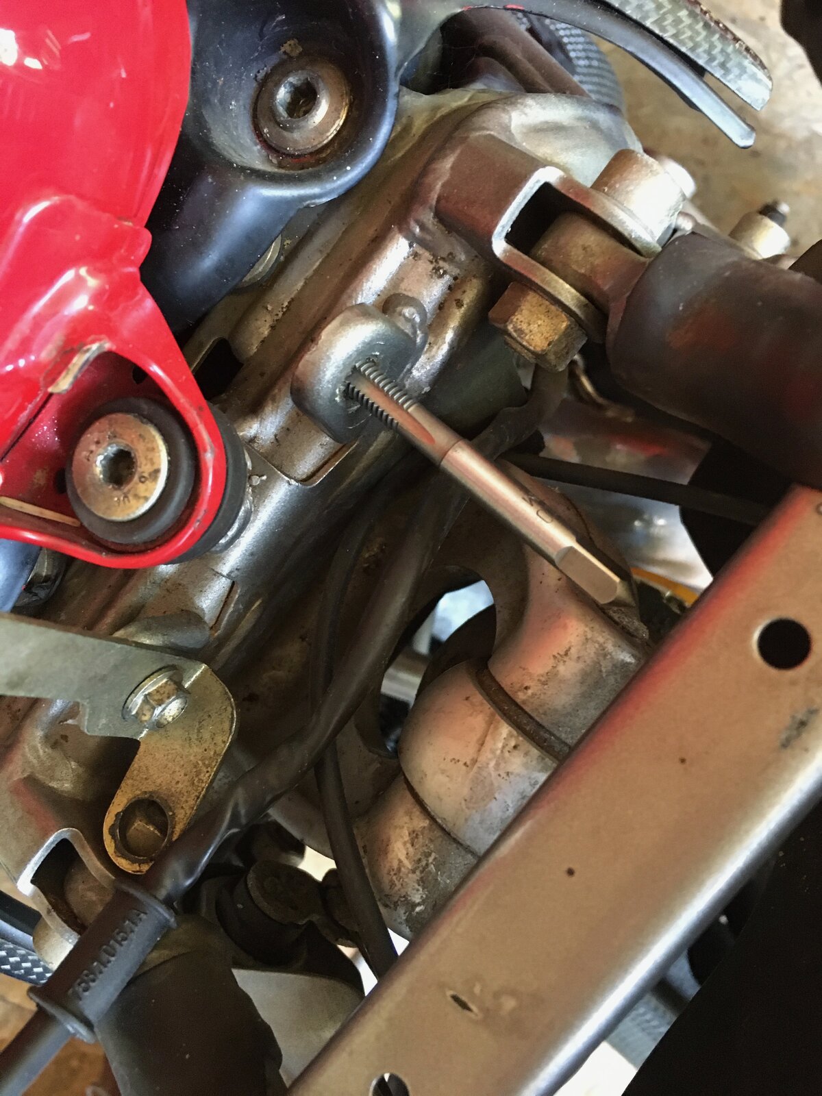

  3. First, fix the wonky seat. The mono seat was loose and wobbly and I certainly wouldn't have wanted to sit on it whilst riding. Turns out the rear assembly wasn't screwed into the fixings securely (note it's the fittings off the biposto unit repurposed for the mono seat) so I fixed that easy enough however, that wasn't the only problem. The front hinge was also loose.
    Easy enough, just tighten it up. Errr, not quite that simple. I don't like the way the bolt is extremely difficult to screw in :worried:. Take a closer look and it's at an awkward angle, remove it and attempt to refit it, nope it goes in at a strange angle. It's cross-threaded:mad:. Someone has cross-threaded it in the past and then just left it loose.
    To the rescue comes my €9.99 Aldi tap & die set:upyeah:. A bit fiddly due to the limited access but eventually the socket is re-threaded M6 (it wasn't too far gone) and a new bolt is fitted. The seat now fits and catches securely:upyeah::).
    First job jobbed:upyeah:.

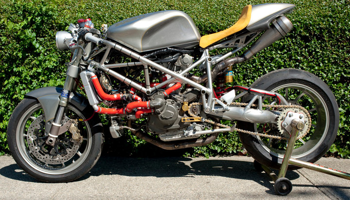

  14. I was thinking Cafe-Racer:thinkingface:. I've got a couple of ideas in my head.....
    LOL :D.
    Sympatico Resto
    • WTF WTF x 3
