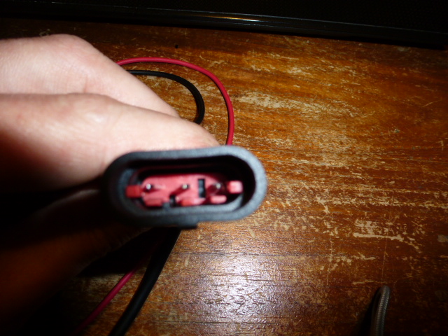

    Looking for the right diagnostic cable.
    Does anybody have an link were I can buy the right cable.

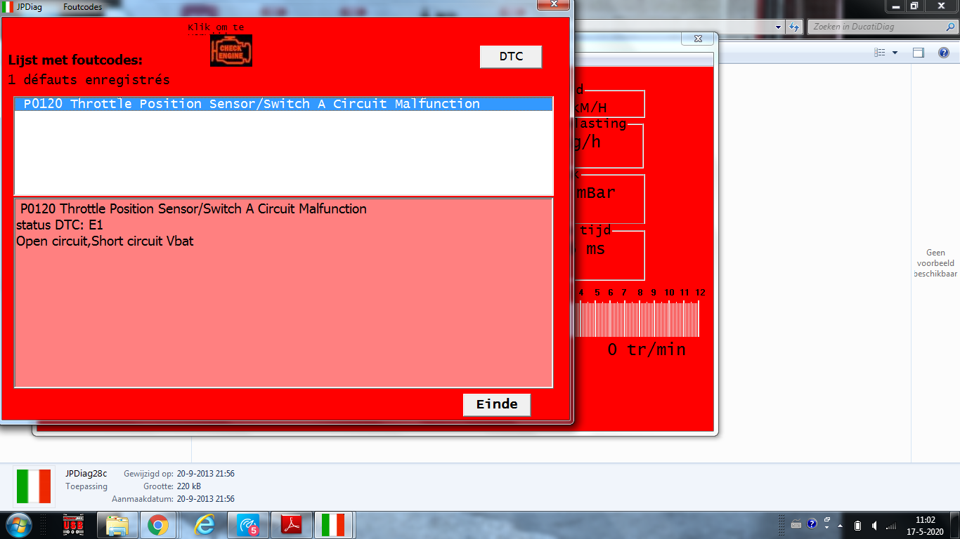

    I need to do an TPS reset. and search out other fault codes. 1.2 10.1 and 19.2
    Bought an cable set 3 pin to 16 pin. 16 pin fit the Blue connector to the computer USb, But the three pin does not fit the 749....
    Have searched the forum but can not find.
    thanks in advance,
    picture is of the cable I have.
  2. The layout of the 3 pin connector is wrong. This one is the type you need
    https://www.ebay.co.uk/itm/223929336667
    Look at the image of the 3 way connector and you will see a plastic lug that prevents wrong connection. There is a hole on the diagnostic port to accept this.

  4. 1.1 = TPS error
    10.1 = Horizontal coil error
    19.2 = starter contractor error
    That is a strange combination. First thing I do with any possible electrical problems is fit a new coil/injector/pump micro relay. It is a £2 part that causes no end of problems.
