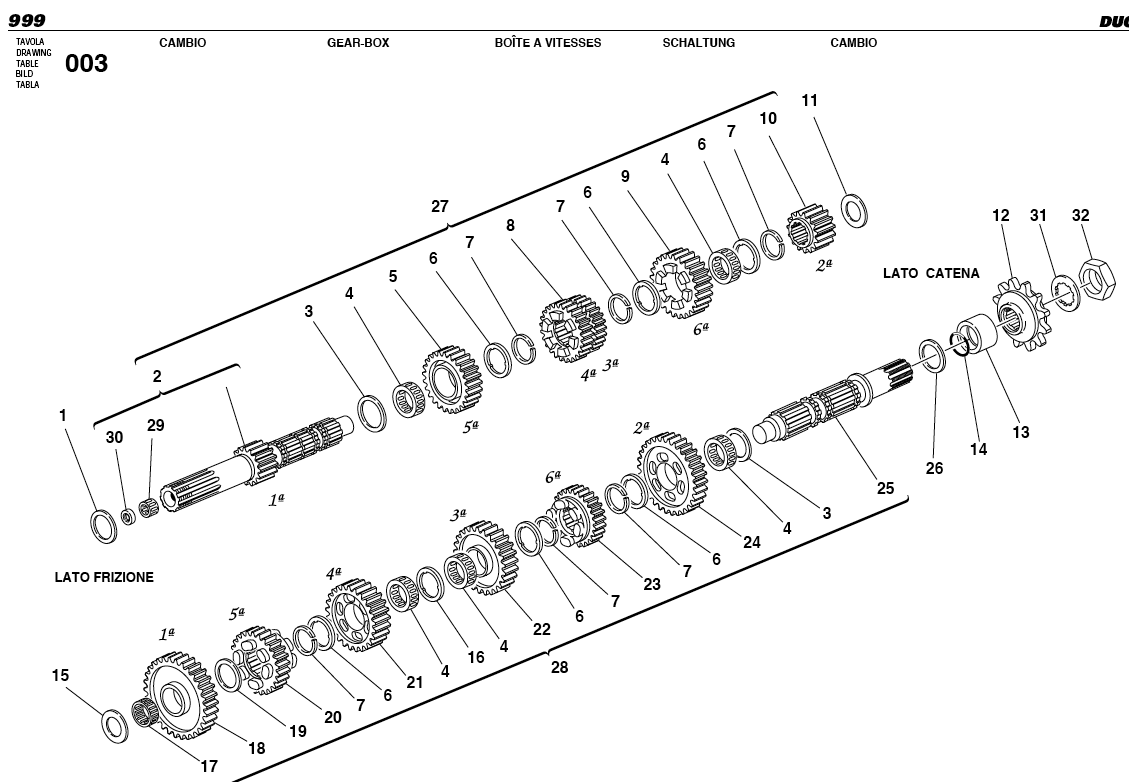

  5. There is also an oil seal at the clutch side in front of the needle roller bearing inside the mainshaft.

  7. The oil seal is on the clutch side of the main shaft. If it is failing oil will find its way through the shaft to the slave side. Item 30 in this pic from the parts list. Screen Shot 2019-04-11 at 18.00.11.png
  8. Wouldn't failure of this seal show itself by leaking into the clutch? I assumed the rod would be covered in splashed oil where there is a gap in the tunnel that it passes through and that is the reason for having the 2 o rings in that position. Am I wrong?
  9. Thinking about it, yes. But since one end of the shaft is at the clutch and the other at the slave there should be no oil to get through the shaft unless there is an opening into the centre tube from within the gearbox, which I'm sure there isn't.
  10. I had this on my 916. The clutch side oil seal failed. It was evident from the light oil spead radially from the centre like tendrils. Easy to check, just remove clutch. A further sympton was a well oiled side stand, which i incorrectly assumed was an over oiled drive chain and/or the rod rings. The oil seal is a very simple fix, but you have to remove clutch casing. I cant recall any difficulties. I never even drained the oil, just leant the bike over on its sidestand. Which has the 916 lean.
