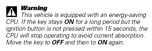

  11. From the owners manual for the ST4s which also uses the 59M ECU :
    This suggests that it is normal for the 59M.
  12. That's good information Derek thanks. What section of manual did it come from and I will check what the 999 manual says.
  13. It's in the section about using the keys and the ignition switch.
  14. Normal behaviour. You have 15 second window to start.
