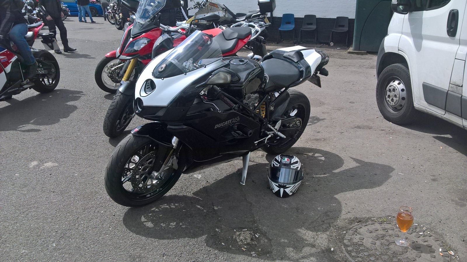

  14. Welcome, throw an image or two at us!
  15. yea and get some pics up! We like pics
  17. that ones all good mate. It was my 748 I had to crash.. It's not to bad tbh wont be a write off by a long shot but all the lil bits add up so maybe 1.5 - 2 k including paint.
