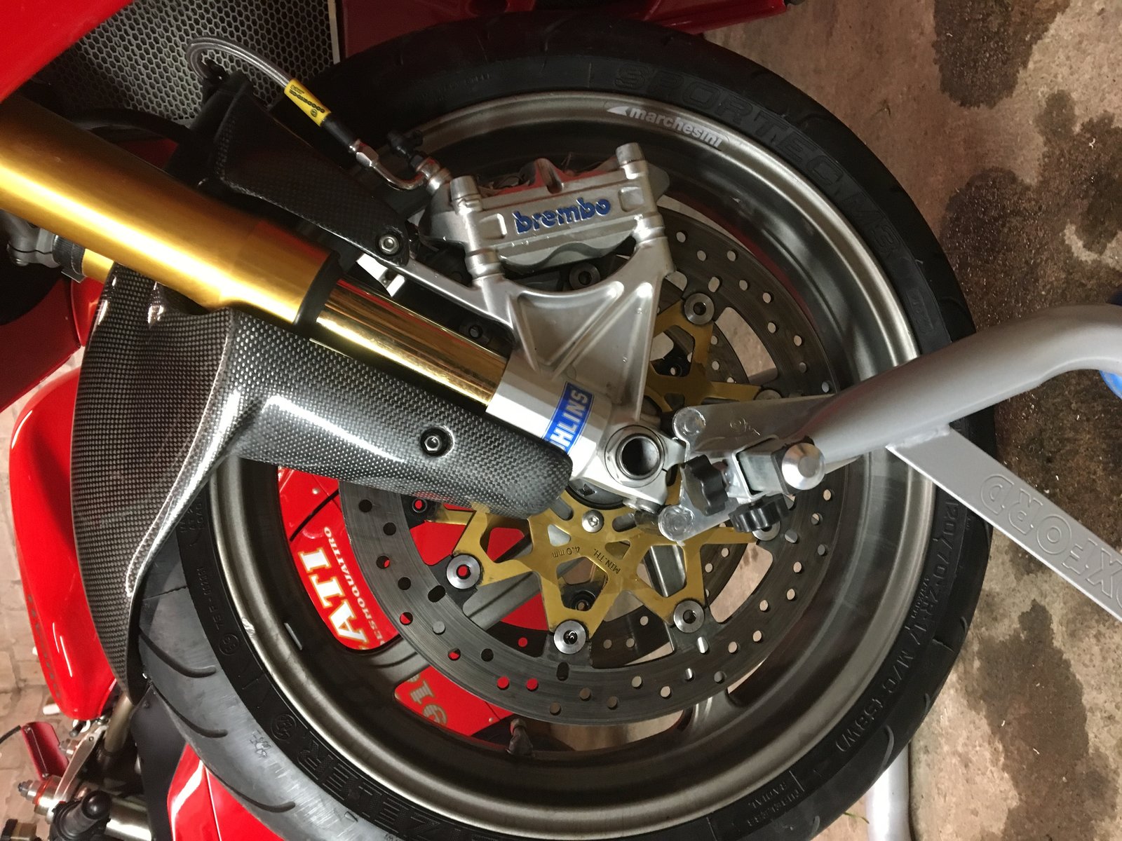

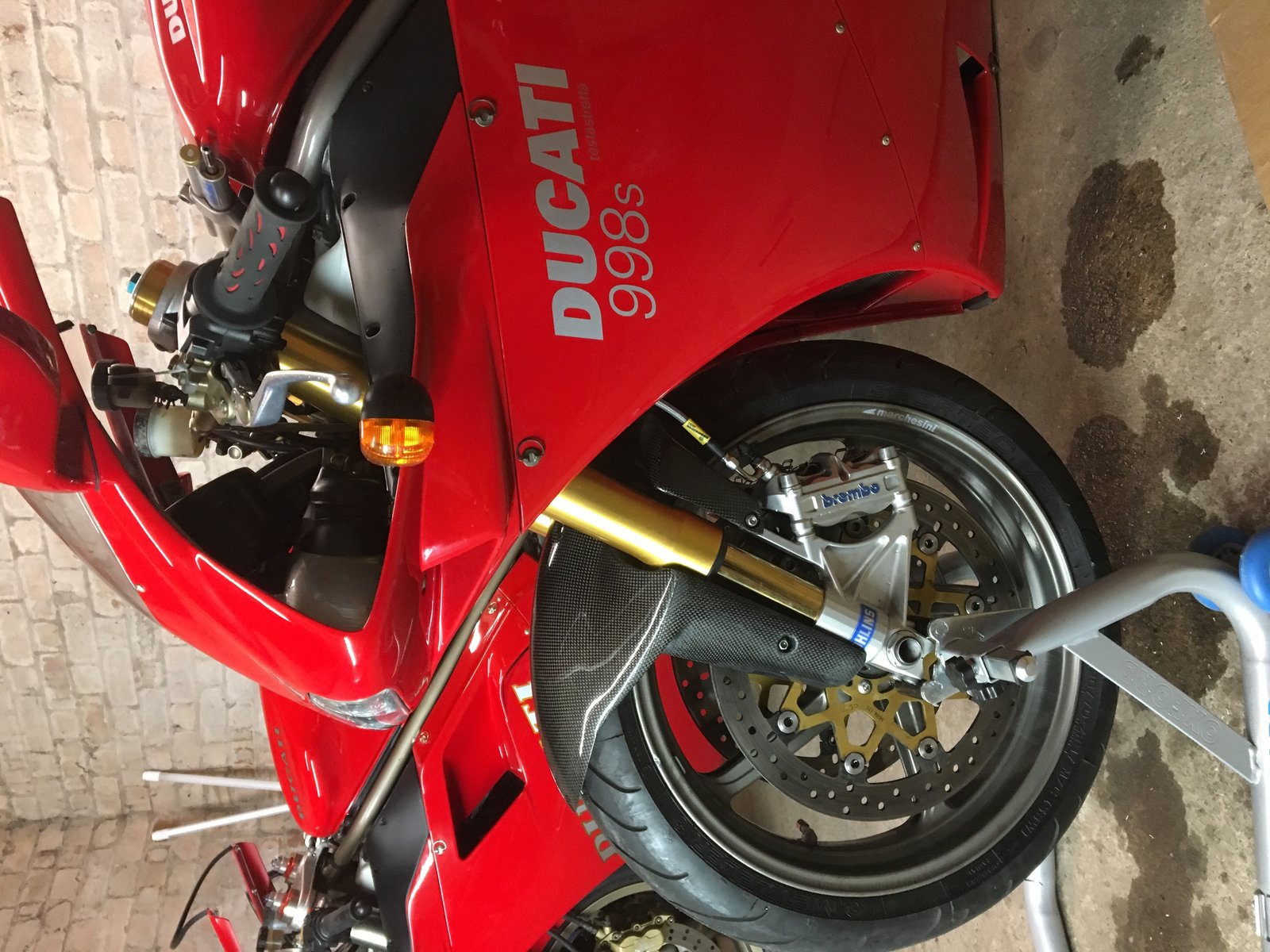

  1. Having realised that tracking a mint 998S isn't the smartest of decisions, 998a.jpg 998b.jpg
    So if anyone is interested,
    Ive decided to sell the complete 999R Ohlins and radial brakes setup and revert back to standard.
    The complete unit will include the Ohlins, 999R bottom yolk, original Ducati performance carbon mud guard, modified spedo drive (not needed if fitting to 999), brakes and lines. Wheel and discs not included.
    All items are as new.

  4. I am interested but you don't indicate a price. I'm definitely not interested in 'make me an offer' so would you let me know how much you are looking for? Also, are these the same diameter as the original Showa forks? If not I'm gonna need the top yoke and whatever that bar is called that goes through the headstock?
    They would be going straight back on to another mint 998S and straight back on the track!
  5. I suspect you'll need bottom yoke...:upyeah:
  6. If looking for Showa forks and 53mm bottom yoke I have some here if needed
  7. Evening All
    To answer a few questions:-
    The bottom yolk is included and is 998R which is larger than std Showa. The top Yolk on all 916 series and 999s are the same so the standard Showa top yolk works fine and is included also.
    The discs are not included but are std 320mm Brembo discs that fit all 916 series bikes with 5mm offset. The discs have recessed bolt holes that allow the bolts to miss the speedo drive, but not necessary if fitting to a 999 only the 916 series. There is also an engineered 5mm spacer to align the discs to the calipers.
    If I ask for £1500 then this will be a third of what they cost me.
    Thanks for your interest.
    T
  8. One thing I forgot to add....
    I'm using the std brake master cylinder with twin braided hoses. The hoses and the twin banjo connection will also go with the setup.
    Basically its a complete front suspension setup less wheel and discs.
