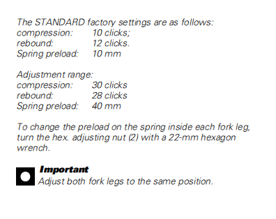

  1. I wanted to set the 999R forks on my hybrid build to factory settings, just to use as a starer.
    Looking at the manual it suggests 10mm as the preload. How is this measured/adjusted?
    Is each turn 1mm? So maybe wind the top nuts all the way up/out , then back in 10 turns?
    I usually use the cable tie method and adjust accordingly, but was after a stating point.
    Cheers
  2. Yes. Wind all the way out. Each turn is 1mm.
  3. Cheers Wicky...:upyeah:
