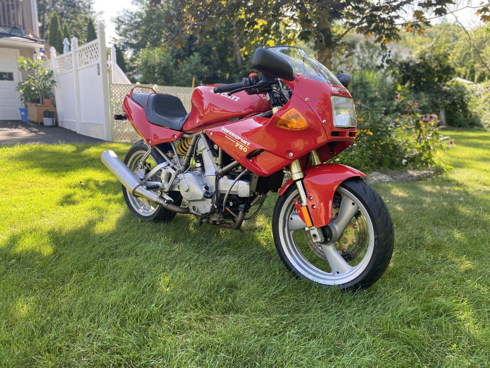

    28 years after I bought my first beautiful 1993 750 super sport from Munroe motors in San Francisco, I finally found a twin bike. My goal is to restore it back to factory condition. Look forward to learning from everyone.
    I could use some info on replacing the swing arm if anybody has any details.
