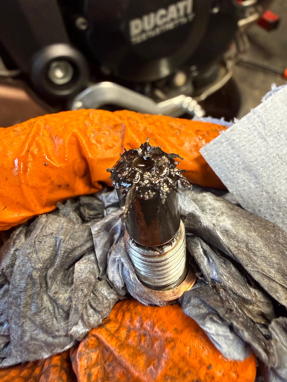

Hmm, what do people think? MultiStrada 1200 2011MY 29,000km/18,125miles. No sparkly bits in the oil, just a lot more than usual ferrous bits stuck to the magnet.
I've no idea, but is it possible that it's from the rockers? were they still prone to flaking like early 9xx models

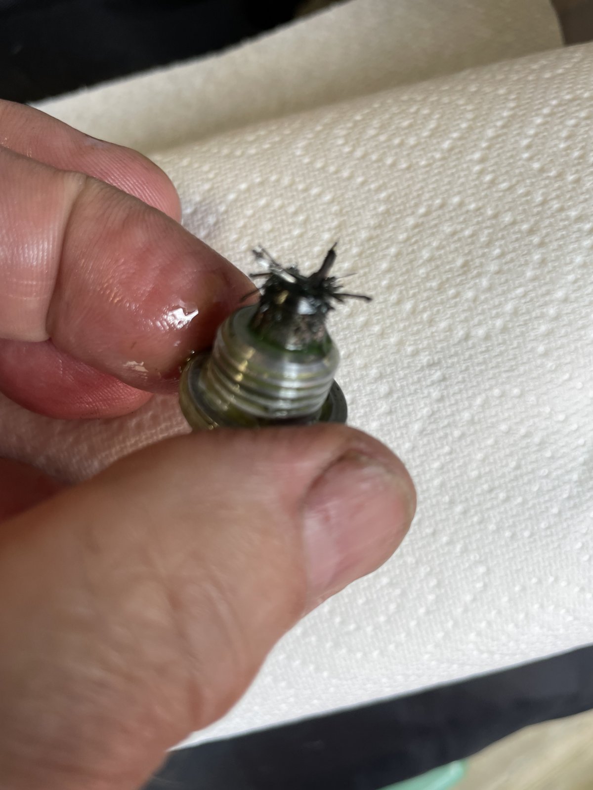

2020 v2 Pani. 4000 miles. For comparison. Bike continued to run faultlessly on track. That was pre track activities.
Yeah, I’m thinking it’s just gearbox shards but what’s at the back of my head is some of the early Multi 1200s have a bit of a reputation for eating crankshafts

Could be worth getting a small clean container and filling it with kerosene or petrol and giving the plug a good swirl in it to clean the oil off the debris, and unless you have a SEM with EDS in your shed, then remove the debris and place it on some clean white paper and post some images up (magnified if possible, with the edge of a ruler for scale). Someone familiar with morphology may be able to give you a better idea as to the type of debris (build swarf, brg material, gearbox bits, etc) it is. Also, did you remove the course strainer and if so did that have any debris, magnetic or otherwise, if so might be worth also washing in kerosene or petrol, and straining through some filter paper (kitchen roll) for a similar review.
Too late, I wiped it all off with some garage roll and it’s now in the bin. Mind you what’s SEM and EDS please?
Yes, but something has to go out of order first for them to start oscillating and then snap. However, one would expect the con rod big ends to take some grief first and there’s no sign of bearing shells in the oil. I do think it’s just a bad example of gearbox wear.
