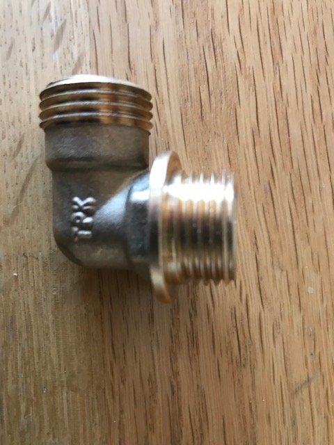

  1. I am fitting a shower and the connections are male 1/2nps (not tapered thread parallel)
    what do you normally do to seal and tighten them? As they are crying out for a washer of sorts not just ptfe and/or gew?
    ta
  2. I’m not a plummer -hi
    But would that be a job for a fibre washer?
  3. Yep, as the man says. Good quality broad fibre washer, a good wrap of PTFE & a smear of LSX joint sealant.

  6. ptfe tape clockwise as you look at it.
    Plenty of flat wraps(6ish) with some over the shoulder.

  10. thanks all sorted with washer tape and gunge..

  12. I’m guessing it’s after the shower valve, so low pressure. I usually use a combination of fibre washer and ptfe on the thread.
  13. carr01 is spot on with this question:upyeah:but never mix ptfe tape with sealant as it's one or the other:upyeah:
