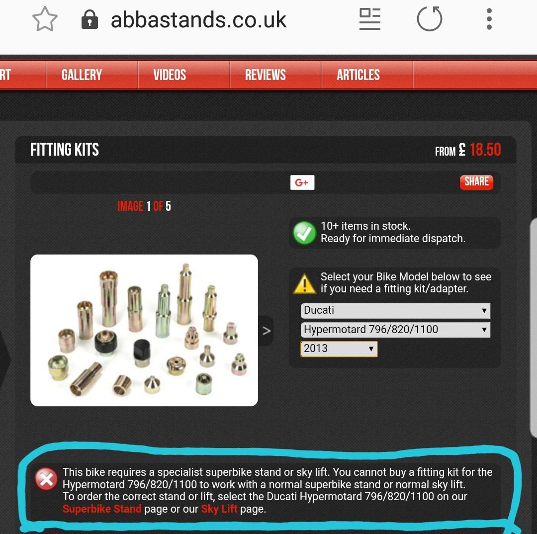

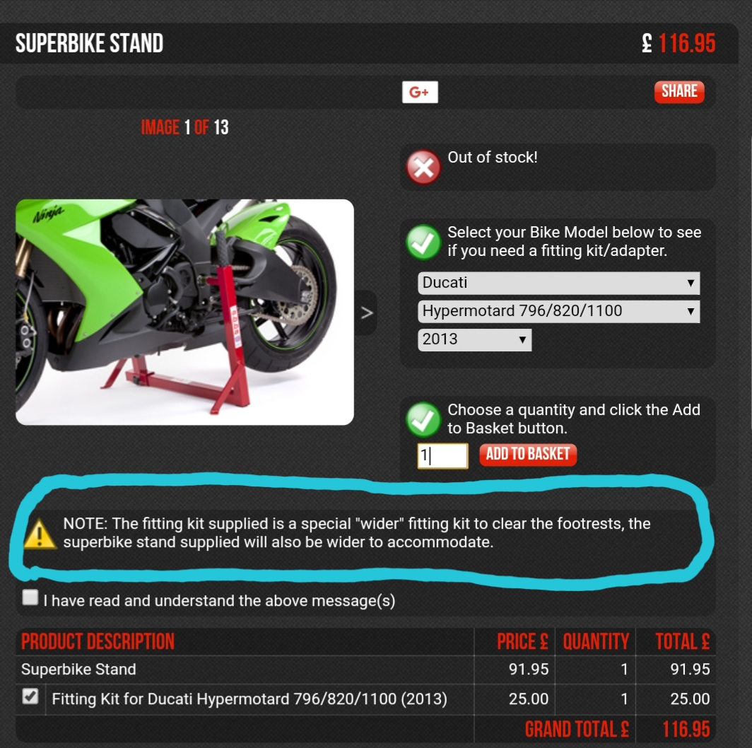

  3. When I went to the Abba website to purchase just the fitting kit for my Hyper (821 - 2013), which I would have to buy if I get a 2nd hand Abba stand originally bought for another bike, I found this problem:
    So I checked the Superbike Abba Stand product page, set the bike to match my 821 2013, and got this warning message (regarding the superbike stand being wider for the hyper):

    The abba for the hyper has a longer base section. The nearside footrest fouls the abba, sorted by using reuseable tie wraps. The offside can be adjusted on the thread to miss.
    The fitting kit is exactly the same as the 1100 monster kit.
    abba don't tend to have the hyper stand on the shelf, they make periodic batches.
    The standard super bike stand can be used at a push but it's right on the end of its adjustment and fouls both footrests.
