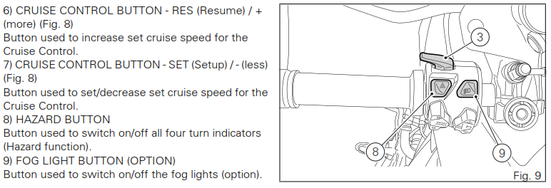

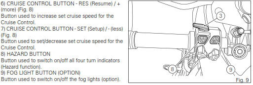

  9. There is a button on your handle bars - left side - back
  10. On the 2015/2105 DVT model, the switch for the auxiliary lights is built into the left hand switch gear, see Owner's Manual (1200S version, page 39).

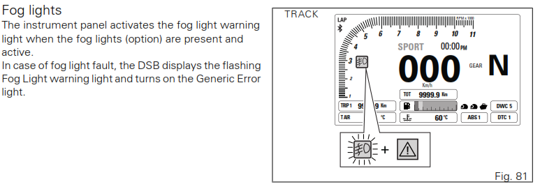

    There is a warning indicator on the display (1200S Owner's Manual, page 166)
    The auxiliary LED lights have to be switched on separately after the ignition has been switched on. The engine doesn't need to be running, but you would usually wait until it is before turning on the lights. So you have to remember to turn on the lights every time.

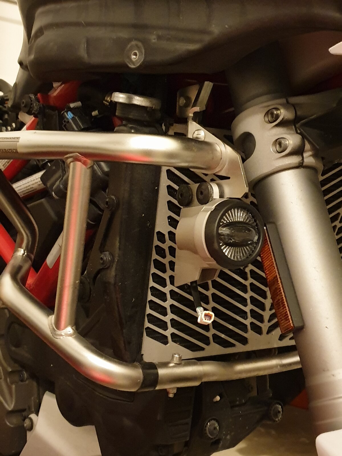

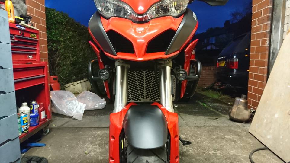

  15. I didn't take any of the panels off other than the 2 side panels for access to the radiator mounts on either side, see pic below. You can see the light mounting bracket and bolt above the rad cap
  16. Excellent pic! Ducati are just trying to scare people into taking to the dealer with those instructions, also my fog light kit came with two sets of fog light brackets one pair is longer than the other, this is for mounting directly to the bike not to crash bars, I think the sw motech crash bars will also fit with the fog lights mounted to the bike :), I will be putting it all on tomorrow
    Sent from my F8331 using Tapatalk

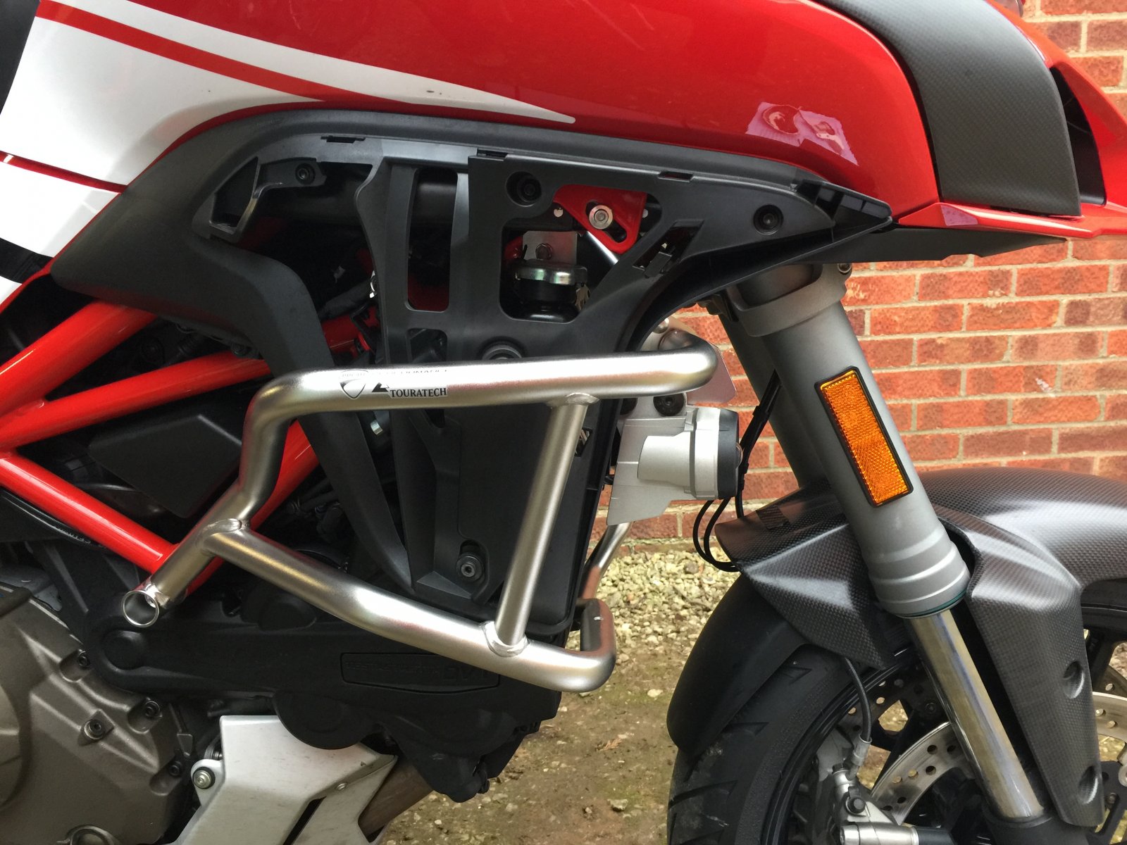

  17. OK I have managed to fit the fog lights with the sw motech crash bars, the fog lights are mounted to the bike not the crash bars, I had to make a pair of extensions for the ducati brackets [​IMG]

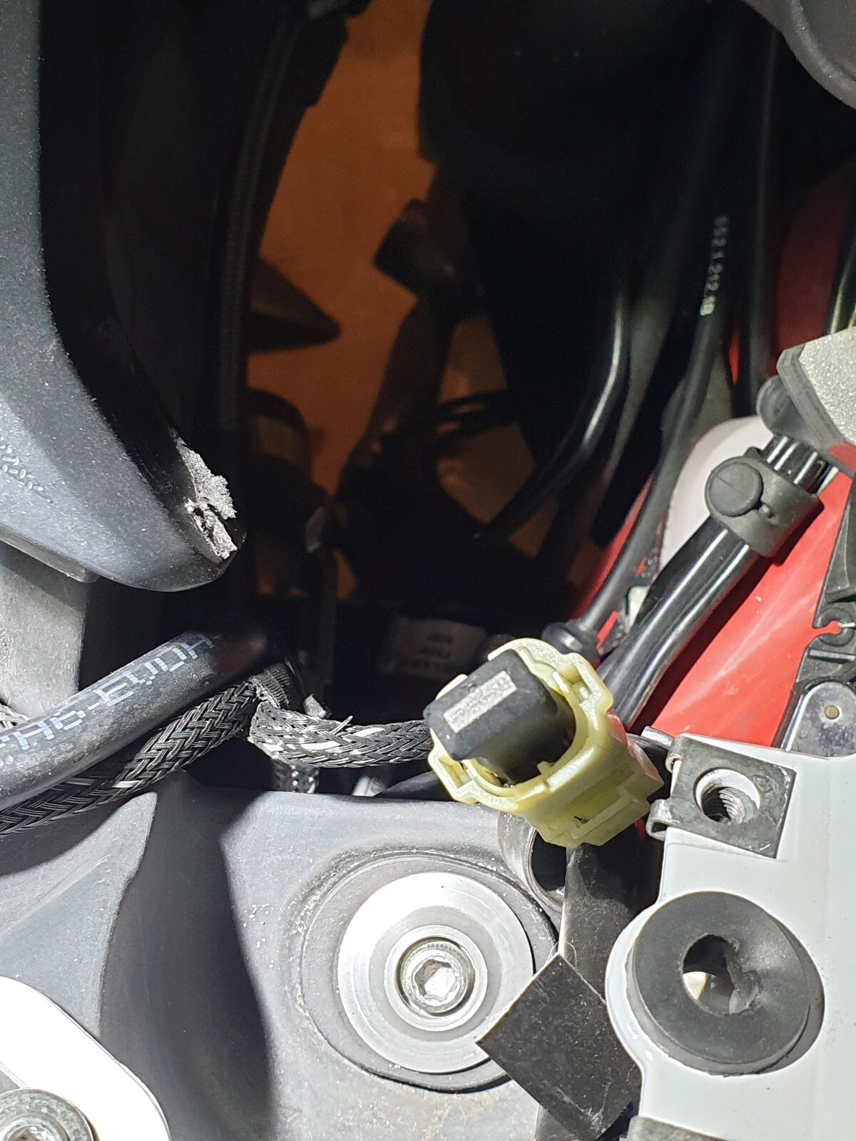

  18. Hello everyone,
    Happy New Year! Best wishes for 2020

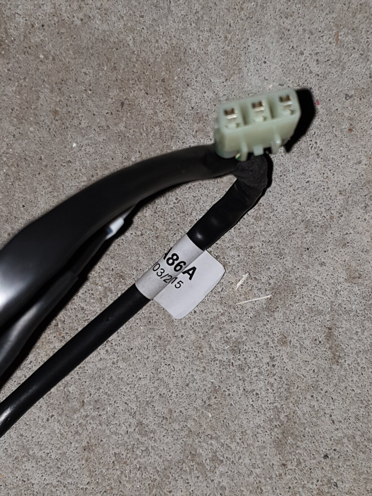

    I am installing the OEM Ducati Auxillary LED Lights [96680431A] on my 2015 Multistrada but I haven't been able to locate the 3 pin connector to attach the extension for the lights.
    In the attached photos, I show the two connectors I found on the left side of the steering.
    I will appreciate any help.
    Thank you!
  19. From memory, there are three electrical sockets under the panel at the front of the fuel tank on the left side:
    1. 12V Accessory socket - has a plug installed with short wire tails (typically used for connection of a Sat Nav)
    2. Keyless Fuel Cap socket - has a blanking plug installed, 2 pins
    3. Auxillary LED lights socket - has a blanking plug installed, 3 pins
    It should be obvious which connector to use once you've removed the blanking plugs as it should not be possible to connect the Aux lights plug into the keyless fuel cap socket.
    You'll need to get the Aux lights enabled by a dealer.
