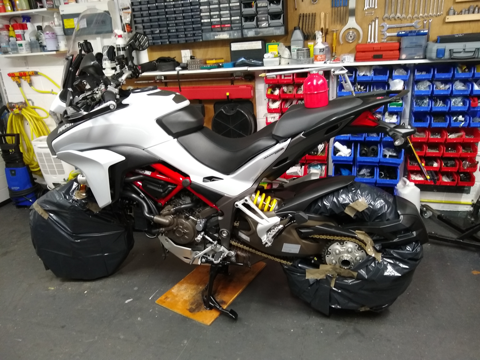

  5. I use a sprayer connected to a compressor to create a fine mist (I warm up the the AFC50 in the bowl first). After a good clean and making sure the bike is dry, I mask up the wheels (brakes and tyres) with plastic bags and then spray on a thin later everywhere and wipe of the surplus with a clean rag. Good ventilation and maybe a mask would probably be a good idea, but AFC50 does have a pleasant smell. I use AFC50 on a rag to wipe fasteners and cotton buds to get into the nooks and crannies including inside hex/torx sockets :) I don't apply all over the paint work (I use Bilt Hamber Double Speed Wax on paintwork) but a bit of overspray doesn't hurt, just wipe it off. When you first fire the bike up it gets a bit smoky as the AFC50 burns off the exhaust.

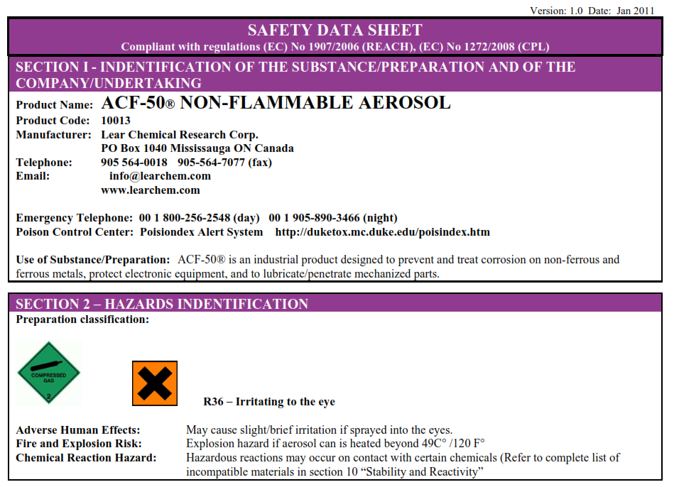

  12. Warming any pressurised aerosol can with heat gun is not a good idea. The data sheet for AFC-50 specifically warns of an explosion risk if the can is heated above 49°C
    • Useful Useful x 3
  13. I'll make sure I keep it below 48C then.
