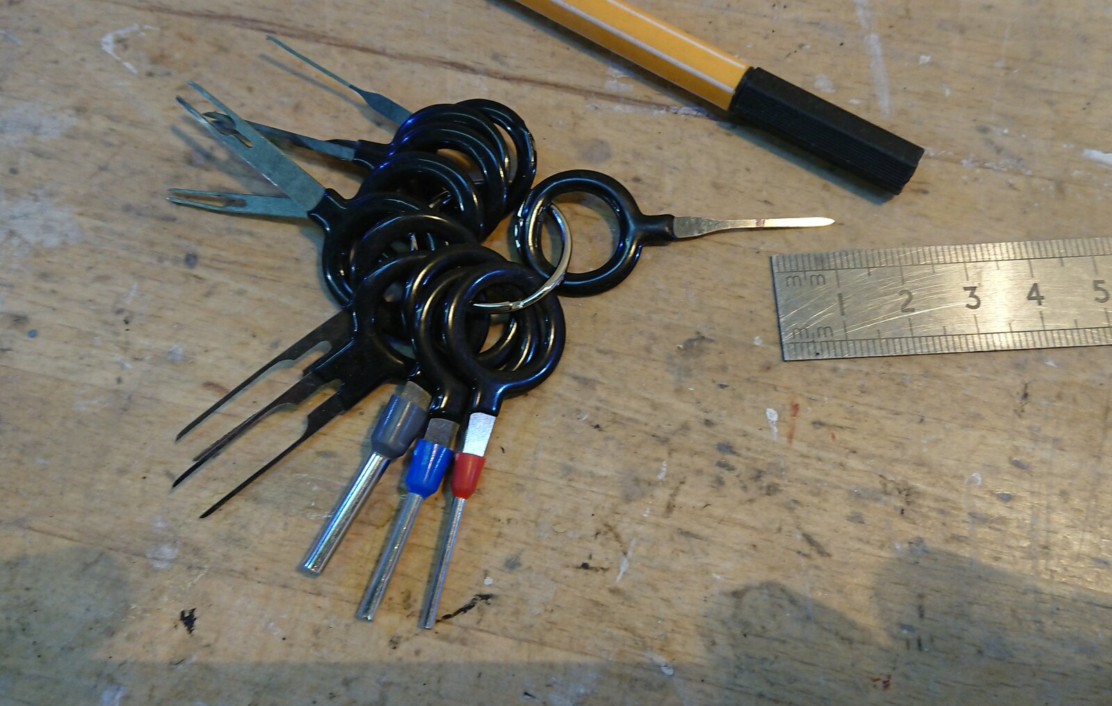

Look on Ebay for a terminal release tool. They come in a set, l used the single flat prong. Detach the fuse box from the bike, push the tool in from the front and pull the wire from behind. Screw drivers will be too big to depress the tang without damaging the fuse holder

Here is a photo of the tool I used. After the first terminal came out of the fuse holder I marked the prong so I knew it had gone in far enough to depress the tang. Chrisw may well be right about there being 2 retention lugs but I found this worked for me.
Thanks for all your help.... thought I would report back. The clue was the tool you showed me DanSS600 and that it was a single blade. I figured that there therefore had to be a single tang and persevered with a thin blade on the underside (as I guessed that should be the only place a single tang could be) with eventual success as there is in fact a single locking tang on the underside of of the terminal as shown in the second pic. Turns out there are no locking tangs on the top side as the first picture shows. Thanks once again for all responses.
