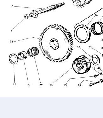

    I am stripping down my Darmah engine and have reached a problem. Having got the Primary Gear off I thought it would be simple enough to split the cases but it looks like I have a Bush stuck on the Crankshaft (26 and 27 below).
    I have been using a rubber mallet on the end of the crank as per the Manual to no avail - the Bush will not move. I have tried heating with a blow torch (hence bluing) and freezing.
    I have removed all the engine bolts/gear indicator cam and rotated the kickstart - there is daylight between the cases all round and I can see the bearings pulling out in the opposite case. There are no visible signs of the Bush having had a seizure or any scoring.
    I'm kind of hoping I've missed something obvious - and suggestions out there?
    Thanks in advance.

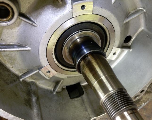

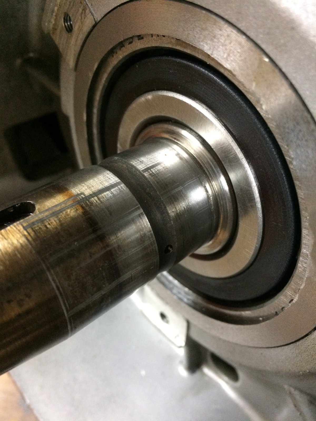

  3. IMG_0748.jpg Thanks for the advice.
    On the plus side - with a combination of careful grinding, heating and levering, I have finally removed the bearing!
    On the down side - the crank is still solid inside Main Bearing. I have clumped the end of crank as hard as I dare. I'm going to try heating the bearing inner only unless someone has a better idea?
