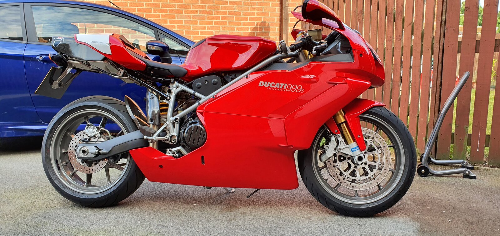

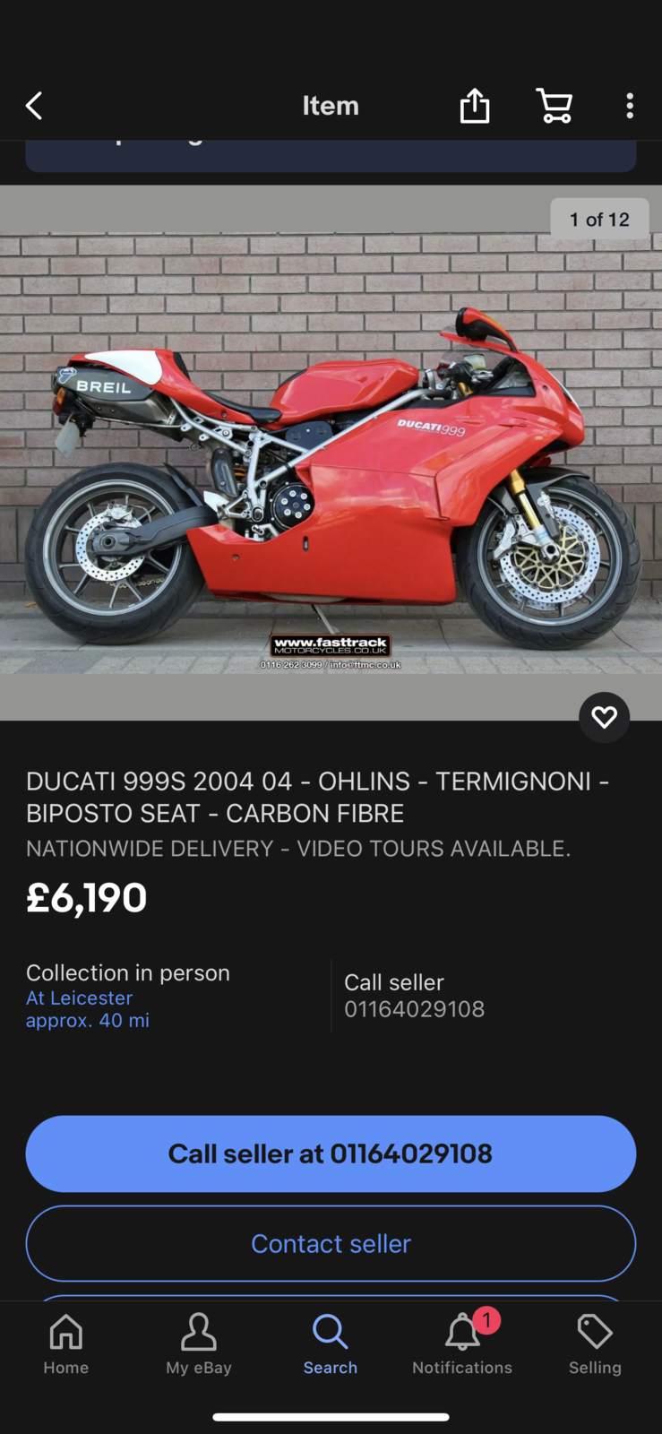

    As the title says I've been looking at 999's for the past few weeks, I'm drawn to the S for Ollins reason really, I've seen one listed near me as an s but I have doubts that it is a genuine one or just had the extras added, obviously the on s badging on the fairings is a big highlight for me, just wanted some advice as to spot one in the future, thanks in advance, happy Christmas! upload_2020-12-24_10-3-5.png
  2. What makes you doubt it?
    The one in the pic has non standard discs (and seat unit).

  6. A 'proper' S will have deep sump engine ( even gen 1) which can be recognised by the gauze filter housing sticking out at the bottom.

  7. The non 999s on the fairings, not sure if it's just had the a bits bolted on, that add says about the different seat, was just after more info from people with more knowledge than me if there were any other indications other than the obvious bits
  8. I'm guessing that wouldn't be noticeable with the fairings on?
  9. Doesn’t appear to have a deep sump engine
  10. Front calipers are none s. Looks like a base biposto with Ohlins added.

  14. Back in the day some lucky customers got a stock 999 with Ohlins suspension fitted because the factory did not have the stock items.
  15. Yeah I was going to say the same about it, no "999s" on the fairings and no deep sump means its not a genuine S.
  16. LG04BGX is 999 not a 999S
    Have look at the MOT history as well.
  17. Ha thanks, just looked at anothers mot history and seen it has the s on the details, didn't think they would put that, thanks for your help! Happy Christmas
