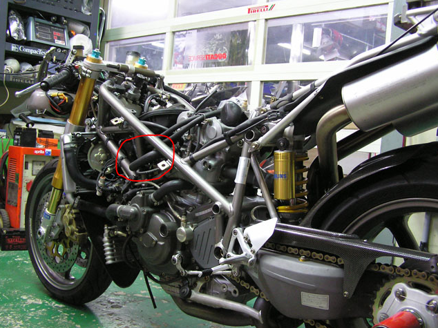

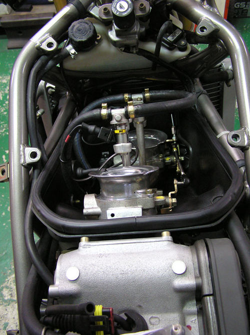

  5. 21mm (17mm on standard bikes) but as the others have said checking for the shower injectors and the cooling hose on the LHS of the bike is the way to go.
    Pictures blatantly stolen from the web.
    Injectors:
    Hose:

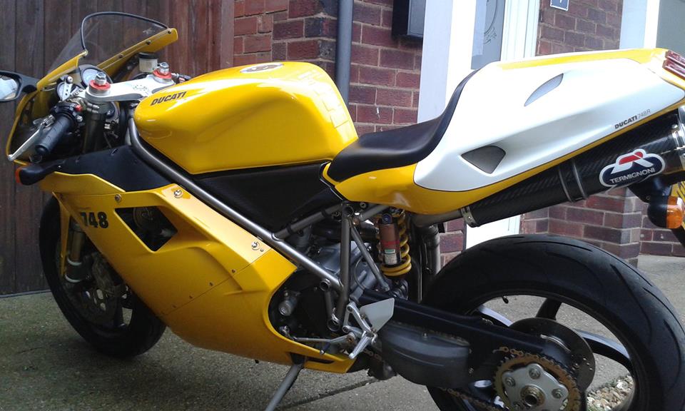

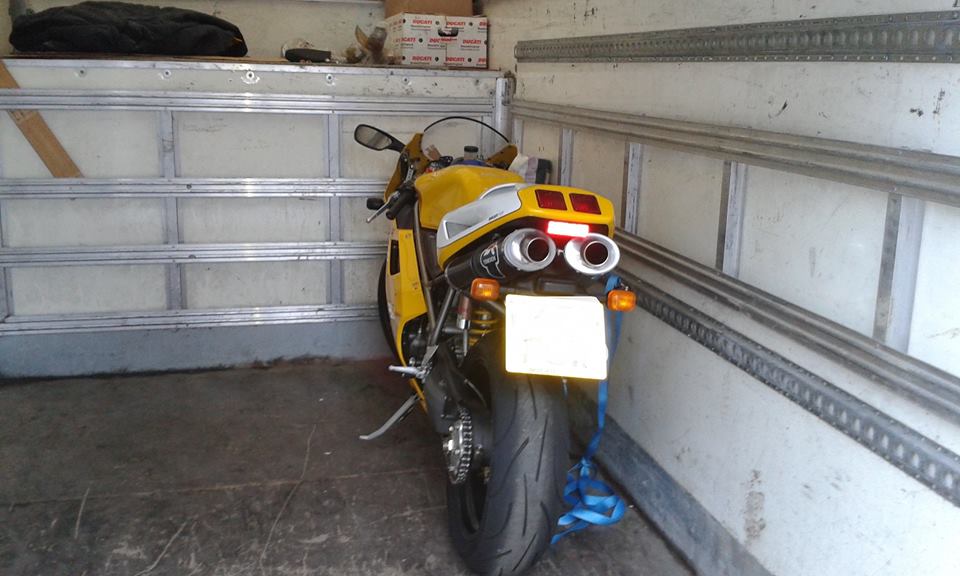

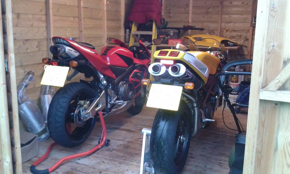

  12. Evening all. Picked up my 748r today in the back of a van, so not ridden it yet. It is wearing 50mm termi's that sound amazing. Will they get through an MOT ?
    #13 steve 748r, Nov 27, 2014

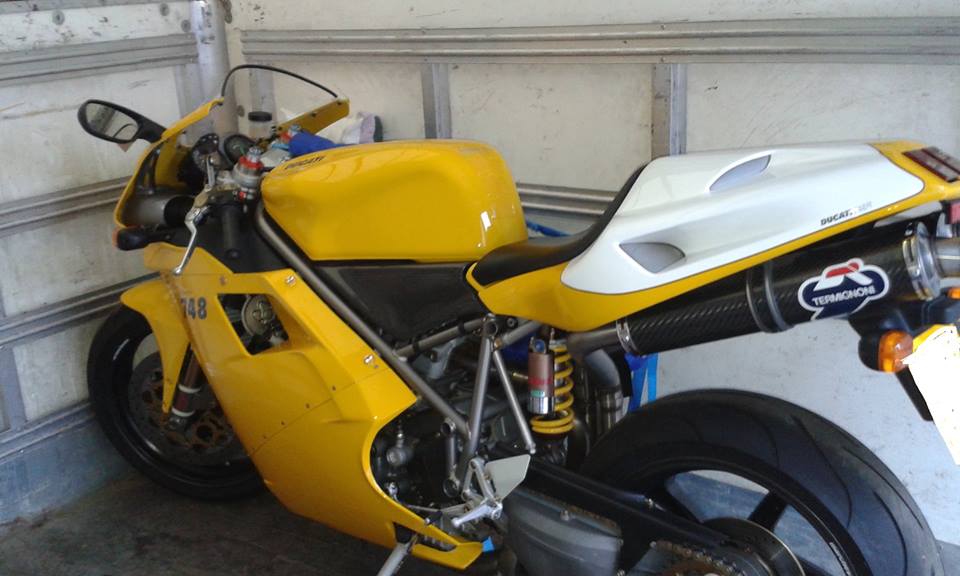

  13. pics:Happy:
  14. Not always she won't, not if it means her getting the sack :Wideyed:
  15. Looks clean, nice bike!
  16. Bitch!
  17. It depends on how noisy they are and what your local MOT place is like. I never have any trouble with any of my bikes come MOT time and they all have Termignoni's on.
  18. Probably just an advisory on the pipes.
  19. My 916 wears 50's and all i get is an advisory. My 1198 wears 70's and that too gets an advisory despite sounding like the apocolypse. You should be fine. Nice bike btw. :upyeah:
