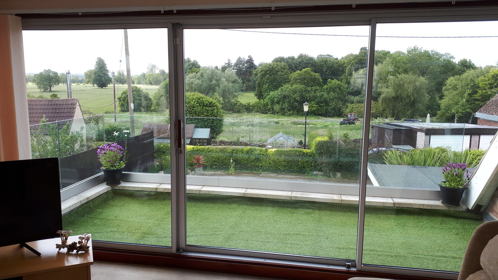

  1. Replacement of this is moving towards the top of the home improvement list if Finances permit.
    It's an Everest unit and well past its best. Probably dates from when the house was built in 1970!

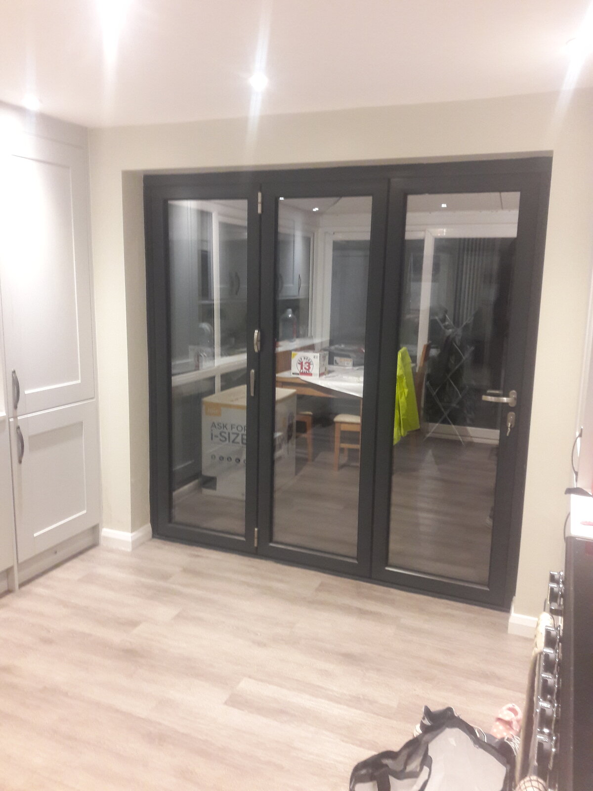

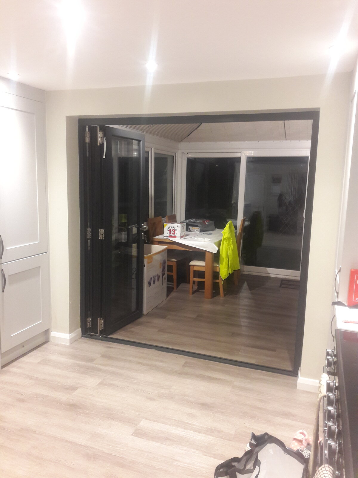

  2. bi folds would look great in that space, ive just had some fitted in my kitchen , really open the space up.
  3. Not as big as your doors but you get the idea
