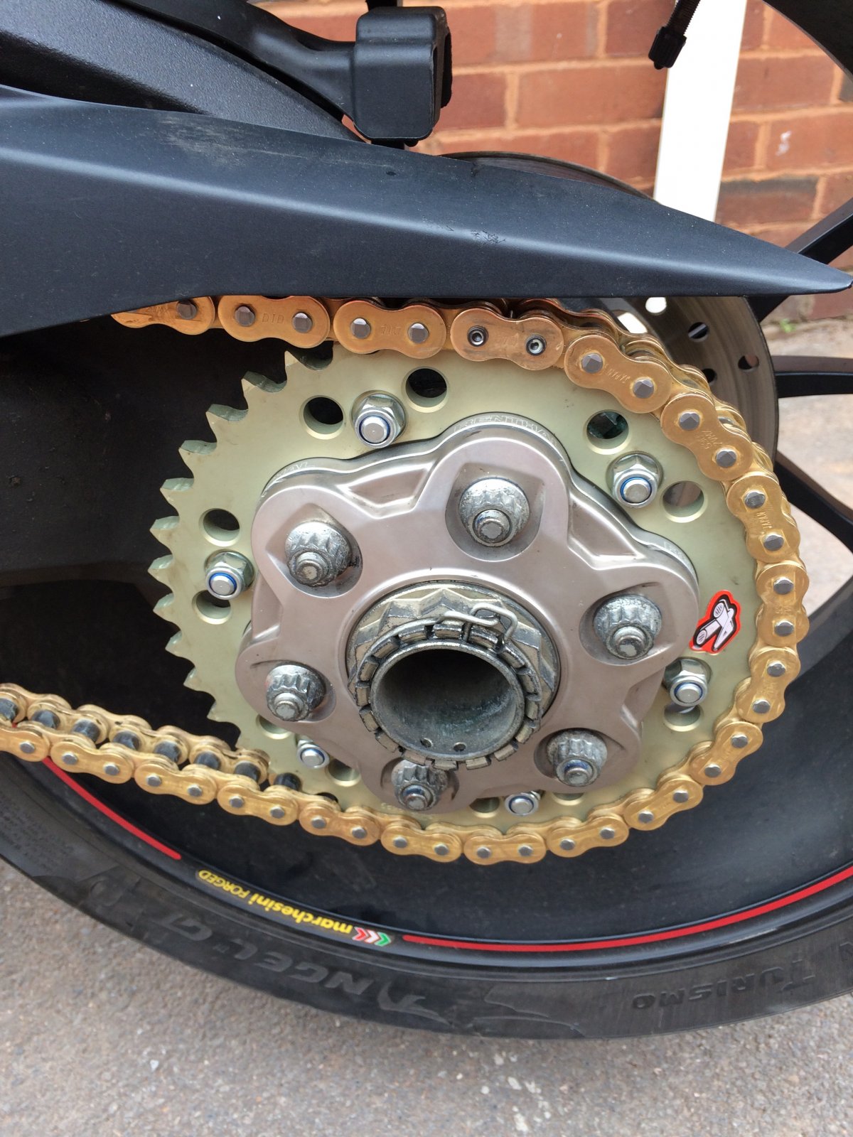

  3. Thanks very much, all done, test ride tomorrow!
  4. Hopefully pics!

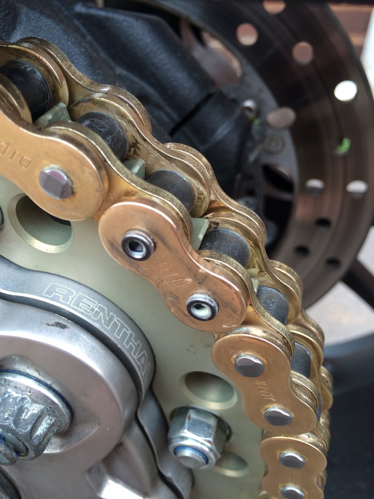

  5. Clarkey, you've got the chain on upside down, the writing's the wrong way round on the top run , nice looking chain though.
  6. I did wonder cos if yuk look at the first pic just where the chain exits the plastic chain guard it's the right way up!
    Do they alternate?
    At the time I was more worried about flaring the rivet pins correctly and not overdoing it creating a tight spot.
  7. When I've replaced chains before, they've had spacers to place between the plates so that you couldn't over tighten. Roughly how much for chain and sprocket and did you replace the front one as well ?
  8. Ah right, no spacers in the chain kit or chain riveting tool.

  9. I also bought the chain splitting/riveting tool as I didn't have one.
