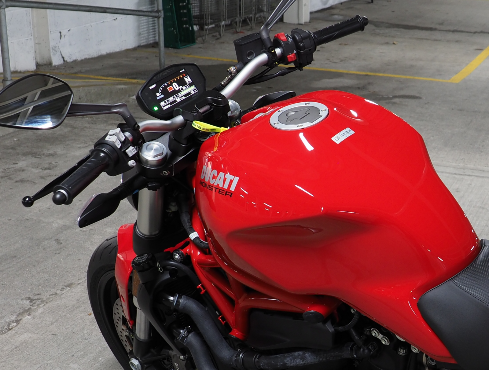

  5. Excuse me coming in on your thread but it has got me thinking......
    I have just bought a new Monster 821 and it does not appear to have a lacquer coat over the decals on the tank. You can feel the pointy edges of the letters that catch the micro fiber cloth as you wipe it over.
    Has someone forgotten to lacquer the tank or are they all like that ?
  6. I’m not 100% for your model, but certain 899’s didn’t get Lacquer
  7. All the red 'lower' end Panigales and Monsters don't get paint lacquer (don't know about Hypers and Multis) and it's a real issue for me and I refuse to buy one. The matt paint jobs sort of get lacquered as that's how they get the matt effect, which is why I went for the Corse.

  10. I've just bought a new Monster 821, its no lacquered either.
