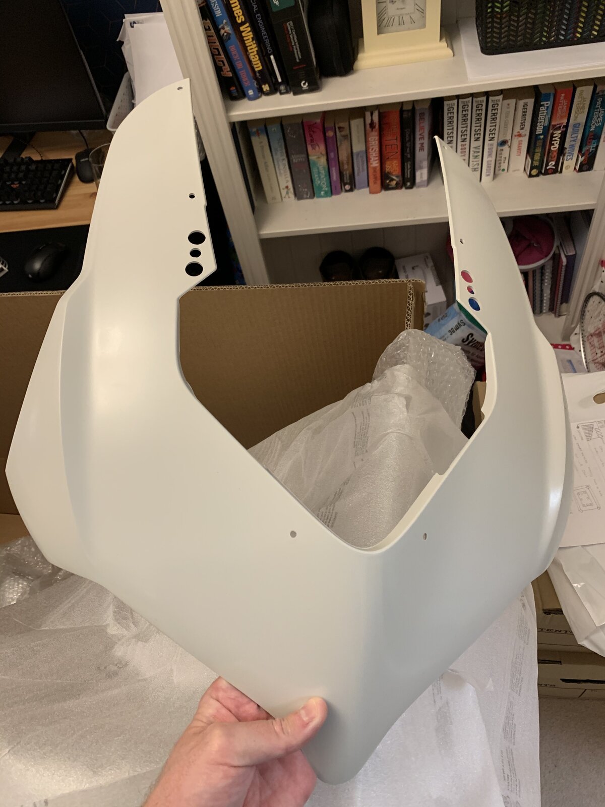

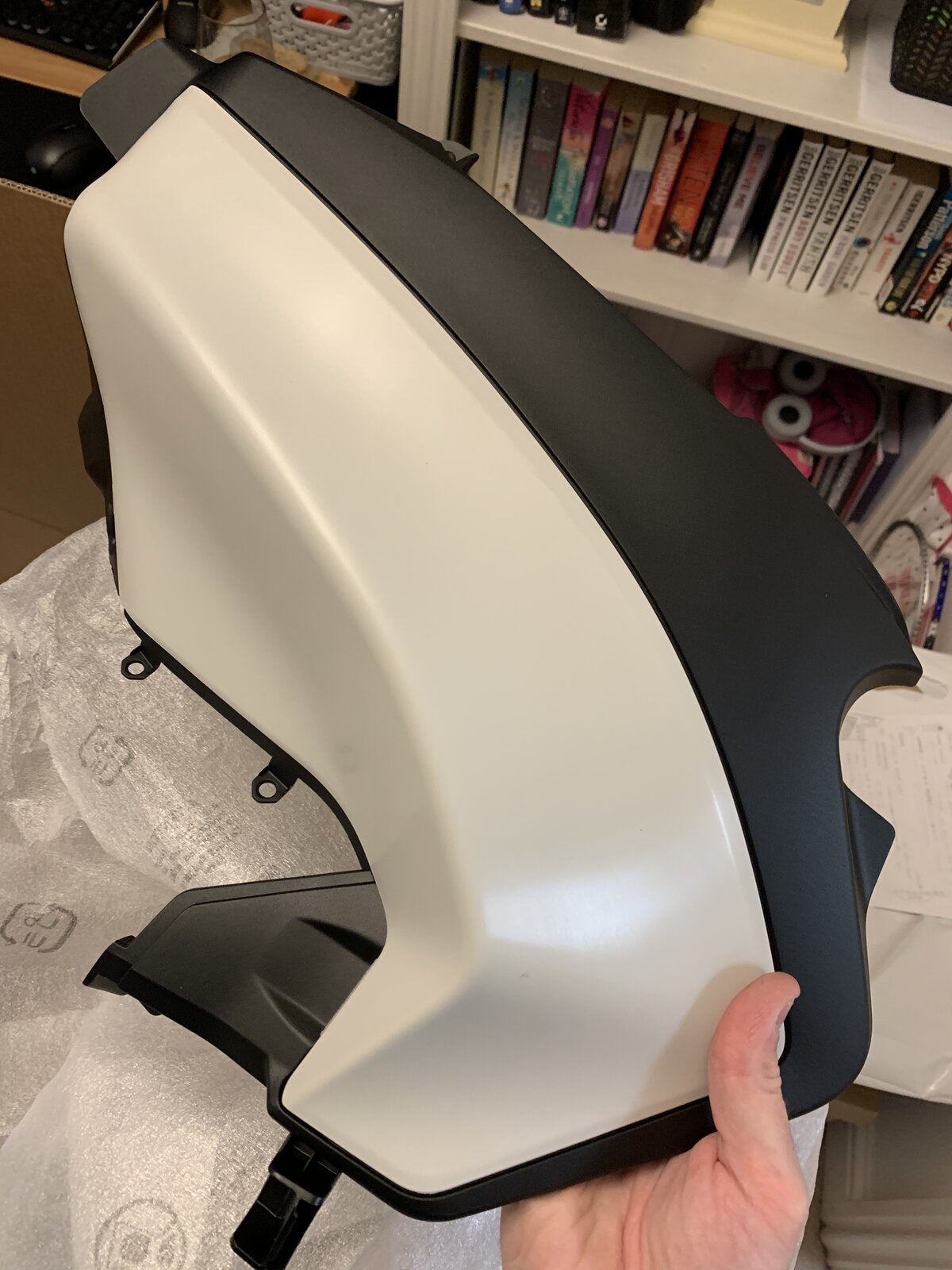

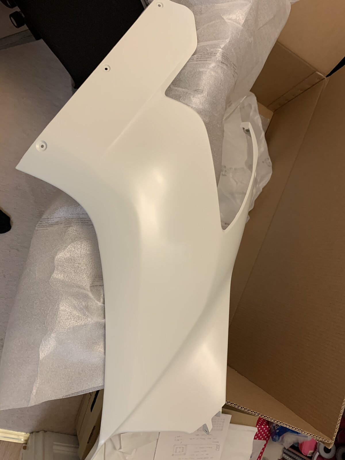

    After some advice, I’ve got the official Ducati track fairing kit and they come unpainted but sort of feel like they have some sort of coating. Can I prime straight onto them after a degrease or do I need to run them down before priming? I’m spraying with cans, but I’ve seen a lot of varied info, some even suggest you can just spray straight with top coat? Here’s some pics of them....
  2. Clean dry environment. Scottish them up a bit. Panel wipe them. Prime. Spray. Lacquer.

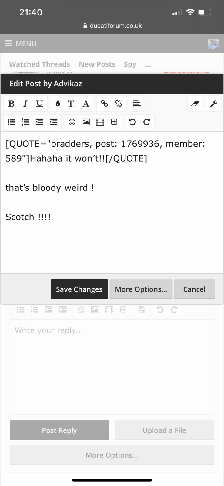

  14. It has something to do with the forum itself bud it won’t let you post Sco tch without auto correcting to Scottish. Must be something historic?
  15. Scottish test
  16. Hahaha it won’t!!
  17. that’s bloody weird !
    Scottish !!!!
