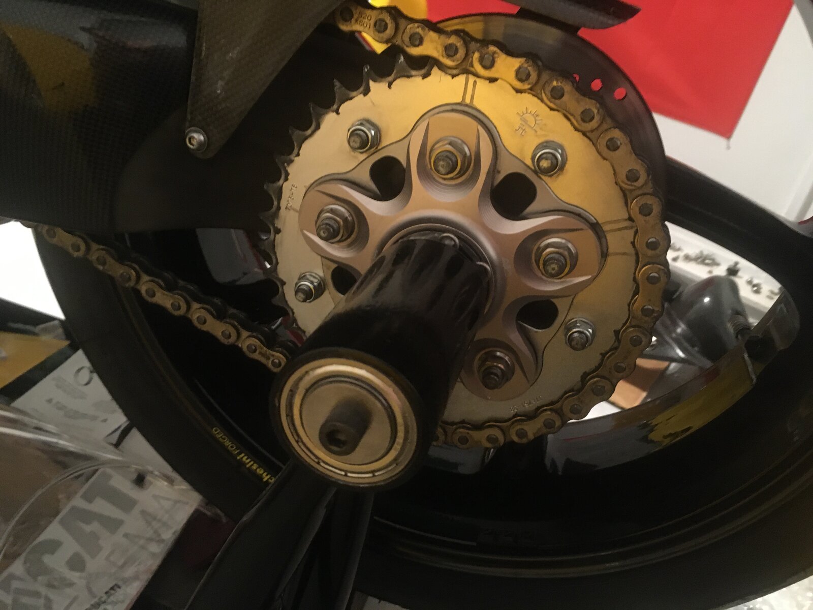

  5. I have the AEM sprocket carrier in the titanium colour you are looking at...I had to upgrade to the conical spacer, so it will fit the newer models with existing conical spacers 133B23E6-5E56-4A24-8AFD-9D0957E57F4E.jpeg
  6. Thanks Chris , looks stunning
    I took a chance and ordered the titanium , think the silver will stand out too much , but I ordered the other design.
    I have got the uprated conical spacer , good to know it will fit!

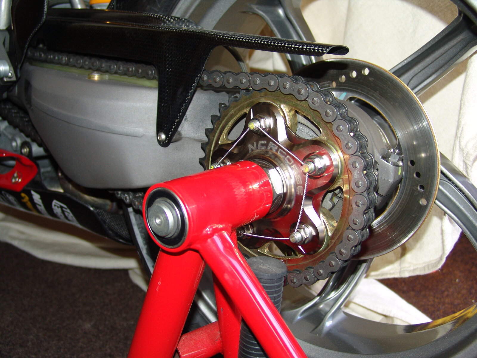

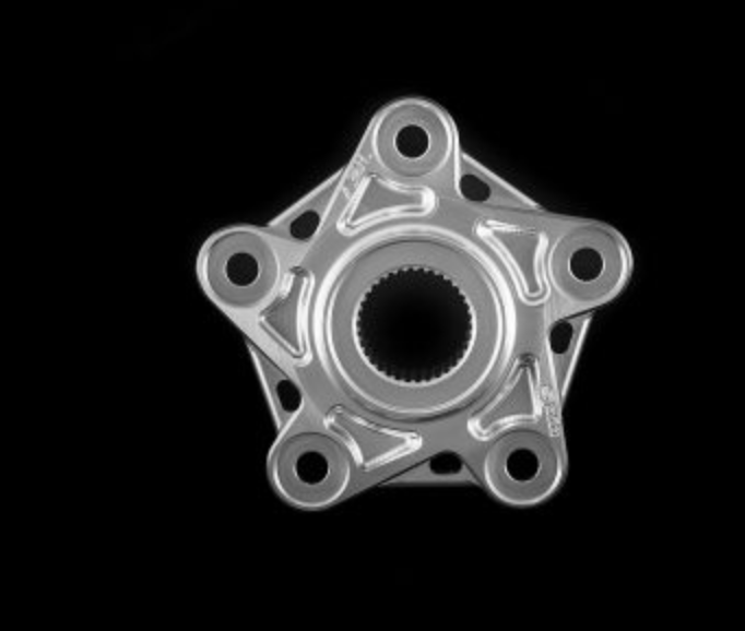

  8. Nice
    Titanium, bit too pricey for me
  9. Its ally and it wasn,t expensive, look on their web site.
