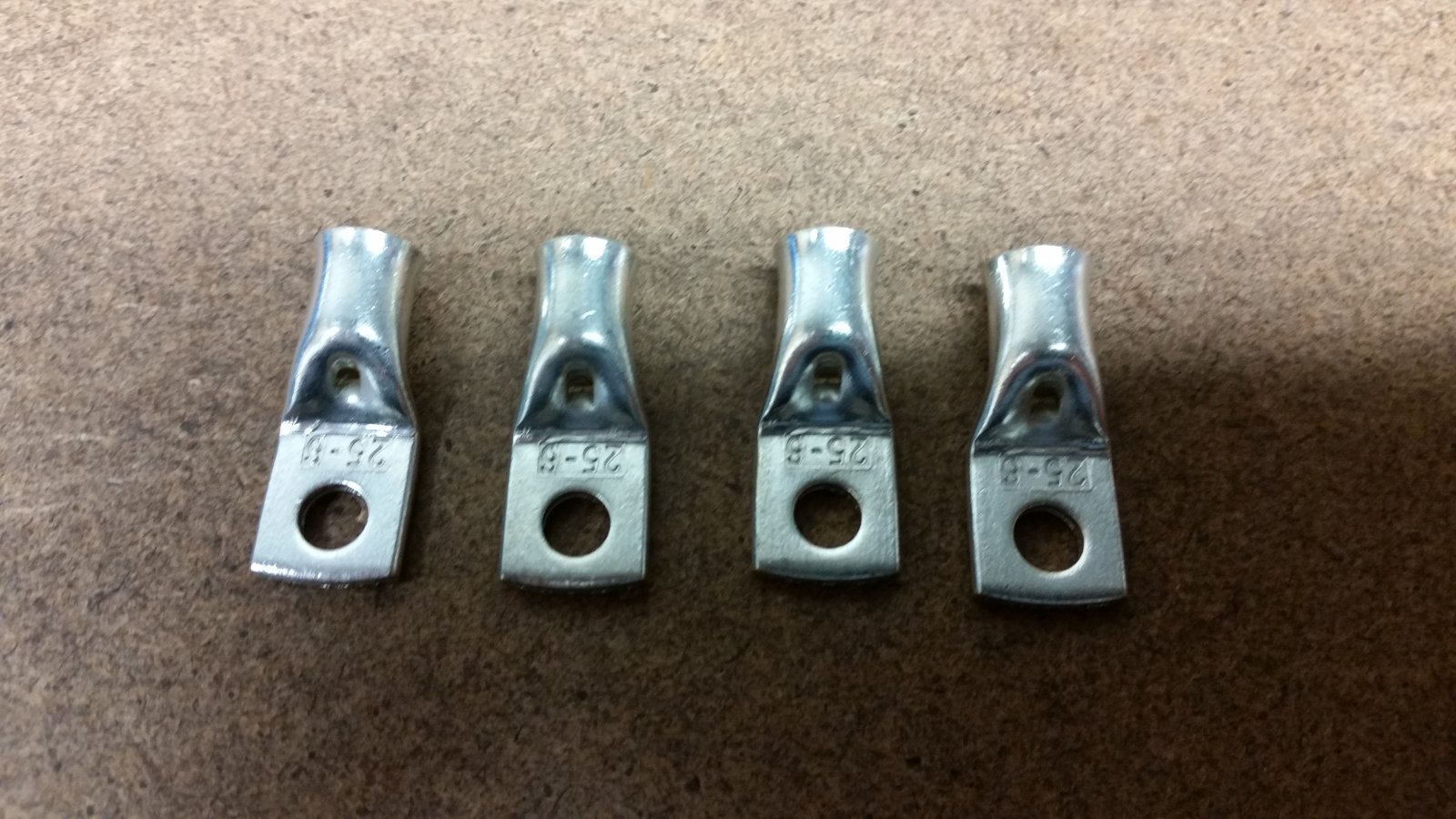

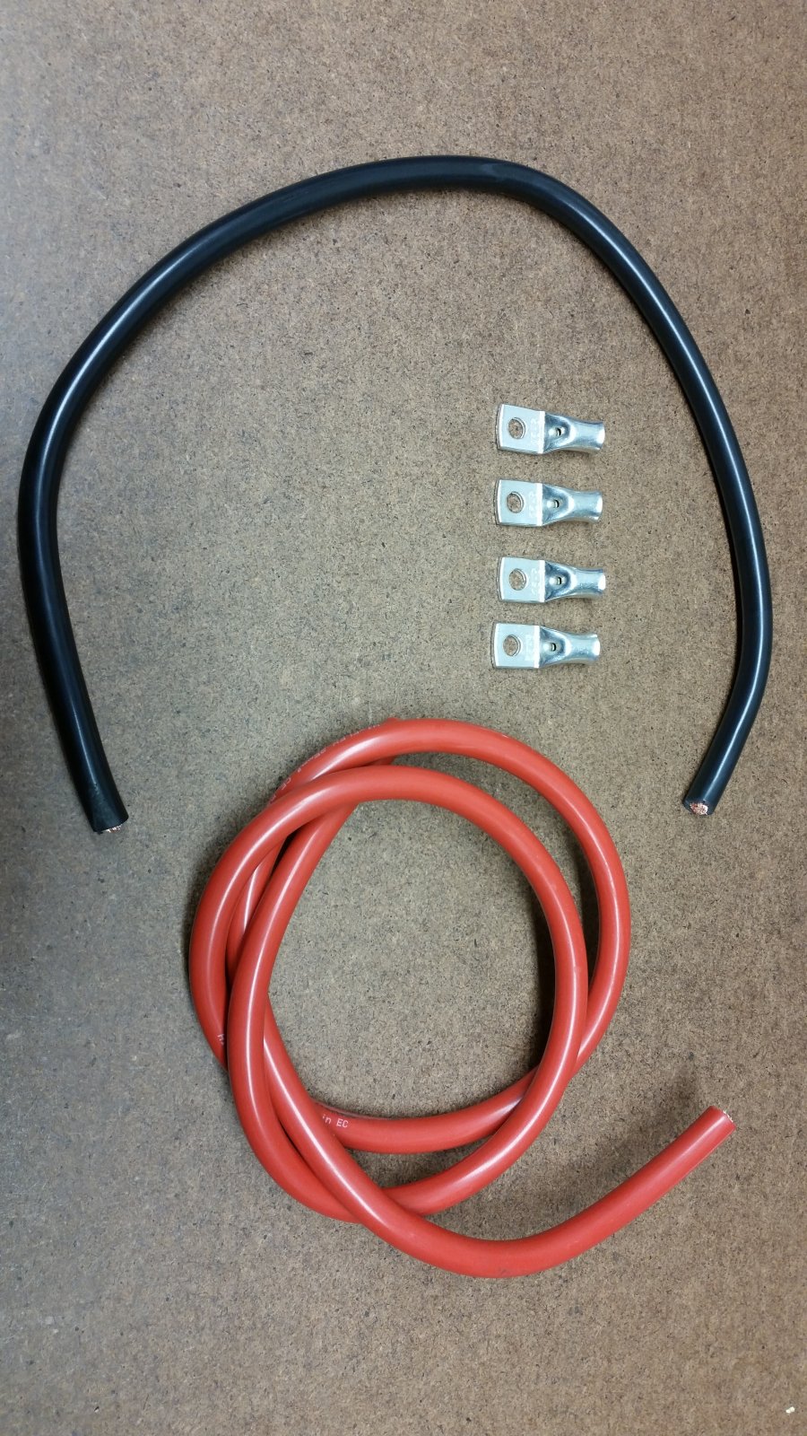

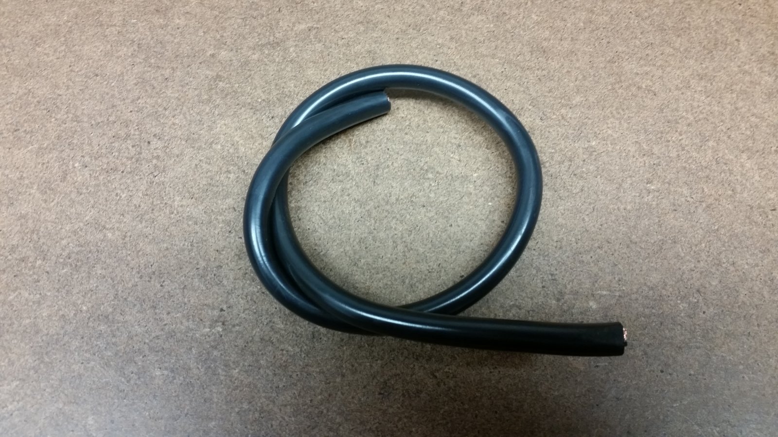

  1. So I fitted a lithium battery to the 749 when i got it poor caranking from standard battery and now I have purchased the bits I need to make my own upgrade kit some more angled connectors to come and I am away.

  8. OK no problem for Exige from me this is one kit just for me.
    I fix motorcycles for a living and have alot of experience of batteries and reg/recs etc and Ducati ,Honda and Aprilia all have issues due to original wiring and reg/rec probs what exige is doing is good for owners that want a good kit at good money .But I have access to the materials and will make my own for my bike only.
