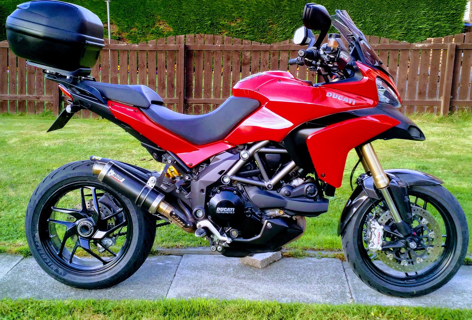

  13. Got the mivv system (de-cat) fitted to mine, been told it looks good and sounds good, bike runs sweet without a re-map and is showing 147bhp on two different Dyno's. IMG_20180806_200119~3.jpg
  14. That looks really good!!
  15. just not sure of the looks of the double barrel end can for the enduro yet its way cheap and noisy! ;-)
