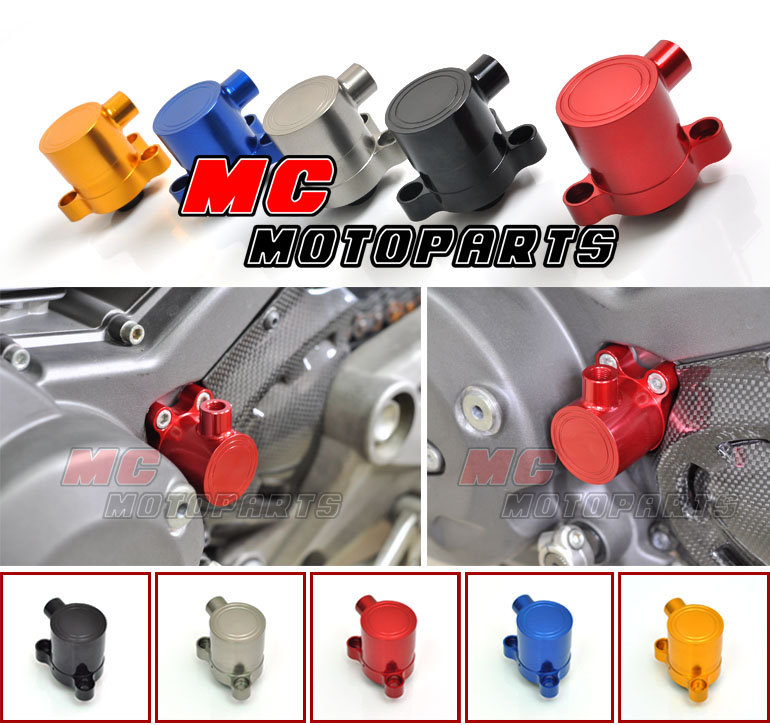

  1. Hey all
    I just identified the source of a small leak coming from the clutch slave. Always wanted to reduce the pressure of the clutch lever as after a bit of town riding my hand is killing me.
    Looked on eBay for the seal kit and realised that some of the after market slaves reduce the pressure and aren't too much more expensive than a seal kit. What are people's thoughts / experience with changing it?
    Looking at this one if anyone has had any experience with the company. http://pages.ebay.com/link/?nav=item.view&alt=web&id=201087661526&globalID=EBAY-GB
    As always any advice welcome.
    Cheers Dave

  10. I have used slave cylinders from three different manufacturers including Oberon and also MC Moto along with a German company, MPL, that used to advertise billet parts on eBay including slave cylinders that were of very high quality.
    So far I have found it difficult to tell the difference in pure use terms between any of them.
    I have found the quality of MC Moto parts to be surprisingly good despite them coming from Hong Kong and being very cheap. I have bought several sets of levers from them, all having been proved to be very good and well made. They did send me a set of levers once with the wrong colour adjusters, an email soon had a set of the correct ones on their way to me free of charge.
    If you want proven quality and reliability from a UK company then Oberon are the way to go, but don't underestimate some of the cheaper options as they too can be just as comparable. Personally I wouldn't rule out MC Moto in particular.

  12. Have Oberon slave on my 749, but fitted an MC moto to a mates bike and its no different from the Oberon tbh.
    If I'd have known about MC I would have gladly bought one, If I need a clutch slave in future I will be getting an MC.
    Look at the Avanti Race Parts and the MC Motoparts.. They're remarkably similar.
    wont let me link to the image so here is the page
    Online Shop (Clutch Parts) - Avanti Race Parts - Ducati Parts and Accessories for Road and Race Motorcycles. Services for Ducati Motorcycles. Race prep, Paintwork, ECU Repairs, Anodising and more!

  15. I've had an MC Motoparts slave cylinder on my 1198 for about 8k miles, no problems at all.
    maybe i've been lucky, but the main reason I bought it was because it has the biggest piston I could find so less effort to pull the lever (but longer travel).
