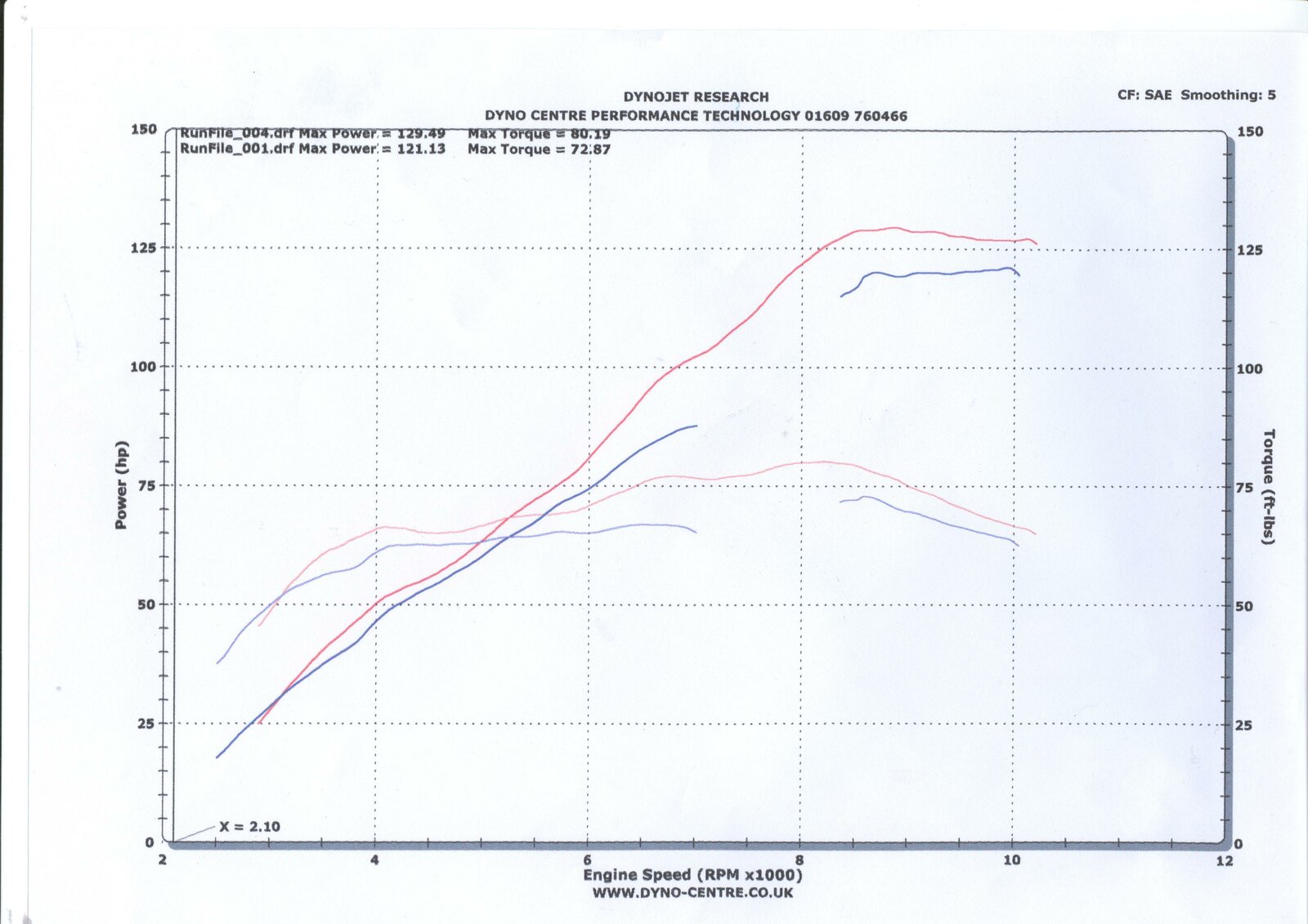

  11. I had an 'over the injectors' filter fitted years ago. While it was on a dyno, the dyno guy said how crap they were so we did back to back runs with and without the filter. I seem to remember a gain of about 8 bhp with the filter removed.
    Needless to say it wasn't refitted, and I used the type that are fitted to the air box where the runners enter.
    Theory is that the filter disturbs the air flow as mentioned earlier and reduces the air box volume.
    On the flip side if you crash and loosen the tank, then this type of filter will stop crap going into the engine.

  15. No surprise and a predictable result unless the two set ups are fully mapped separately they are not comparable. I have to say the results on my 748 don't support the loss of power argument unless we are talking maybe 1 bhp on a fully mapped set up. I would prefer the ones that fit over the airbox holes as it looks to be the best set up - its also the most expensive.
  16. Here are the before and after graphs from a 996SPS. We had been working on the engine before removing the filter, you can see what happened when it was taken out....It is now running 150 rwhp with filters in the air tubes. dyno.JPG
