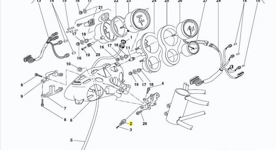

    Does anybody have a picture showing where the air temp sensor is mounted please, I know it's just under the nose one but just can't see where it actually mounts ( rebuilding a front end so nothing to copy)
    Thanks in advance.

  5. The 998 uses an air pressure sensor and does not have an air temperature sensor like the 748-9*6 models. It screws to the bottom headlight bracket
  6. Hi Tony hope your well, how's my old SPS ?
    Thanks for this appreciate it

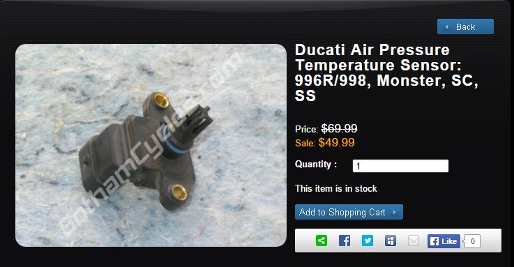

  7. The above are incorrect as they are for 748 -9*6 models.
    The pressure sensor looks like the one below.
  8. Hi Paul,
    SPS still good and still going strong. Hope you get the 998 sorted.
  9. I wonder which car they are from as they will be cheaper :Happy: they might have a part number stamped on them.
  10. Here's a clearer picture of you click on the thumb nail
    PRT05/A sensor
  11. Sooner dooper thanks, looks like a 999 one but now I know, cheers fella.
