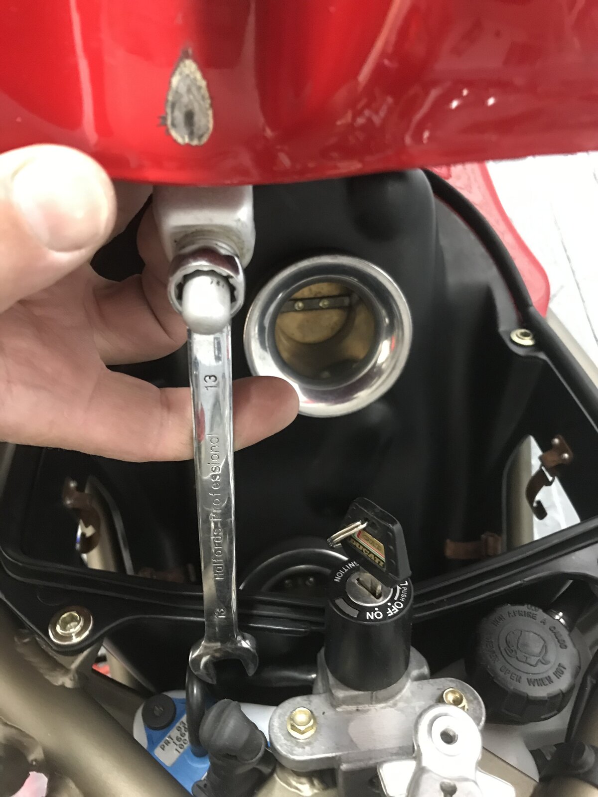

  9. Just bringing this problem up again, my 916 airbox seal to tank is doing the same thing. The new rubber seal is holding the tank up a fair bit. Some have suggested bending the front locating pin but I’m not sure I can do this with out damaging the soft alloy pin .
    Should the tank sit on the two rubber covered bolts at the front which secure the airbox as mine is sitting quite a few mm above them. If only I could get my hands on the older version rubber seal.
  10. Yep, a bit of a trade off… with the older seal, the tank would sit better but there were too many gaps letting un filtered air straight into the airbox. The new seal will fit right but just needs a bit of persuasion. Iirc, my tank didn’t sit on the grommets with the thicker seal.
  11. C19BCD62-2841-48BF-BBC4-45BA5DD71562.jpeg I use a 13mm ring spanner over the pin to adjust to sit correctly. The pin and bracket are soft and malleable. Good time to check bracket bolts aren’t loose and locktite them in place.

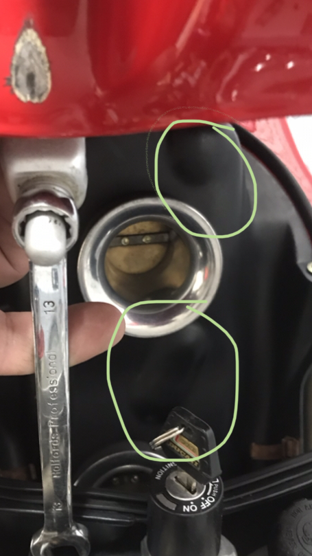

  12. Have a look if you’ve got the early 94 airbox as well. See the 2 lumps circled. 2C2801A2-94AB-4334-B2A4-FDECDA9BCDAE.jpeg
  13. Right I’ll give the pin and spanner trick a go and will locktite the two little bolts, good tip fellas. And yes Chris it’s the early airbox which is on her. If this doesn’t work I’m going to take the bloody seal off and I’ve a landrover defender seal which I think will be soft enough to use.
