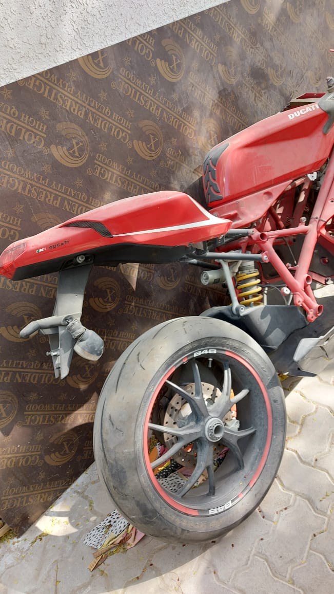

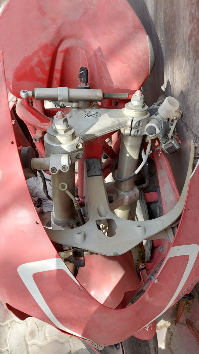

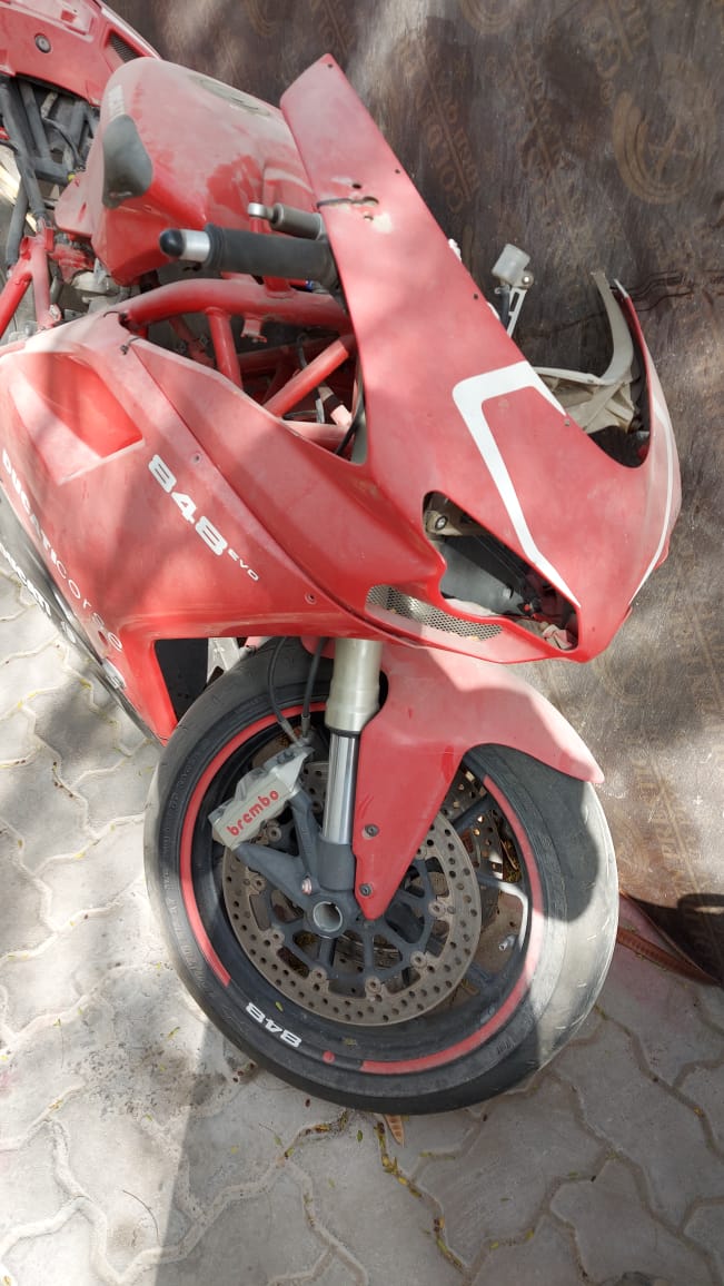

  13. cheers. people keep asking me why i don't just buy a replacement 848 motor, but that's no fun...
    here's the bare bones. is it possible to tell what year from the pics? i won;t be home for another couple of weeks to get the frame no.
    8a8f585d-0f56-4453-b942-5b6440bece21.JPG 8a8f585d-0f56-4453-b942-5b6440bece21.JPG 45c9d05d-cbd3-436f-b937-4eef0ae4dd84.JPG 1714cad8-9b44-4f9a-a750-3f1f81f3138f.JPG 10d58203-8508-4278-8c7f-197d0212d81a.JPG
  14. looks like it could be a later evo chassis they are m4 calipers
  15. Looks like its just being dug out of a sand dune :)
  16. Evo. 2010 onwards iirc. It has a steering damper as standard, the older 848 you had to buy a clamp to fit one
  17. Close! It was mounted on the wall of a bike dealer in Dubai for several years. It was bought by one of my customers to rob for engine spares when his race bike went pop, with the rest sold on to me.
    Great news on the calipers and steering damper mount, saves some spend. Trying not to get carried away, as much standard equipment as poss that can be stripped and rebuilt is good enough for now, I want to be out on it next season [October].
