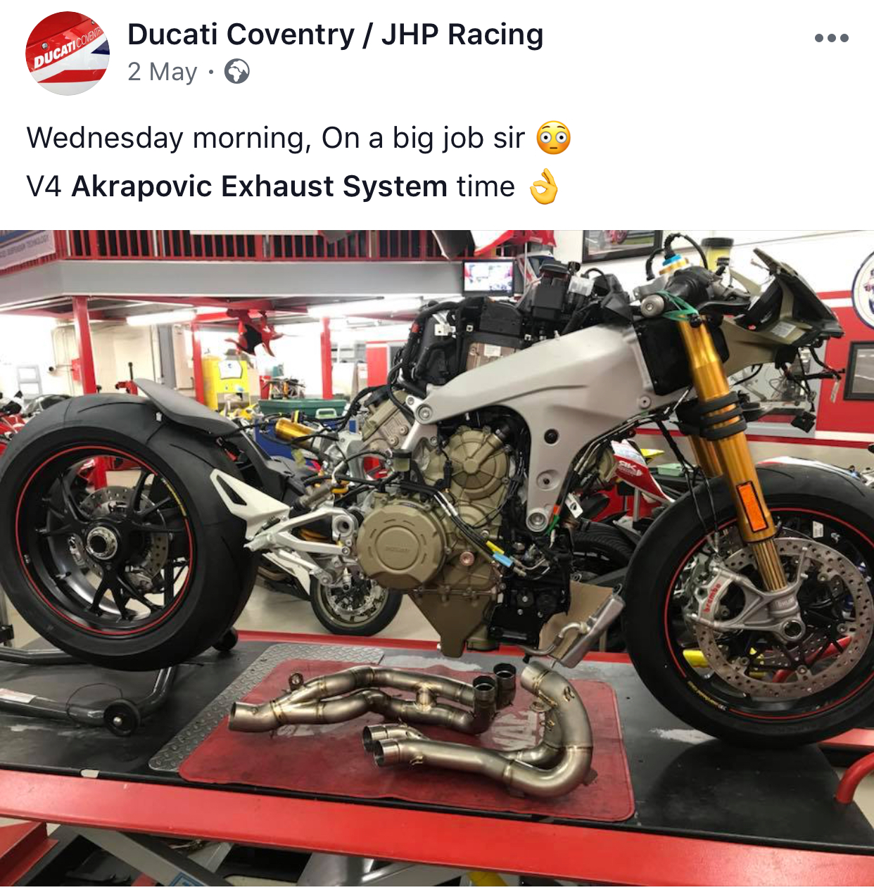

  1. I'm sure when I was at Italia last month and had a peek at the 3 x Speciale's they had in they quoted 9 hours fitting time for the full system though which would go some way to explaining the differences in price would it not?

  3. Have you seen how much of the bike comes off to fit it though?

  5. Memory tells me at launch, the rrp for the full system was £4700 inc vat. The small print in the link you posted is very important. Only an authorised dealer (or workshop) has access to the ecu mapping activation code from Ducati which is also the case if you want to sell your full system at a later date. @bradders, the first system to be fitted by our workshop took 10 hours. Fitting the race exhaust was not covered in the initial factory training delivered in January and February this year. With practice that time has been reduced but not significantly, it is a time consuming job. I fear UK V4 owners who buy their full system cheaper from Europe will get very irate if as I believe, their local authorised UK Ducati dealer/workshop might decline to fit it. I would certainly talk to your workshop manager before hitting that buy now button. Andy

  11. Panels off, tank off, subframe off, all of the disconnections to take all of those off.... that is easily an hours work before you even get at the exhaust. Then fit and align that, put everything back together (always slower than taking it apart), and then upload the software and I would assume a quite test ride. Even if you were blasting through that yourself without a care to making sure it was done properly and nothing was damaged, it is a half a day gone.
    That is a race bike. Not only does it have a lot less in the way of fixtures and fittings and wiring, a lot of bits will have been designed with better access. Quite apart from that, I wouldn’t want them tearing my bike apart in 15mins.
    The Panigales are an absolute pig to work on (I’ve half dissassembled 3). Because you don’t have a frame everything is in the way of everything else. Header bolts are a nightmare to get at (on mine the radiators also have to come off to get at the front one - add another hour to remove and reinstall that). It is not a bike that has been designed to work on at all, and the road bikes have looms and connectors to sensors everywhere. I have total sympathy for the Ducati mechanics on this one.

  15. So we have a V4 in the workshop for fitting the race exhaust. Process requires removal of the bodywork, rear sub frame, front wheel, both radiators, abs pump and emissions bottle before being able to get at the stock exhaust. Right or wrong, the narrow frontal design has resulted in everything being a tight fit. Andy

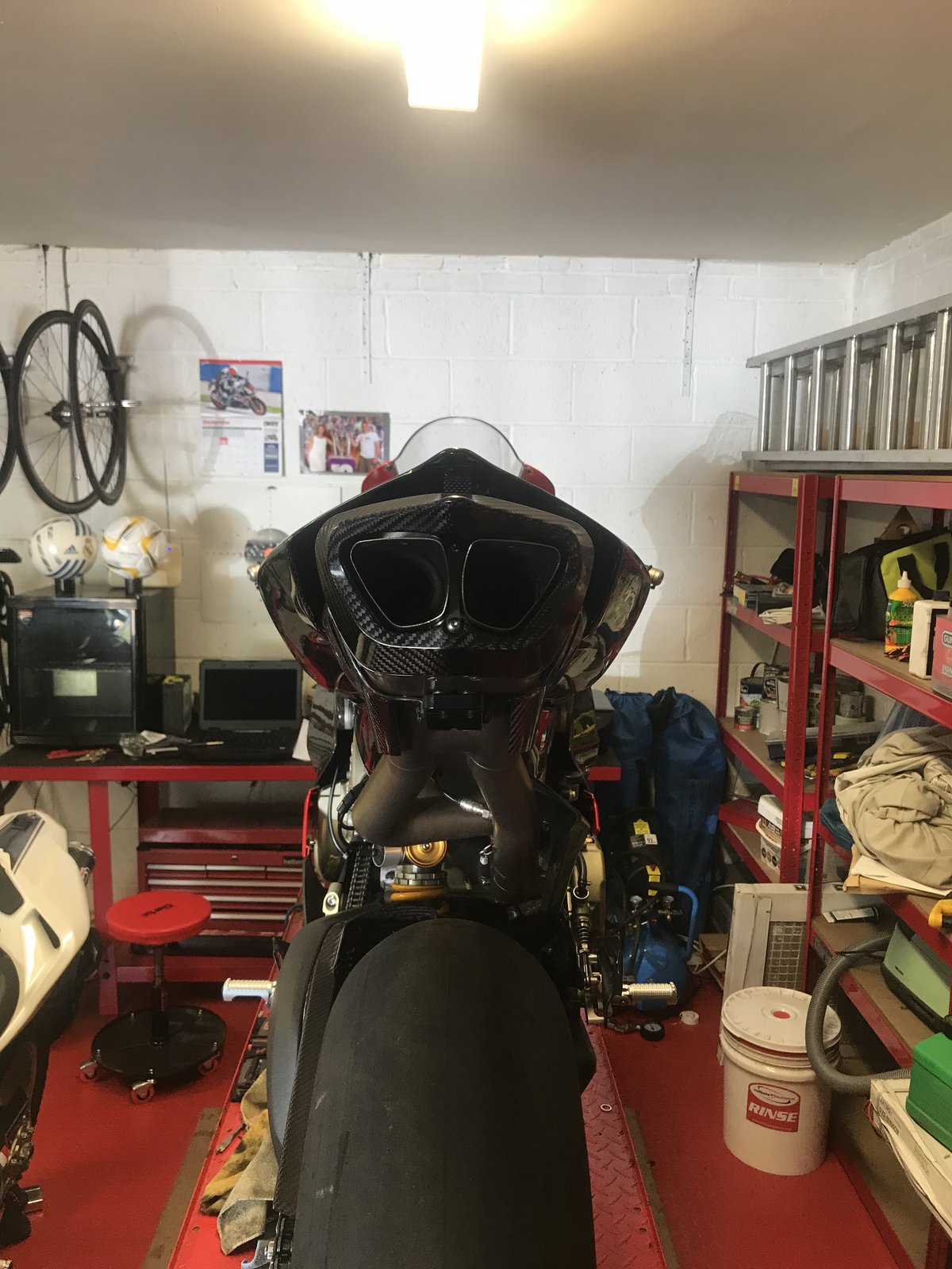

    Hello mate, forgot to post you this earlier. Just fitted the FullSix monocoque unit (big up to @nelly Cornerspeed) and it lines up pretty good. Looks the bollox in the flesh. Rather like me ;-)
