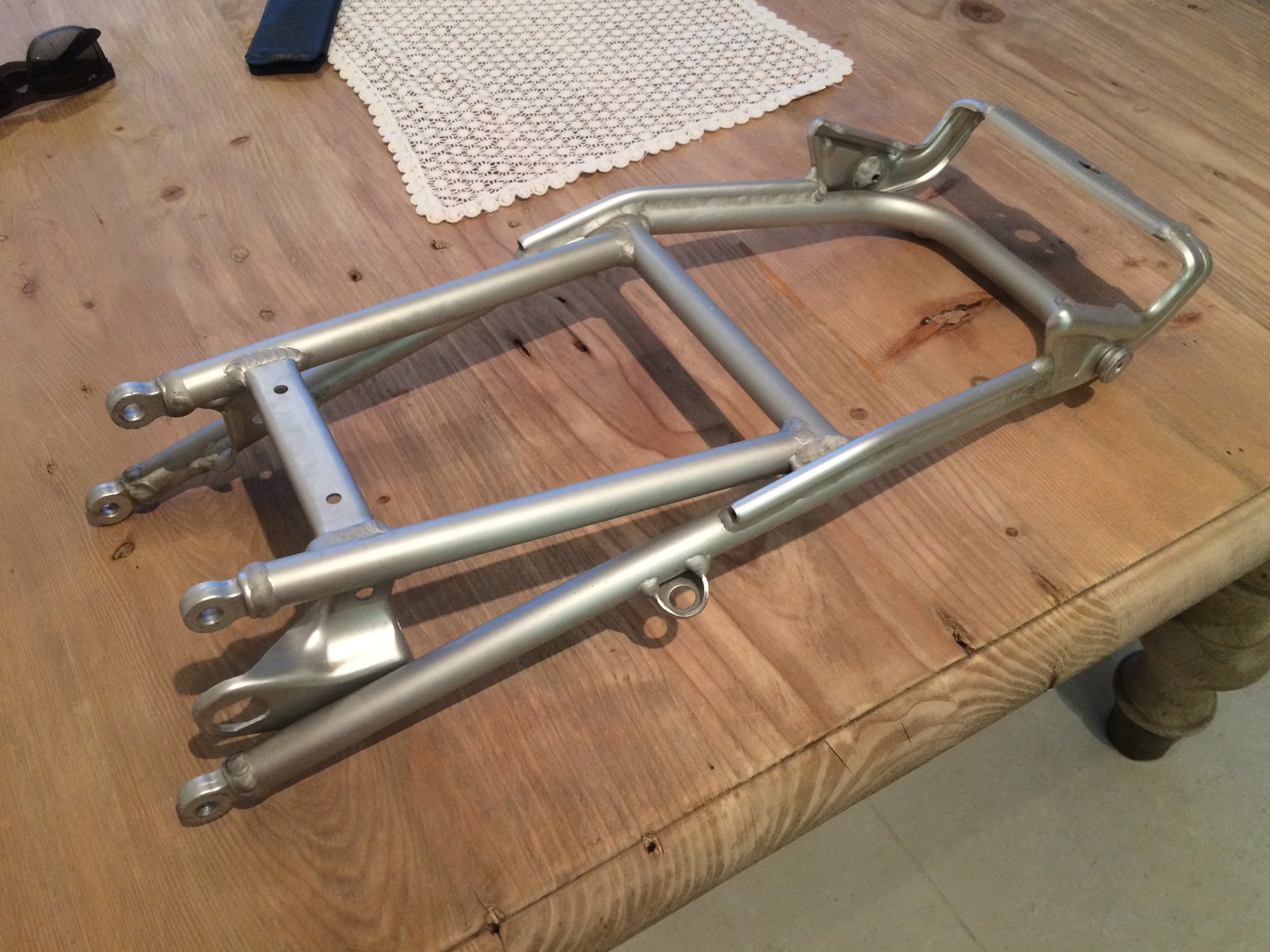

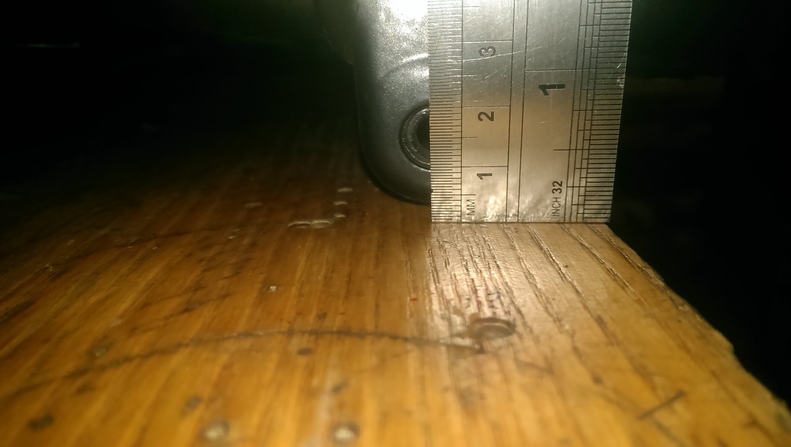

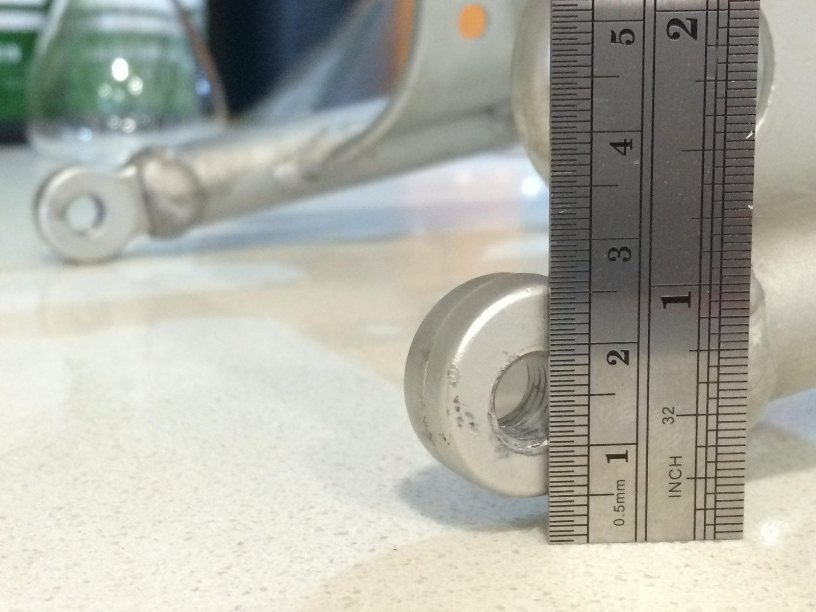

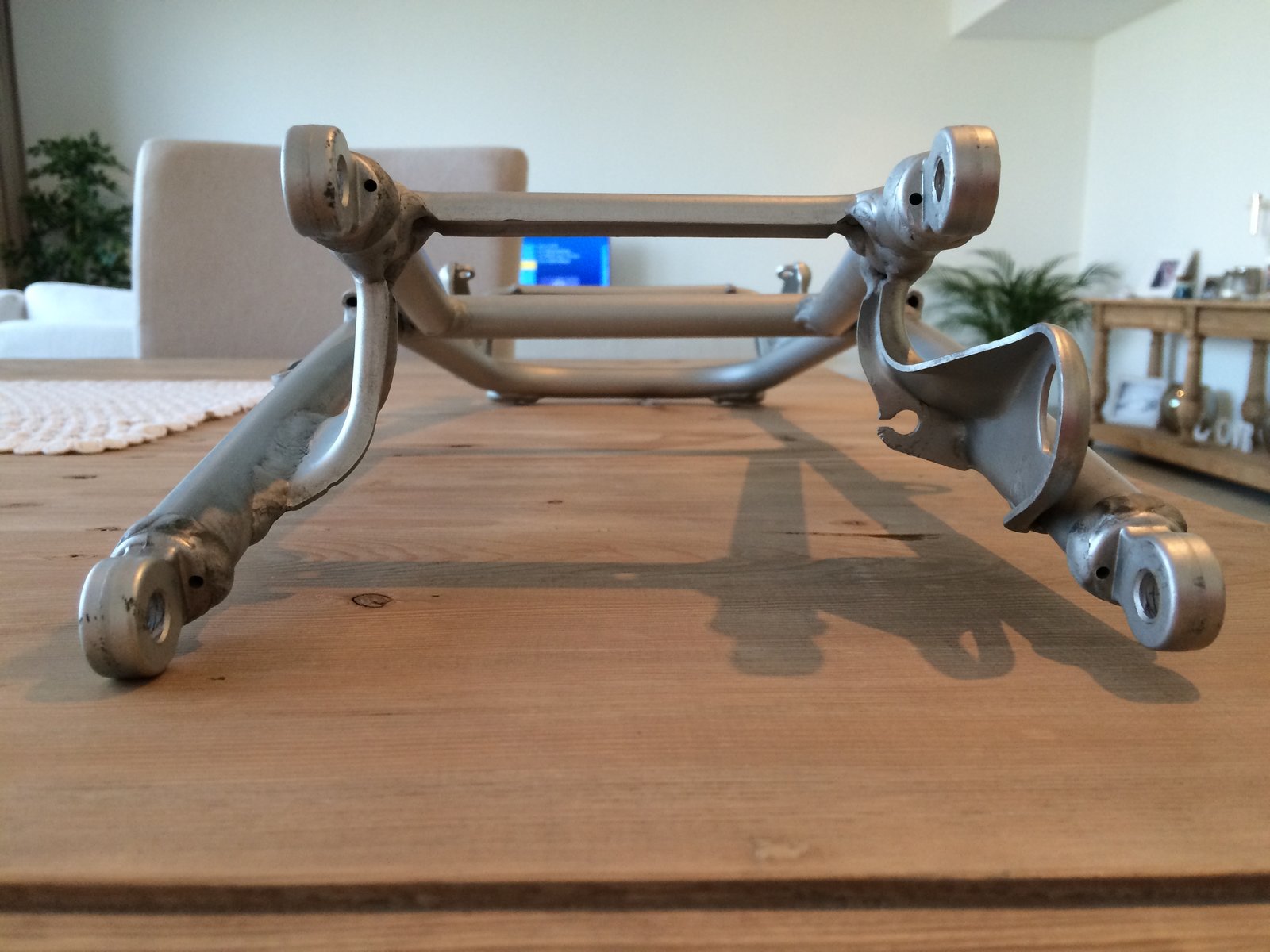

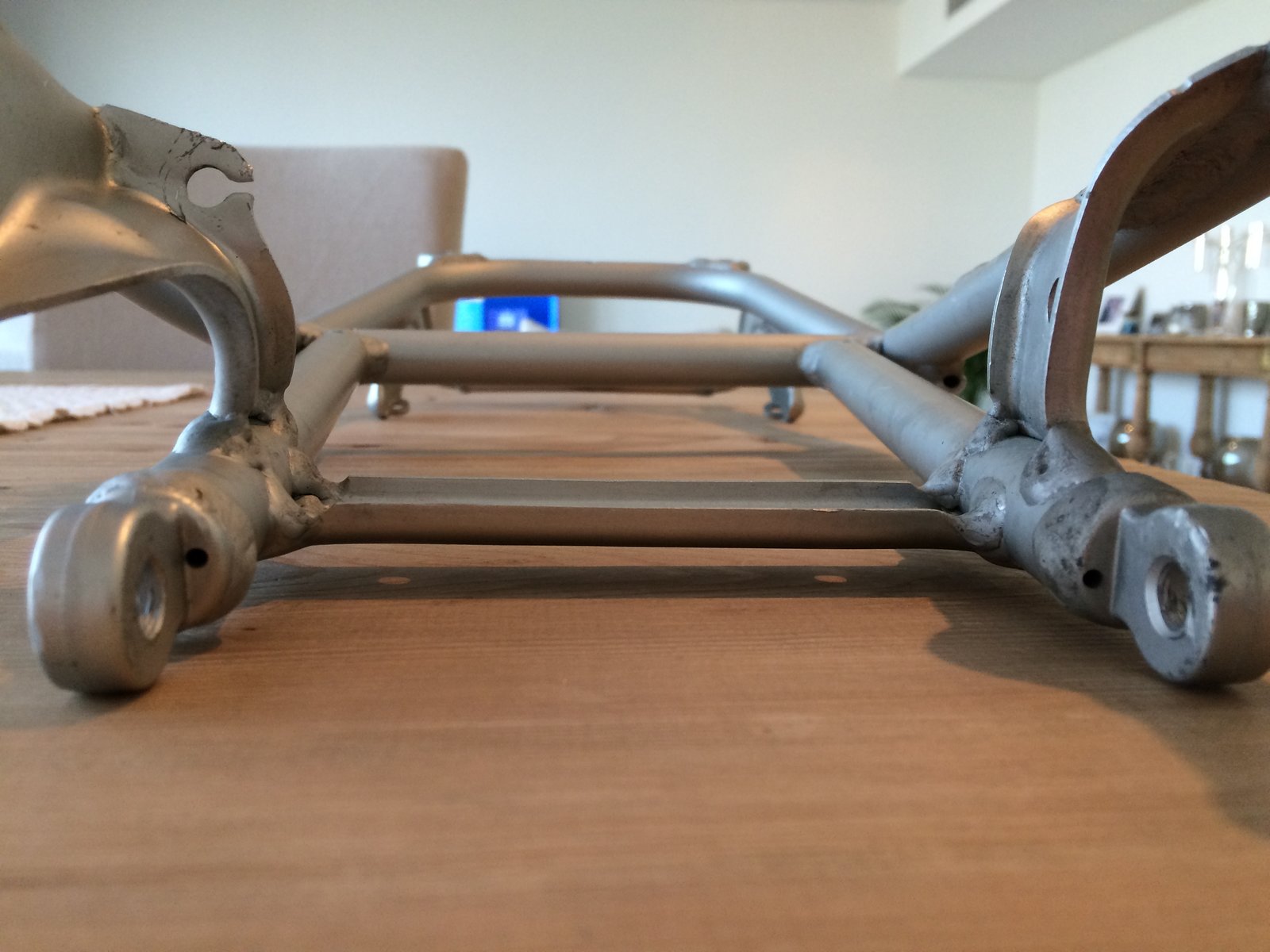

  11. Finally, I got around to looking at this again.
    So, hopefully the pictures explain all...
    When on it's back, completely level and does not rock at all. When on it's front there is a gap of about 4-5mm when it is level (with a spirit level) at the left side of the frame..
    I have to say, there appears to be no damage to the frame.
    So, what's the verdict. Have I been had, or is it ok?
