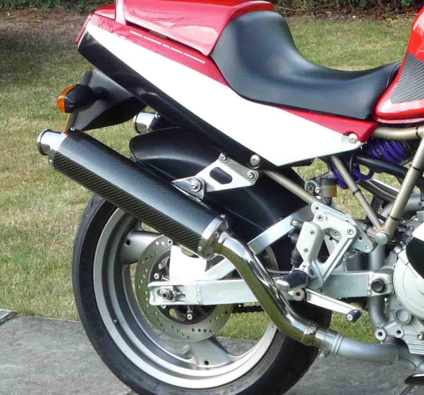

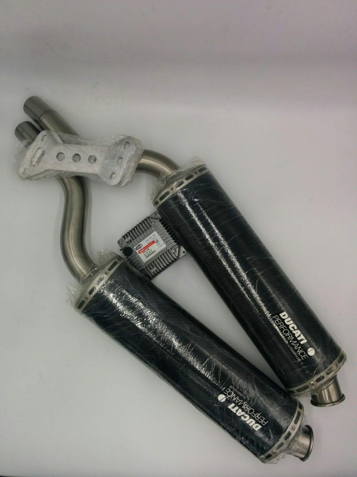

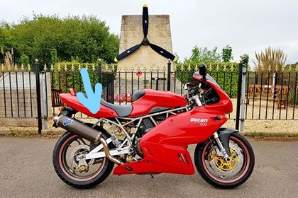

  1. Does anyone know if there are or ever seen an alternative to these hangers when using the exhaust cans in the pic below?
  2. Those are for the ie models- oval and different bends over the carbed.
    the hanger bolts straight onto hard points on the cans themselves so they never did A strap type hanger solution. Thats something you’d have to cobble together yourself.
  3. Thanks Sev.
    The LH hanger has cracked (again) from the oval cut out to the outside edge. Had it repaired a few times now but it always goes.
    Yeah, it's looking like a bit of cobbling might have to take place :laughing:

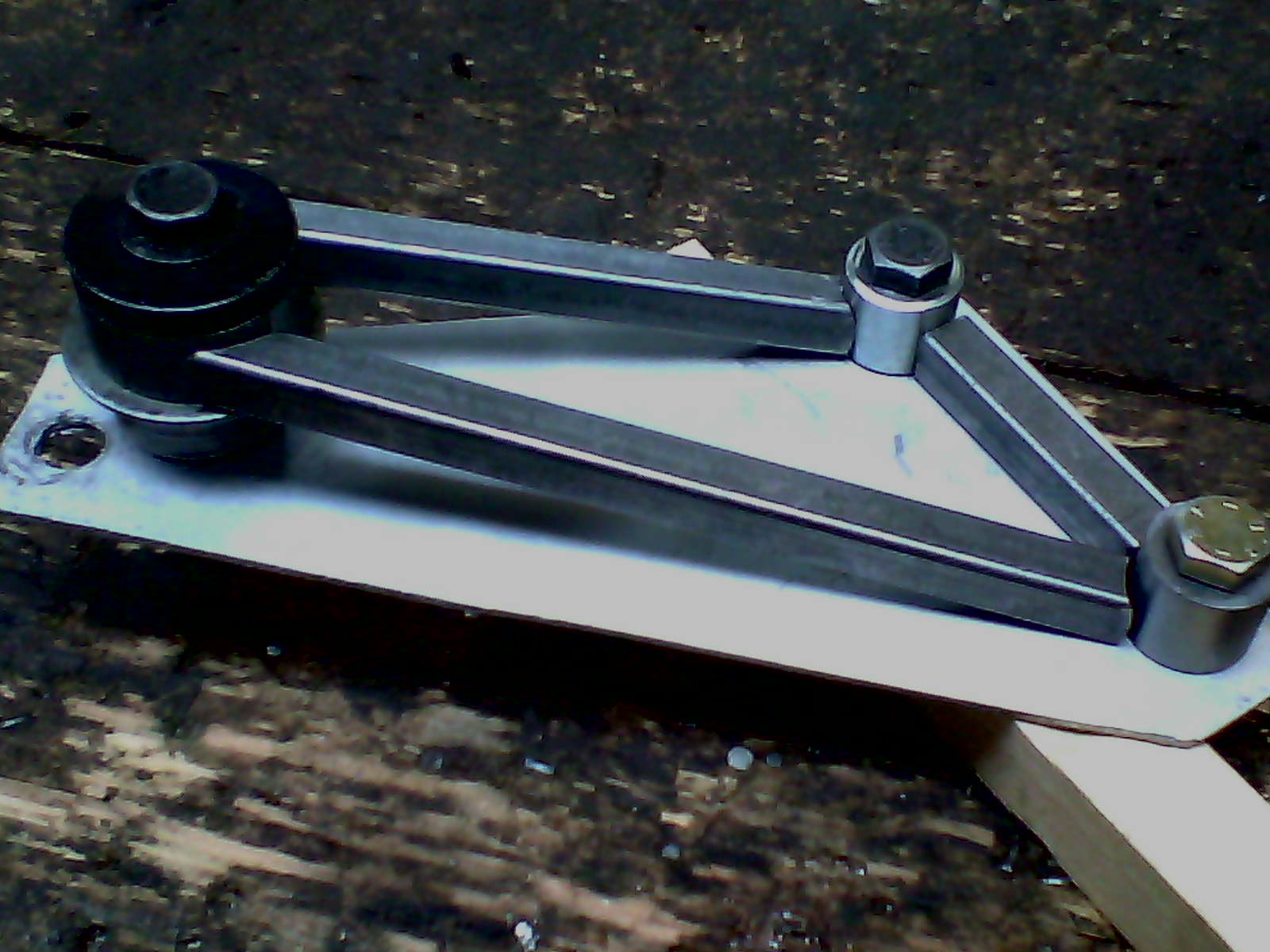

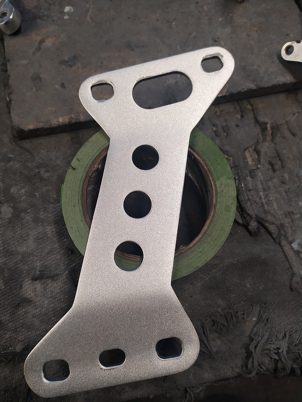

  5. I made some for my 900ie from some metal flat rods that were on a old topbox i had in the garage because mine just kept cracking.
    I know crap picture but they work a treat.
  6. Sev, yes, done a bit of searching and seen a few potential solutions.
    I seen these and asked the seller to measure them up to see if they fitted the mounts on the cans and they do.
    Halfway to a solution I suppose lol.

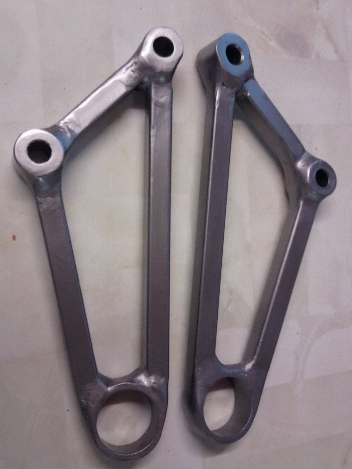

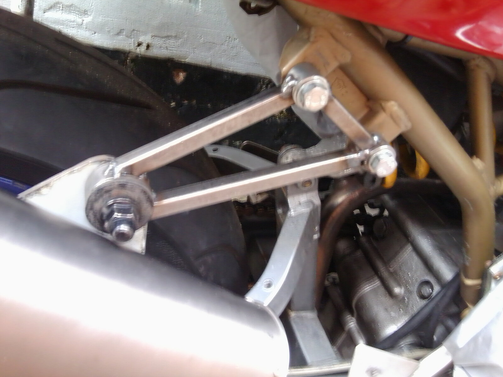

  7. the brackets on mine when i first got it were well not fit for purpose a piece of sheet ally bent all wrong which comes into the category of take someones tools away so ended making my own from scratch
  8. Abramo (desmo market) is a good guy. You’re in safe hands. :upyeah:
  9. Looks good johnboy, thanks for posting that up :upyeah:

  10. when i made mine i made a small jig to hold everything in place and used spacers to get the offset needed for clearance of the swingarm would post a pic but its not letting me at the moment

  12. ha finally let me upload a pic

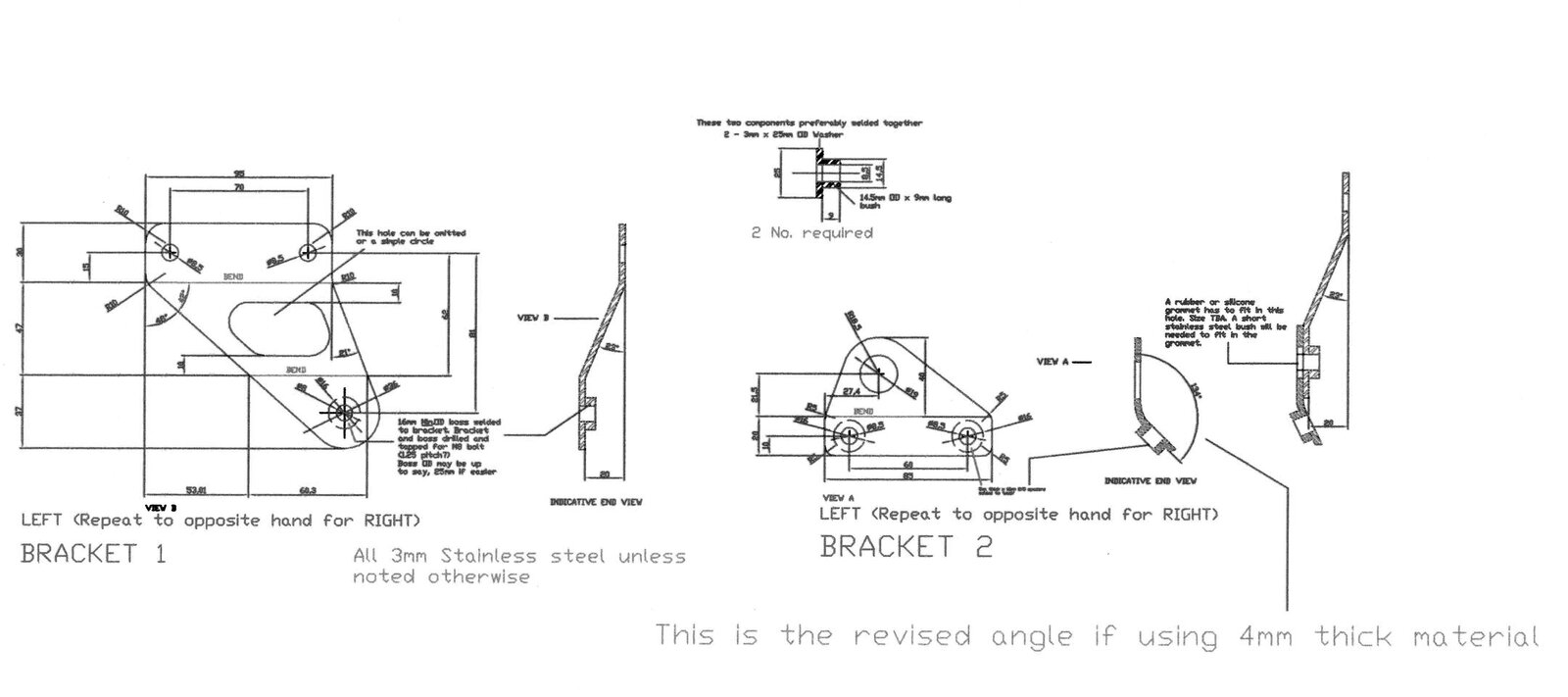

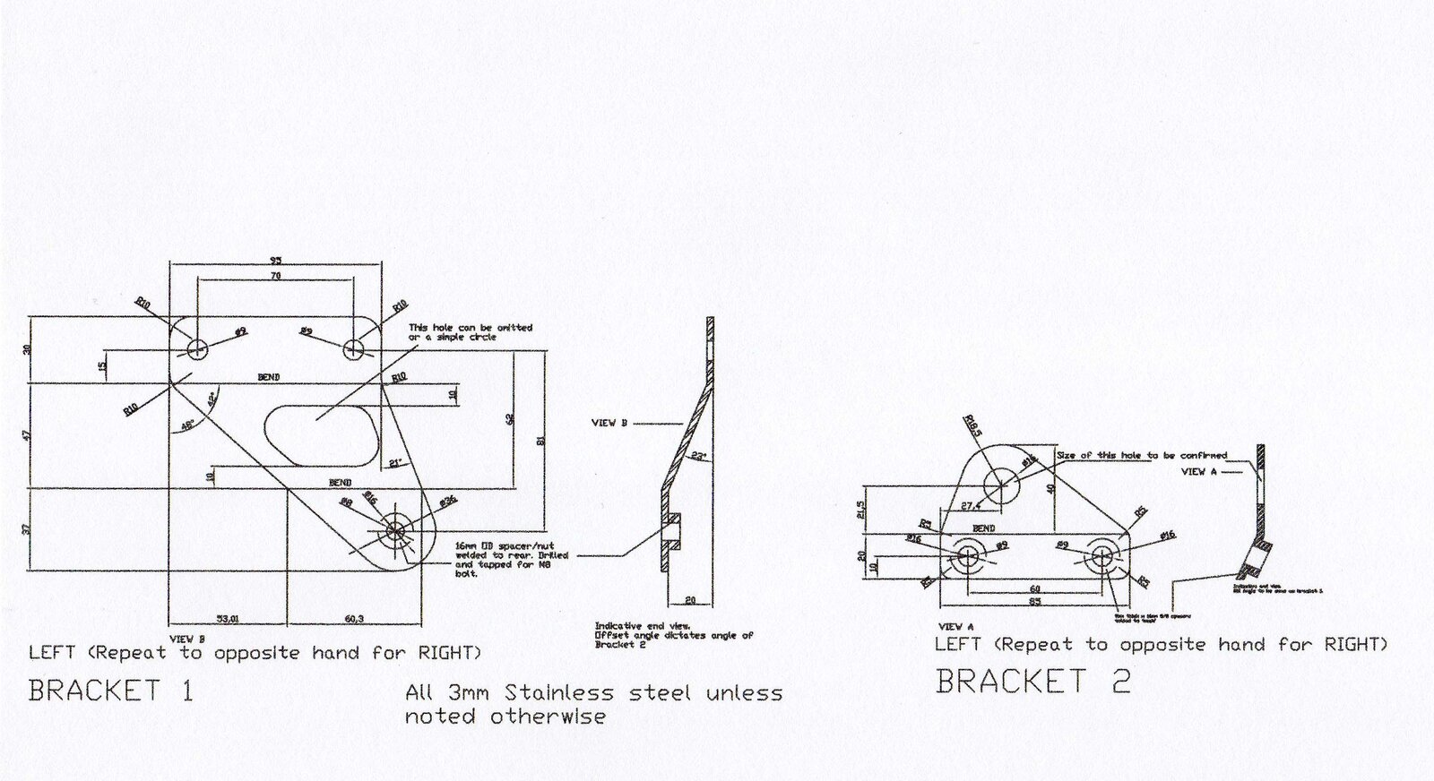

  15. This is the final version of the ones I made to fit high level Lazer cans with fixed link pipes.....I used 4mm stainless steel.
  16. So true lol :upyeah:
  17. Hey Arquebus, that is priceless, thanks for throwing that up.
    I had a few other measurement questions knocking about my head and this answers them all :beer::upyeah:
  18. Note they were specific for my 750, but the frames as far as I am aware were identical.......If I were you; I would copy the relevant parts of my drawing onto thick cardboard for templates that you can lightly bolt in place and test against your cans.
  19. Cheers Arquebus, that is exactly what I will do :upyeah:

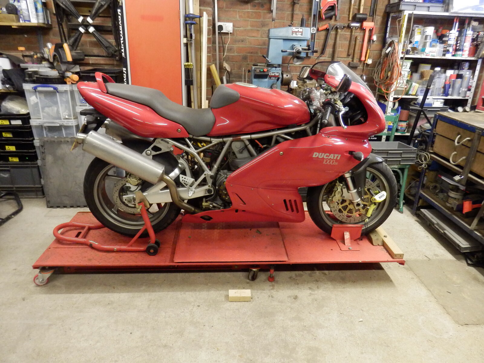

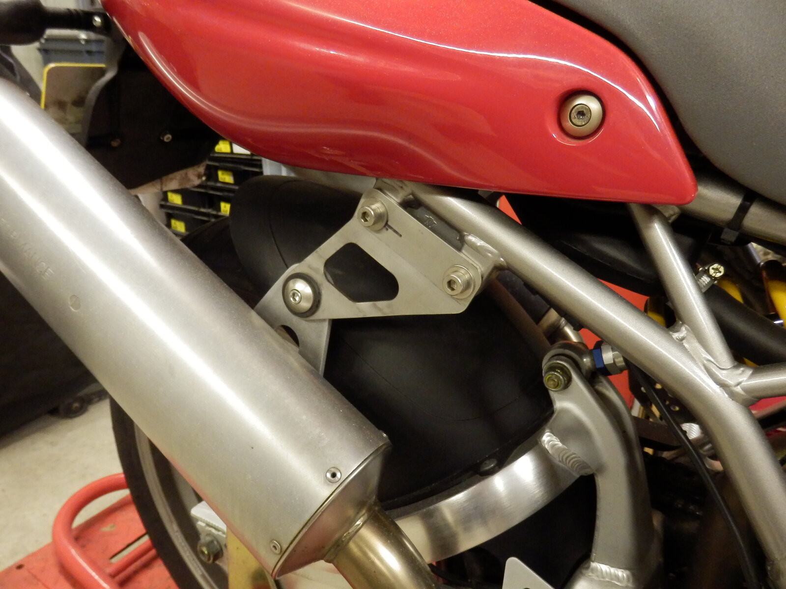

  20. I have recently fitted a pair of DP Remus cans to my 1000SSie DS.
    The Cans were on a 900SSie, and came with a pair of brackets like those in the first post.
    I saw an image of the 900ie with the cans and brackets fitted, but they would not go anywhere near my 1000SS. the mounting holes were about an inch out and the cans would only just touch the main part of the exhaust system.
    Wanting to introduce a rubber mount somewhere like standard systems, I used a pair of Aftermarket Stainless 900SL brackets I had and made up some simple triangular aluminium brackets to go on the cans. I had to flatten the SL brackets slightly to reduce their offset, but they look OK and just need cleaning up.
