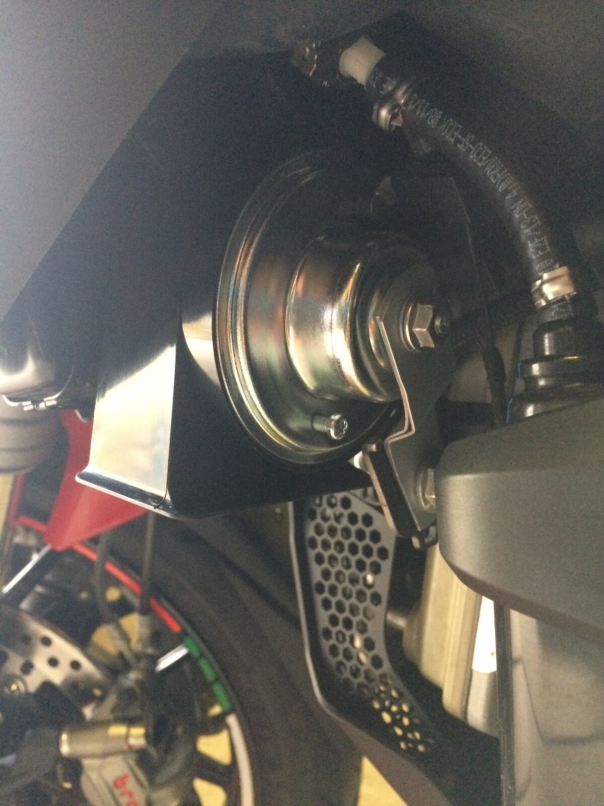

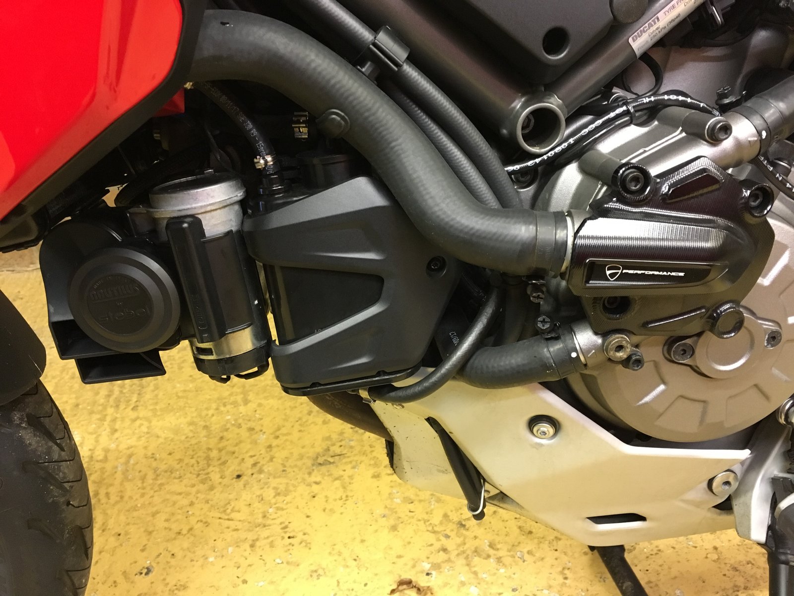

  3. Stebel Nautilus air horn mounted here, still going strong after 19K miles in all weathers, so it's certainly waterproof:

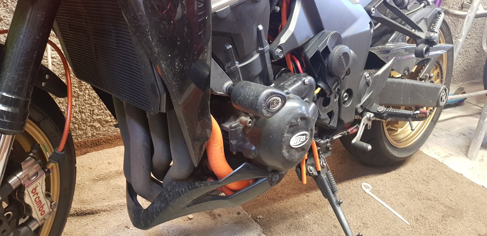

  9. Soundbomb here too on the zed and on the hyper....on the zed hidden in plain sight on the side, on the hyper where ive lost the airbox for k&N's theres room under the tank...ironically louder on the hyper as it resonates more under the tank in that space... 20190607_193700.jpg
    Just after the tt so apologies for the muck..

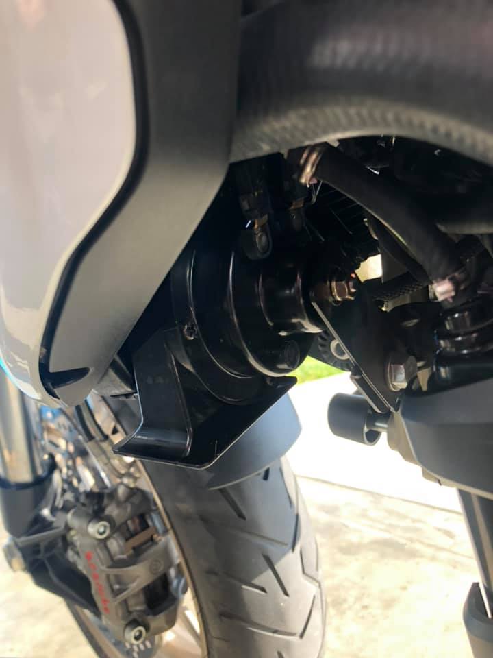

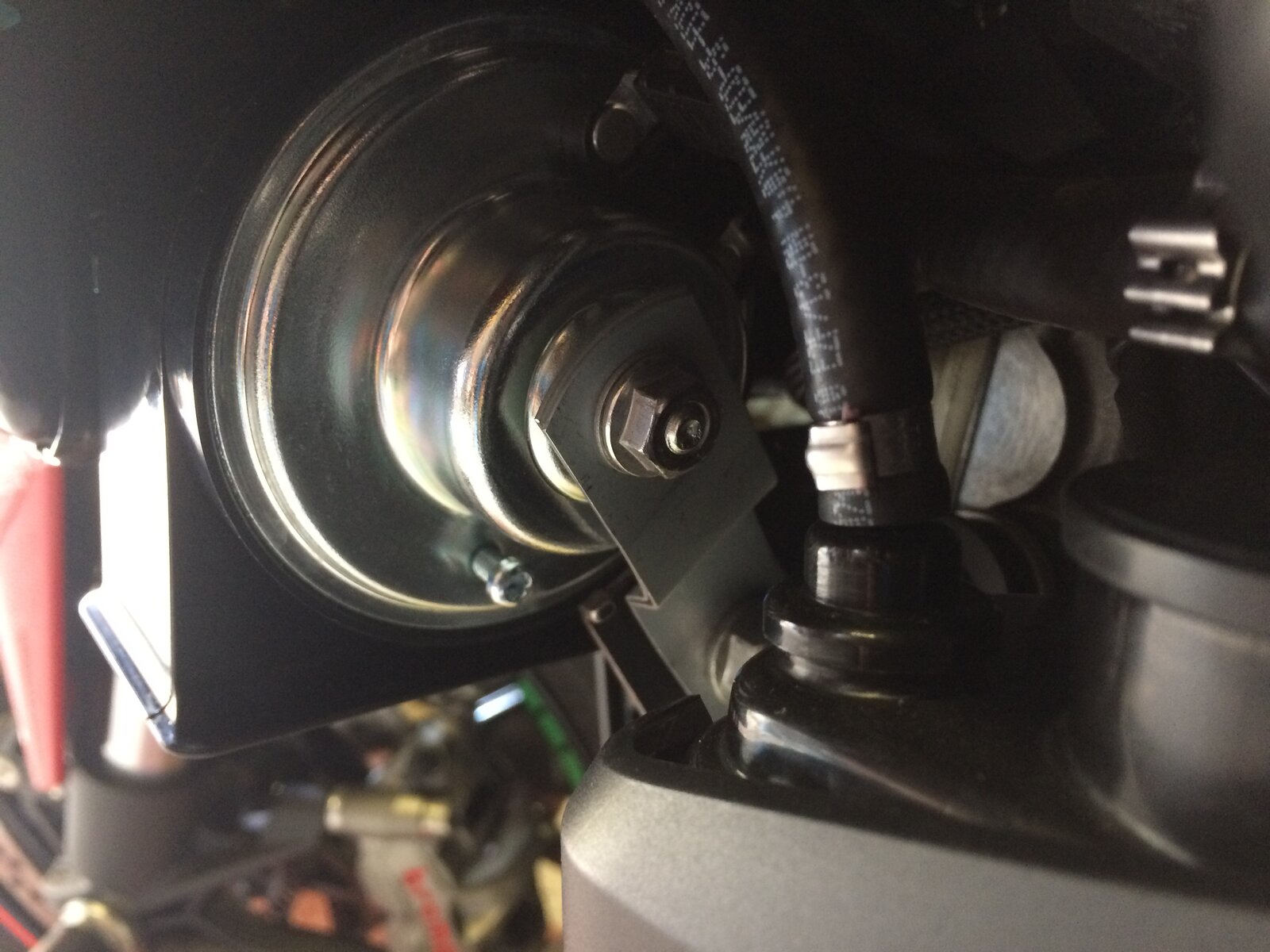

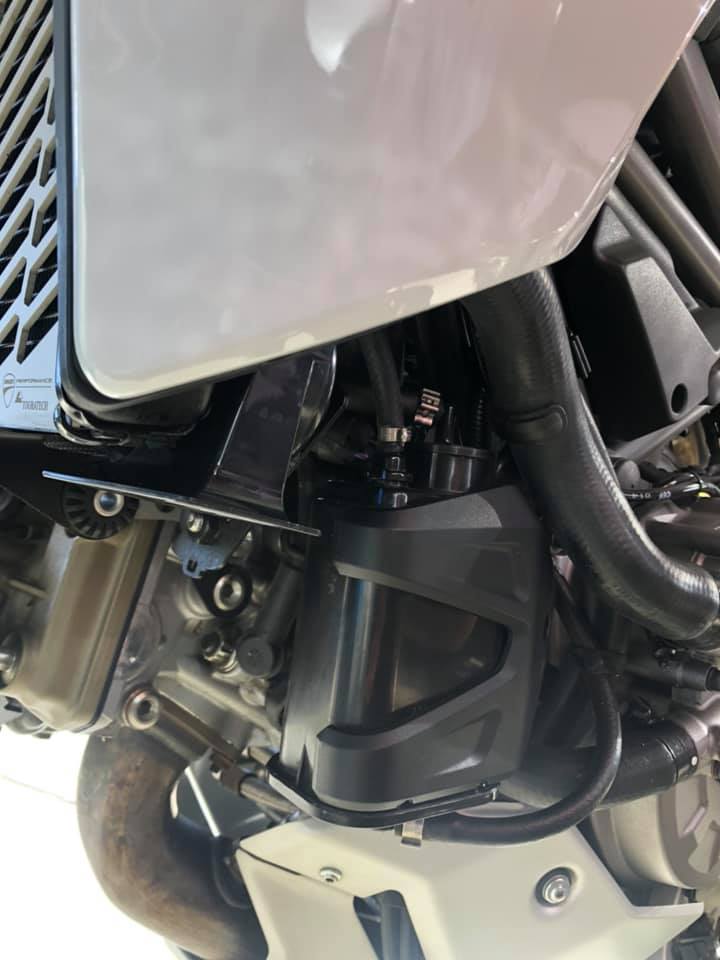

  12. 486EE727-BAA9-4FFC-ACD3-AC9712F68CC4.jpeg 88121A62-4B9F-44BF-87B3-0B8C7CE7224D.jpeg 0875E478-20F7-4D02-B19B-77B99070EA88.jpeg
    Well the horn has arrived via Sportsbikeshop, dealt with as brilliantly as ever, so thanks SBS
    It’s now fitted and even though it is pretty small, it is definitely louder than the standard unit.
    It also went in reasonably well, with a bit of minor adjustment to the Denali supplied brackets. Absolutely no issue with using the OEM wiring and the horn worked straight away.
    A couple of photos attached for reference.
    Thanks for this suggestion. Looks like a good option to have selected.
    TonyMN

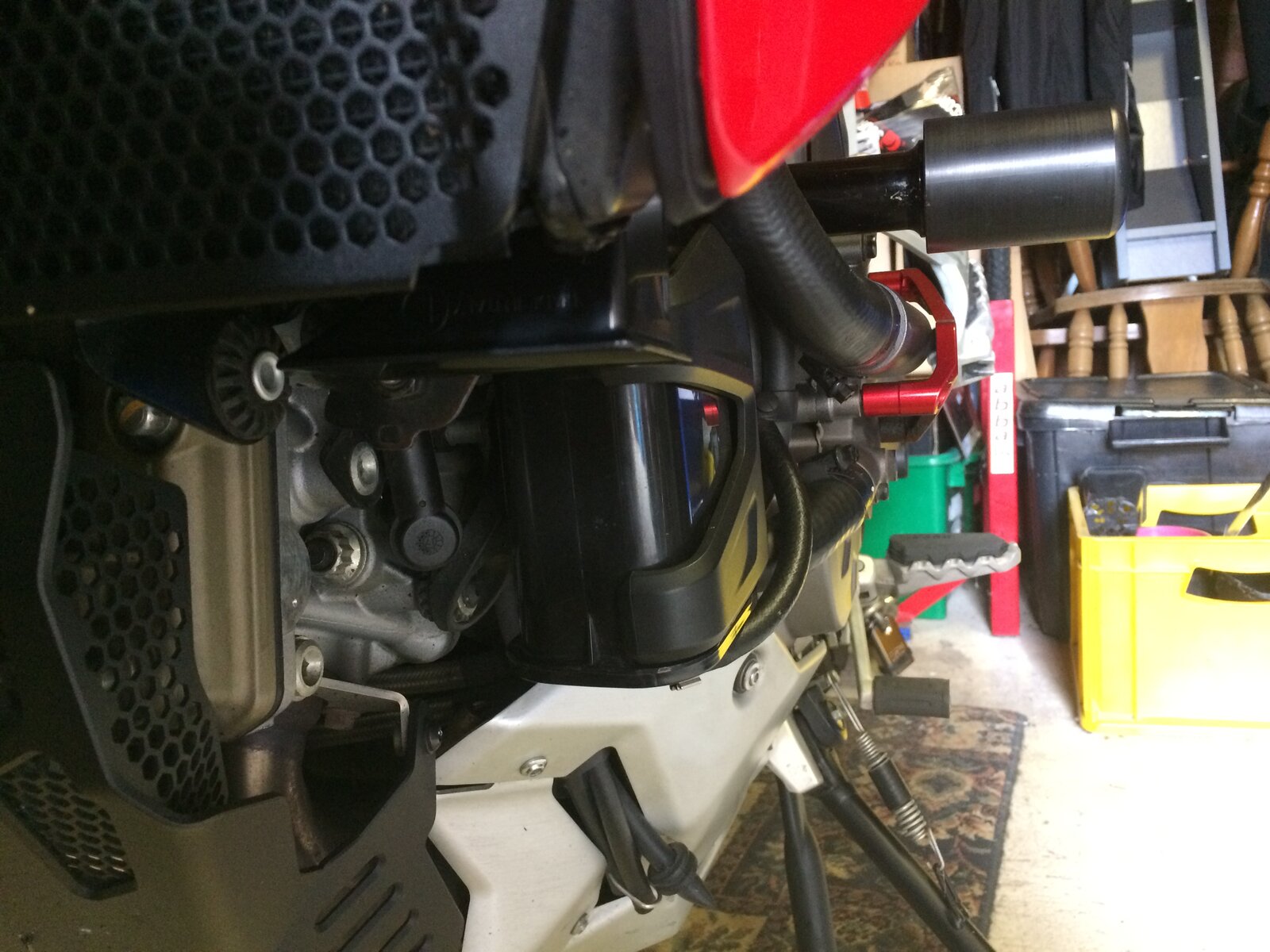

  13. Just did the same with a Denali Mini SB, a little bracket bending but fitted pretty easily and MUCH louder than the OE pip squeak horn.

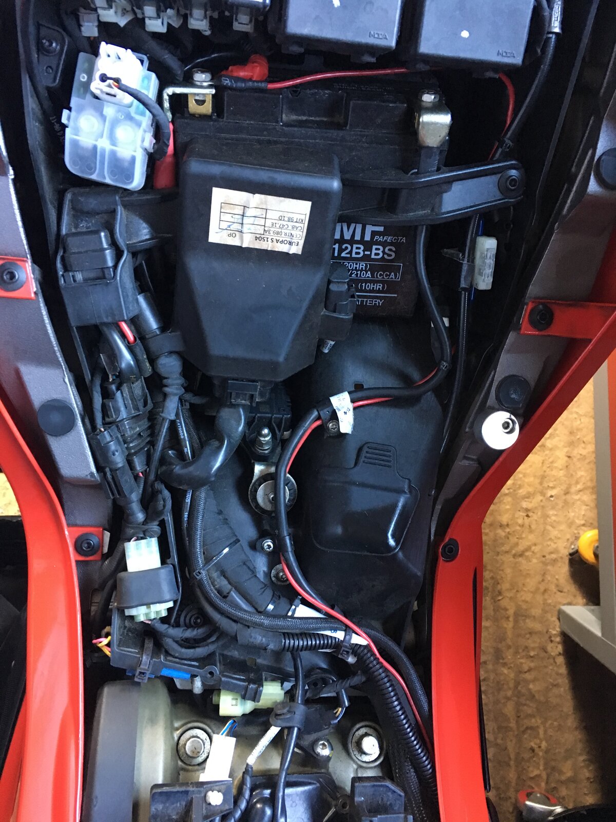

  15. I just got a 2018 multi enduro pro and the horn is downright anemic sounding so I want to replace with a Stebel Nautilus as it's the same horn I had on my GS. Was this a straight swap or necessary to run relay and 12V for this one? thanks
  16. You definitely need to use the relay supplied with the Nautilus, there is space for it just above the horn. The wiring & fuse threads quite neatly alongside existing cables & you'll also need to remove the left-hand fairing panel. Worth the effort as it's very loud! IMG_2184.JPG
