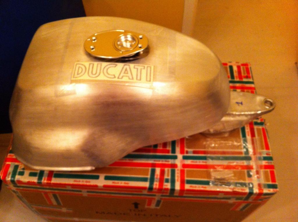

  1. Aluminium tank and seat arrived from Italy just before Xmas, need to decide on a paint scheme now which may take a while !
  2. Nice. Are these the same products being marketed in the US via the Ducati.ms site?
  3. Yup, one and the same. Ordered them in the group buy Motowheels had going.
    Quality is really good and I also got the quick release fuel cap (on top of the tank in the photo) which is also a mini work of art !
  4. Leave them bare!
  5. They look brilliant bare, I seen a bare one on a 1198 at a showroom this weekend, looked fantastic

  6. I know this was some time ago now, but where did you get this tank from?
  7. I was the same so decided it was a good way to go, with hindsight I probably wouldn't bother - just wait and see if it's an issue first and take action if and when it happens.
    I had the whole lot anodised as well just to make sure it didn't go furry on the inside, what a PITA that was !
  8. Did you leave them bare on the outside or paint them ?
  9. Wow, you didn't mess around did you. If you fancy painting it yellow, i can test it out for a few years if you want!

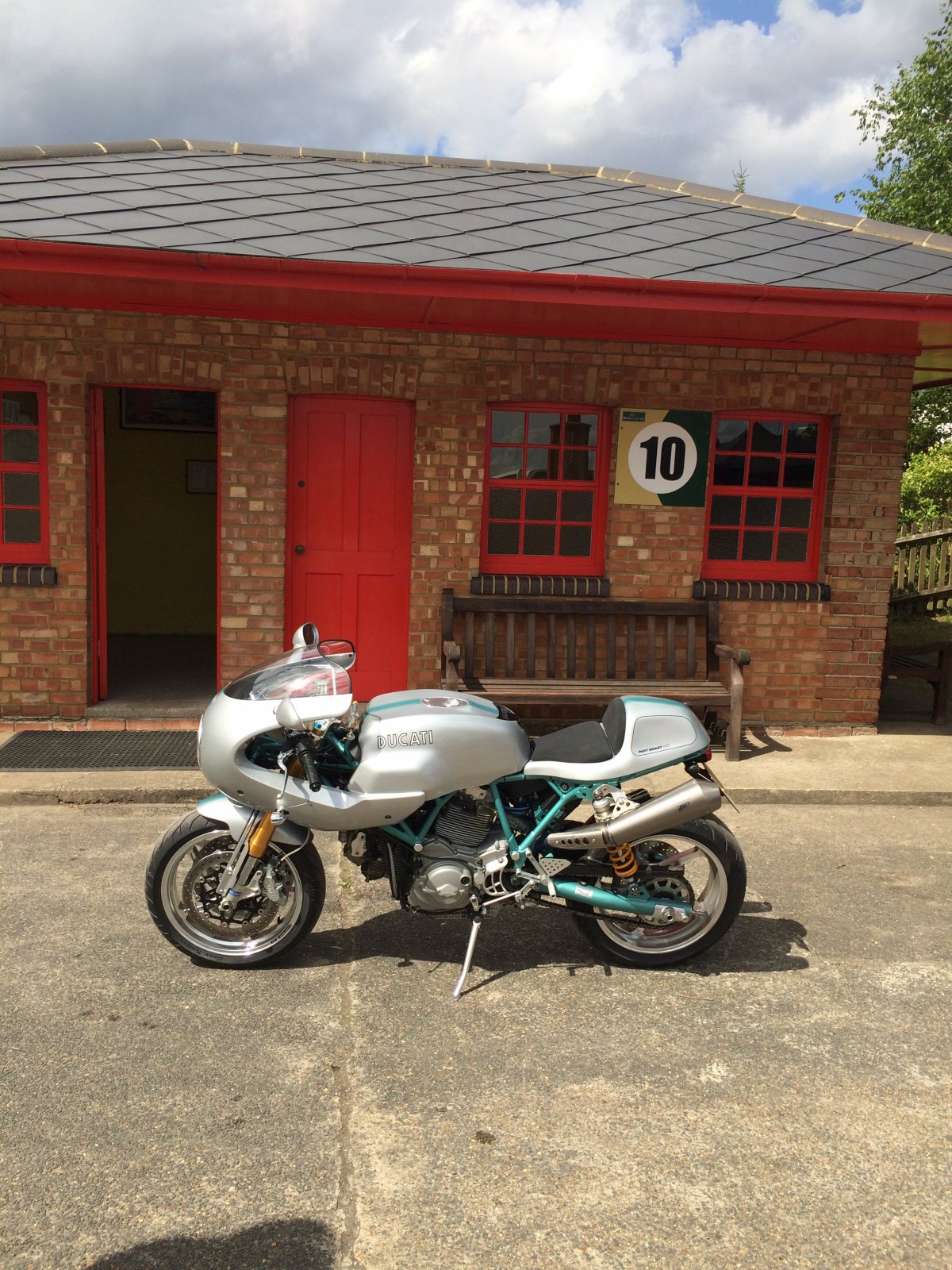

  10. Well... the idea was to have a set of brushed stripes running along the length of the tank and over the tail hump, the logo's on the side would also have a horizontal brushed finish inside the lettering (where it's normally white) so I had the areas of the tank brushed in preparation. The idea was then to have the rest of the tank painted in the normal metallic silver and then laquered, it would have looked quite subtle but was intended to have the origins shine through in a few areas.
    The best laid plans, etc... when it went off for painting there was a bit of confusion and it came back with a paint "brushed" finish over the whole tank. It kind of looked like hammerite applied with a brush if ya know what I mean.
    By then I was so fedup with waiting to get it together, I just had the whole thing re-painted as original but with a set of stripes along the tank/seat in green that matches the frame. Sounds horrid I know, but actually works really well in the flesh. You can sort of see the stripes in the pic below...
  11. Matt what the hell were you thinking , you have completely failed in that there is no bin in your photo , great job on the bike though.
  12. Yeah, i approve.
    I will get some pics of mine up soon. I just need to make sure i have no bins in the background!
  13. Must try harder on the bin front in future photos, although to be fair they were fairly hard to find at Brooklands and the buggers seem to have fixed them down to stop Ducatisti moving them for photo ops :laughing:
