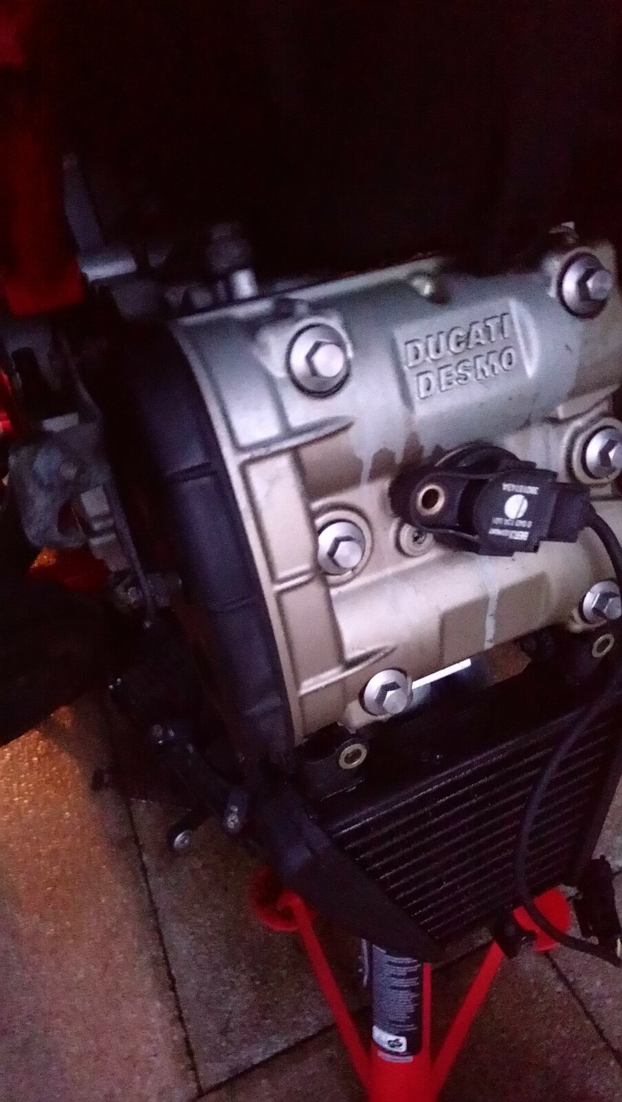

  1. So i bought some magnesium painted rocker covers from ebay, i fitted them then set about degreasing the front of the frame with mucc off bike degreaser, some dripped down but immediately took the finish off the horizontal cover, im not happy as the rocker covers can get mucky and would need cleaning themselves and i looks like it has just had one coat with no top coat(i would expect this due to the price)
    this is the answer i got back from them.
    "I looked up that cleaner you used and read that it can be harsh on paint surfaces. You can send it back and we can repaint it. Let me know if that's what you would like to do."

  3. Muck off paint stripper by the looks of it, not recommended anywhere :eyes:

  7. Replacement paint is likely to do the same again next time, so isn’t really a solution.
    You could pay to have them ceramic coated. That should save future problems.

    degreaser in question https://shop.wheelsmotorcycles.co.u...MI9Jmzj7un4QIVAojVCh3KuAElEAQYByABEgLTfPD_BwE
    I have never had it damage any paint finish on any of my bikes even my look carbon road bike,
    as you can see from the pic you can see that just a running drip Stripped it.

  10. Got to be honest, I'd expect them to duck this unless they've a reputation to uphold. What I know about coatings manufacturers, they'll turn it on the customer and you'd have to prove it was the cleaner and not brake fluid or something else that was corrosive. All they would do remedially is do a sample in their lab, with your cleaner, try to replicate it and then tell you you should have tested an inconspicuous area before use. Unless your painter wants to help you out of course and keep his reputation.

  12. muck off made an awful mess of the mag head covers & engine casings on my first 1200 Multi. The stuff is used for wheels and thats about it for me on the bike or car. Caustic stuff, akin to that prewash acid the Poles stick on at car washes
  13. They have almost certainly cleaned them and given them a flash over with air dry paint prior to sale. OEM coating would have been more durable than this.

    There's a good chance that the paint wouldn't have been laquered over. If that's the case, then it doesn't matter how high quality it is. It's coming off under the power of a degreaser.
    Find a decent anodiser/ powder coater and see if he can colour match. That's what I'd be looking to do.
