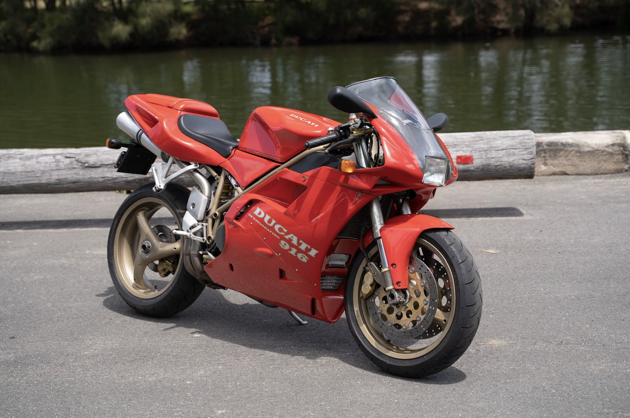

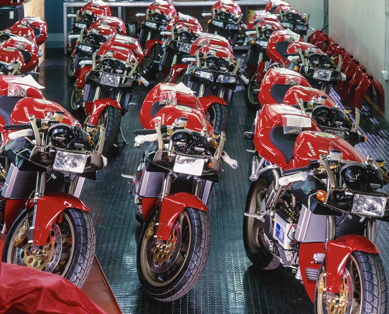

  2. Interesting article and photo. I think the rectangular headlight 916’s are for the Australian market? Some issue with homologation of the classic twin headlight design I believe. Ruins the line of the front.
    • Agree Agree x 4
  3. Agreed with the above post, They look dreadful with those square headlights as opposed to that very sexy twin setup that we all know and love.

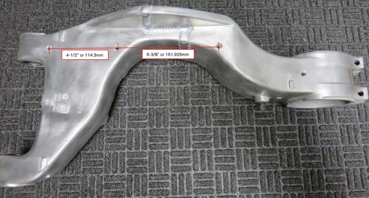

  6. I suppose prices for used swingarms are going up after reading this..
    “During the whole life of the 916 we kept the swingarm quite short, but we never had a short swingarm on a race 916. It just didn’t work; I remember Tamburini going up to Mugello when they tested the 916 for the first time, and it just didn’t handle. So they took two swingarms and chopped them up to lengthen the wheelbase by 18mm or 20mm to put more weight on the front, and then it started handling. But in fantastic Italian fashion they never actually updated the roadbikes – they had that flaw all the way through."
  7. I was wondering how many people would click the link and read the full article!
    There’s a lot of little gems of info in there!
    You can still buy a Superbike extended swing-arm £719.99
    https://www.moto46.co.uk/product/ducati-superbike-swing-arm/
