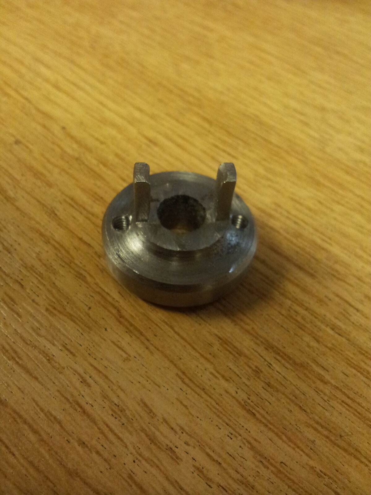

  12. The pins of the turning tool shear off if the plugs are left in.
  13. Ok so defo will remove the spark plugs lol ... Thanks Exige but I think I'll get both sets of exact fit belts :D
  14. One I had to remake..
