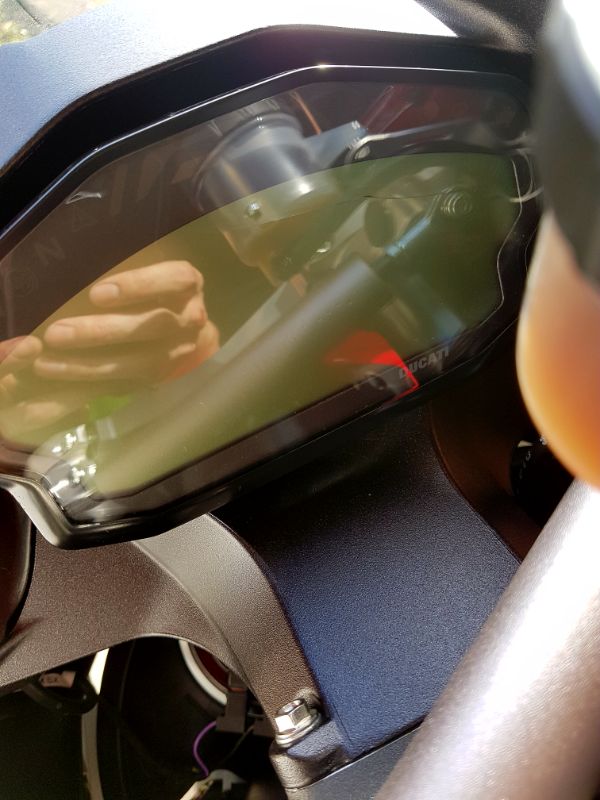

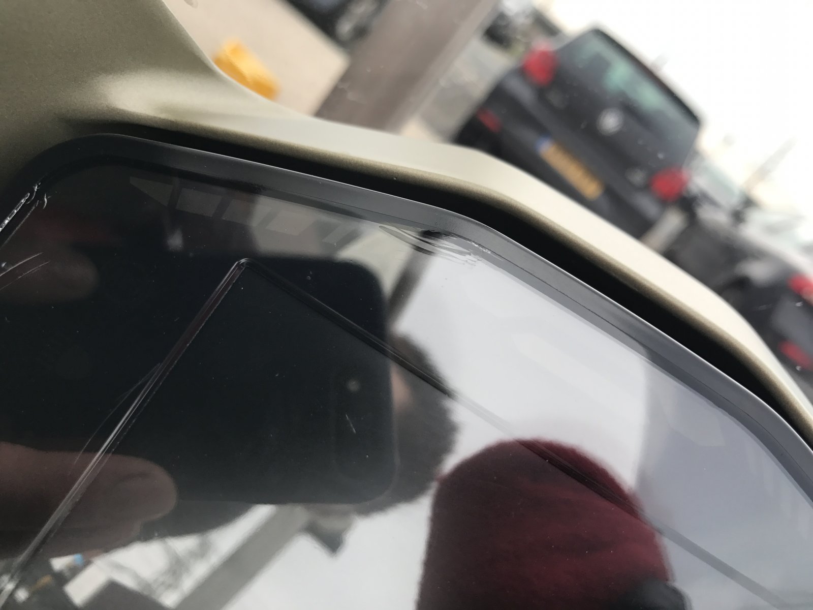

  17. Well ducati have accepted my claim and sending a dash for 10 days time. As you can see mine wmis quite a big crack.
